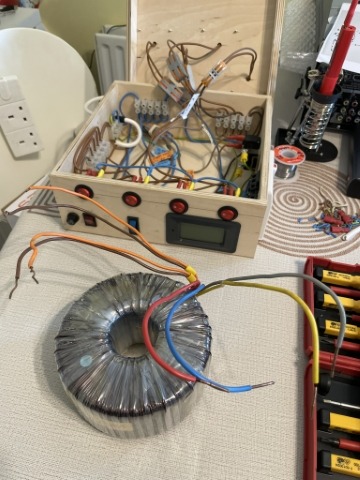

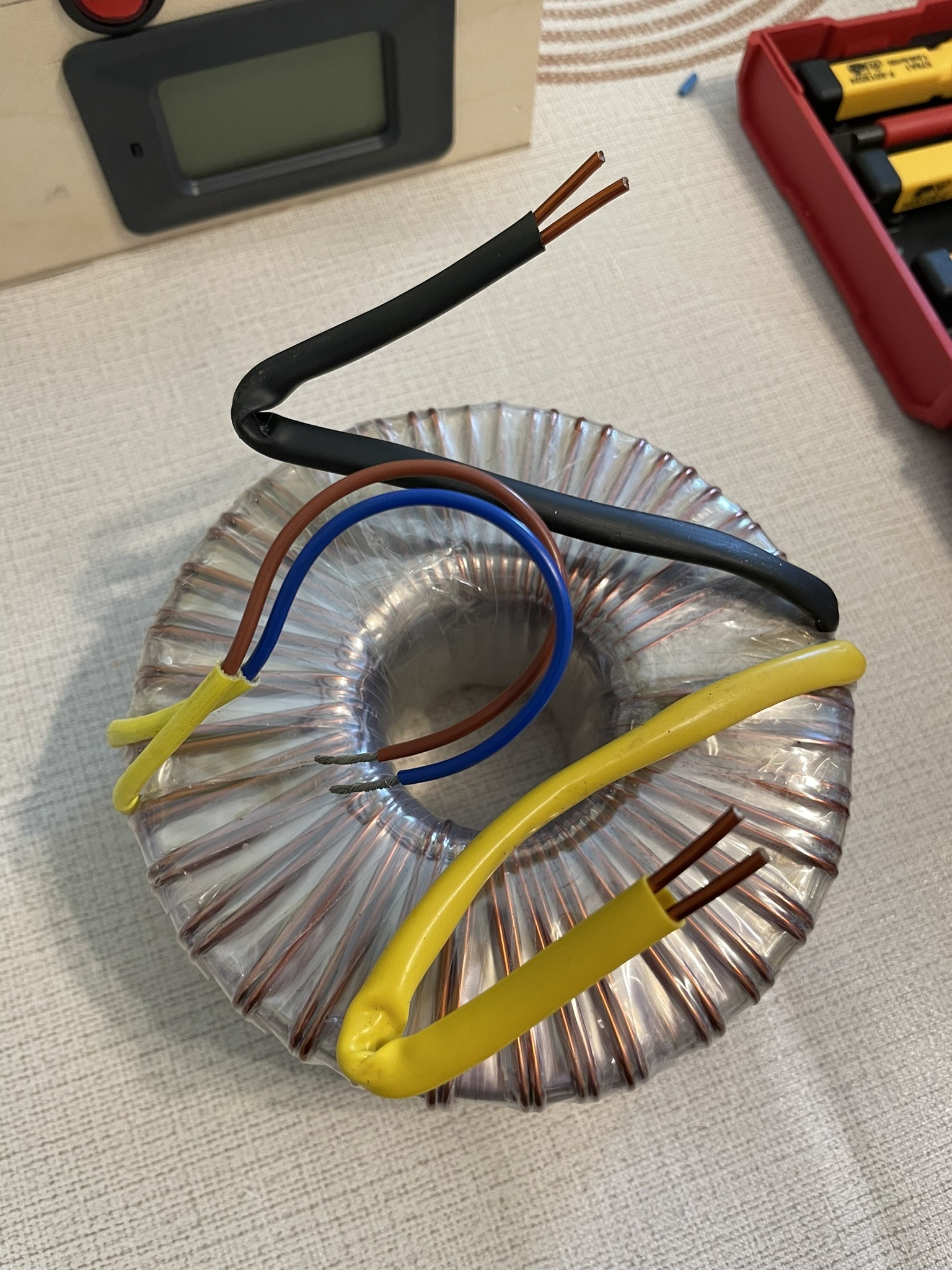

Basically, I've built myself a 'Dim Lamp Isolating box' for testing vintage devices and other power supplies (without blowing them up , or myself) and I need a 240v in , 240v out toroidal (isolation) transformer to drop into the middle of it (see image of my freshly made scary looking death box below).
Problem is, none of the transformers came with wiring diagrams and there are LOTS of pretty coloured wires sticking out, and I have no clue what they all do, as I have never even seen one before now. But, I'm hoping someone here does....
Dim Lamp Isolator (aka, The Box of Death)
(has 4 switchable test lamps, LED display, fuse, added trip switch, socket, and TEST/LIVE 'bypass' switch)
The last piece of the build-puzzle is the 'Isolation transformer', so I bought 3 x different cheap eBay toroidal transformers in the hope that at least one has the requirements for what I need. (i.e. basically only need, 240v AC in and 240V AC out). But the problem is, I think these transformers are so old there are no schematics in Google to be found.
These are the toroidal transformers in question:

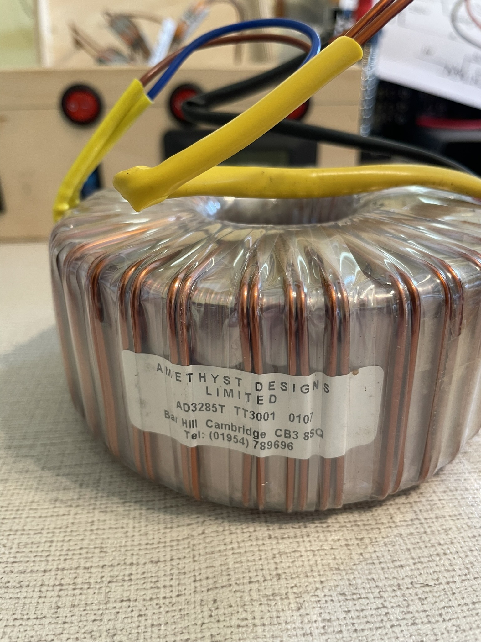

1. AMETHYST DESIGNS LIMITED - AD3285T TT3001 0107 (info from seller was; "300va transformer 3.5kgs and 120mm diameter, 230 v primary, 12v secondary" , but I have no clue about the wiring. I'm not understanding how the Black + Yellow wires grouped in pairs can provide 240v and 12v...? (I'm assuming Brown + Blue are for the 240v input supply?

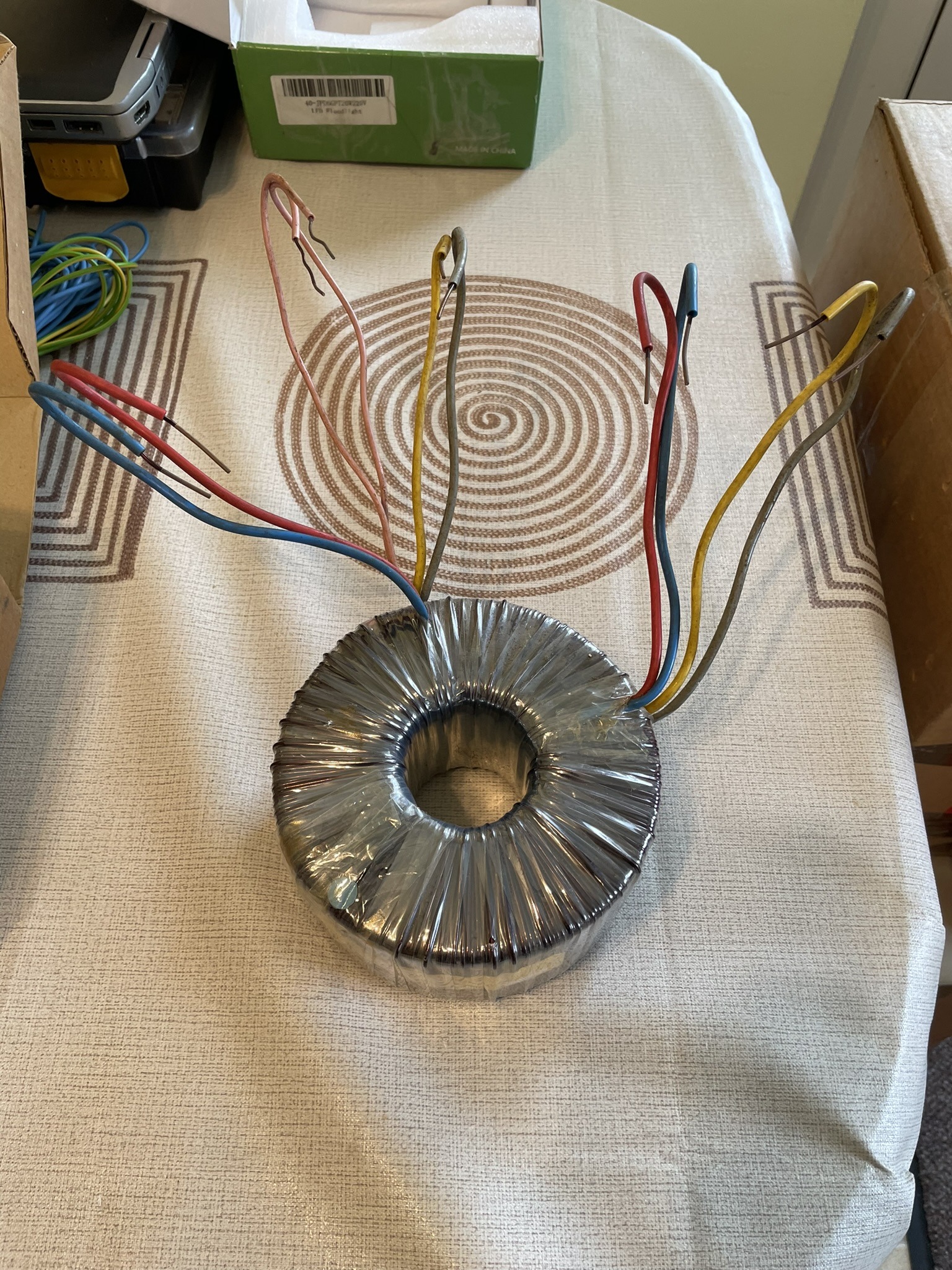

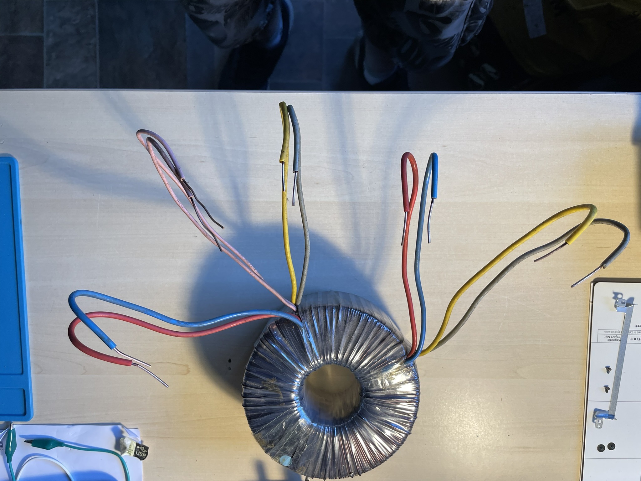

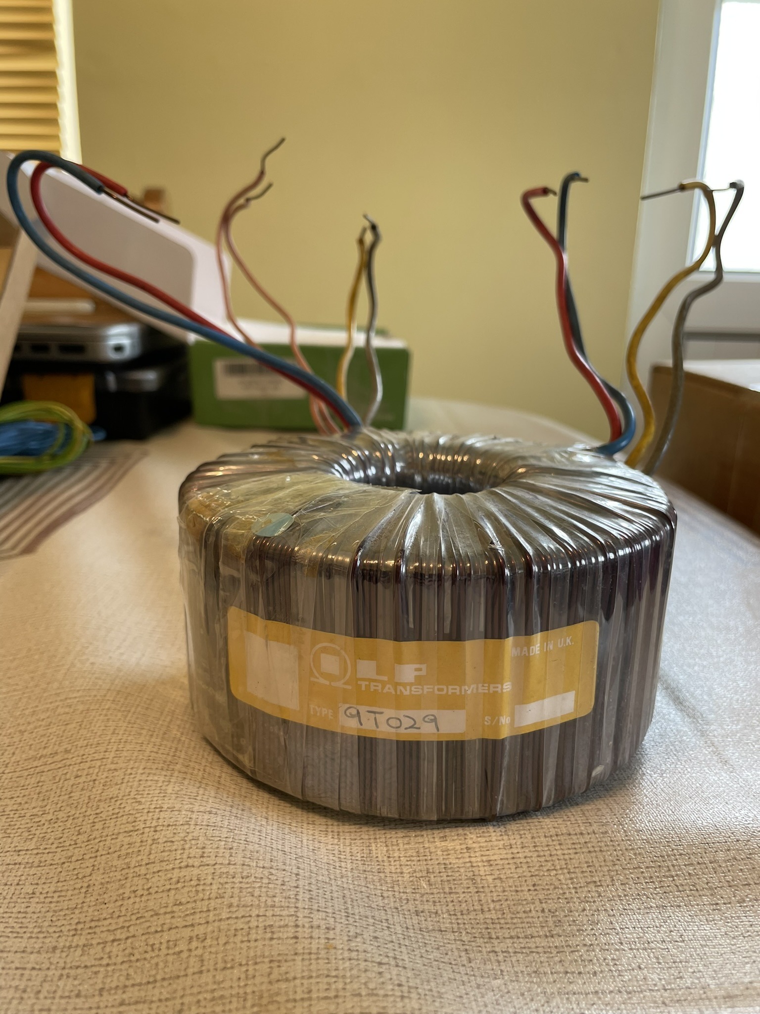

2. ILP TRANSFORMERS - 9T029 (that's all i have...?) From online research, I "think" this model (with having a "9" prefix) could be a 625VA , but no clue on wires V outputs?
(5 x pairs of wires) - Has, 2 x pairs of Red + Blue, then 2 x Pink, then 2 x pairs of Grey + Yellow paired)

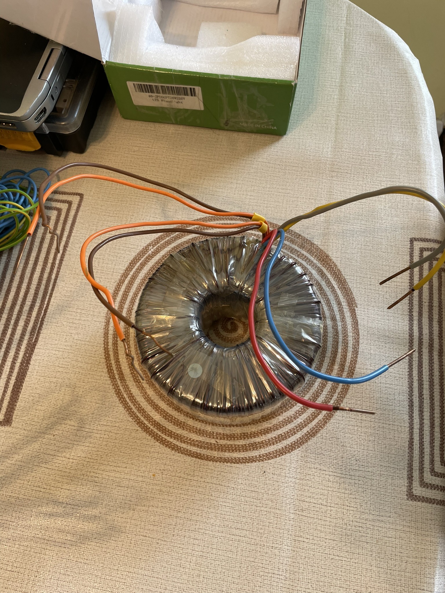

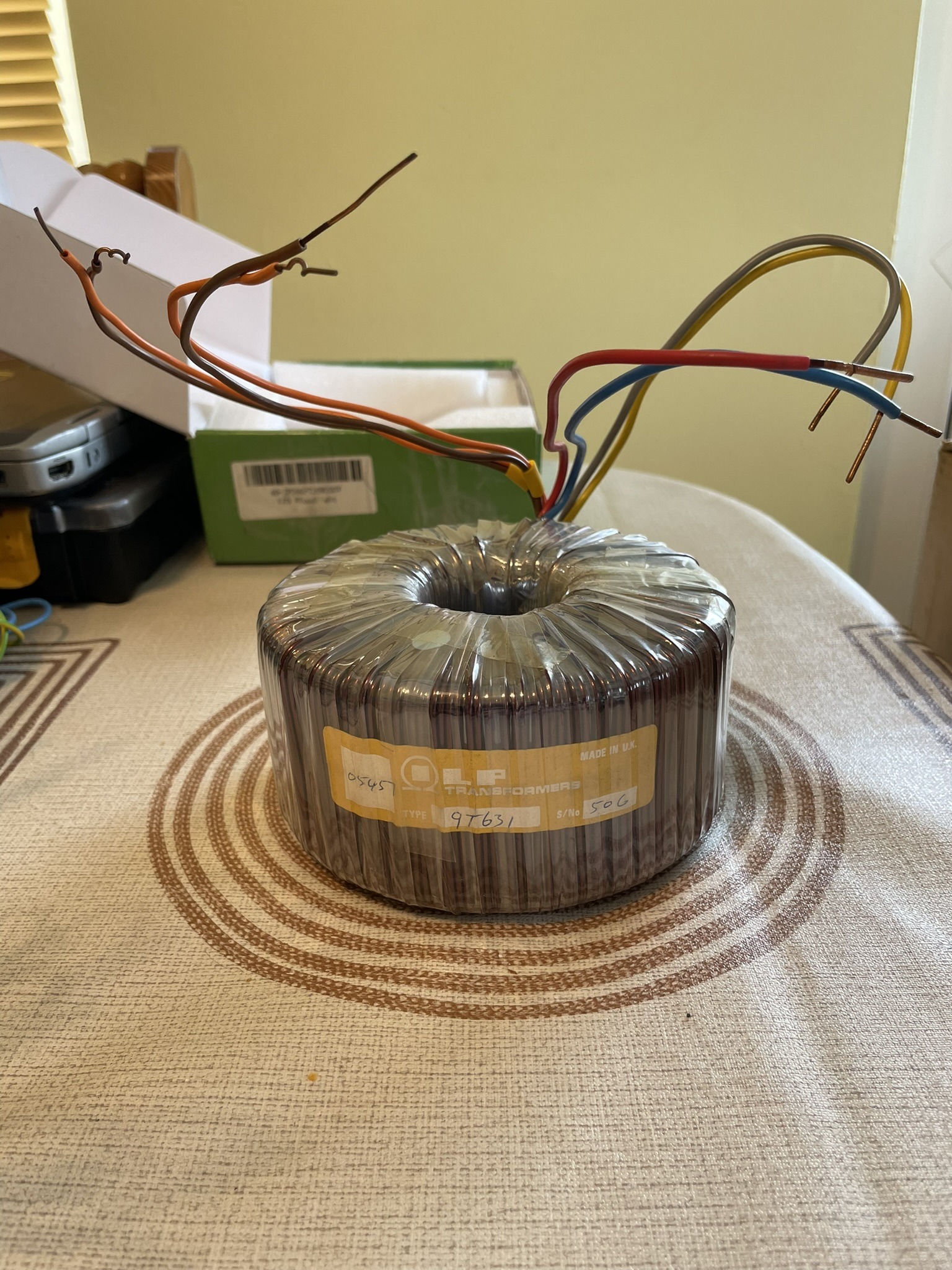

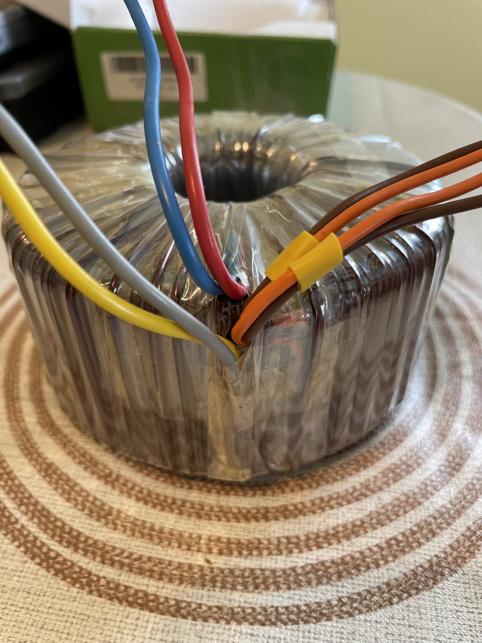

3. ILP TRANSFORMERS - 9T631 0545 s/n506. Again, from online research, I "think" this model (with having a "9" prefix) could also be a 625VA , but no clue on wires V outputs?
(4 x pairs of wires) - Orange and Brown seem to be 'sleeved together' on each pair, then Red + Blue paired, and Grey + Yellow paired)
Hoping someone with prior knowledge can assist with, 1. How to test before using any of them, and 2. Wiring colours input/output voltages, for each transformer...?

Welcome to the forum!🤝
Be very careful to working with mains voltage!
It looks like none of the transformers you have are isolation transformers!
My suggestion is to go ahead and complete your dim bulb tester without the isolation transformer, you can always install it later. The DBT can be used to test these transformers.
Now you can connect the transformer to the Dim Bulb Tester with a 40 Watt or lower Incandescent bulb, measure the secondary winding output voltage and compare the primary winding input voltage (it should be on your DBT's LED display), the ratio will tell you the actual output voltage if connect directly to 240V mains.

I'd be wary of using transformers that you don't know the specifications of. Both voltage and power ratings vary widely. And on that note, just to put another worry to bed, are you actually 'sure' these are isolation transformers? Just that on my small phone screen at least some look like they could be step-down transformers.
But anyway, a basic isolation transformer has two wires in and two out, of the same diameter. Some may have a third wire in for an earth shield. Unfortunately in reality many are made to offer multi-voltage in and/or out options, so these can have their primary and/or secondary windings tapped in multiple places (so multiple wires). Some may even have more than one secondary winding.
You can build a map of the primary and secondary winding(s) based on what wire is connected to what and then the relative impedence or resistance between them. If you are competent to do so safely, and can identify at least the primary windings you could potentially connect to a supply and measure secondary voltages. Current capability and/or duty rating would be a guess based on overall size and conductor area.

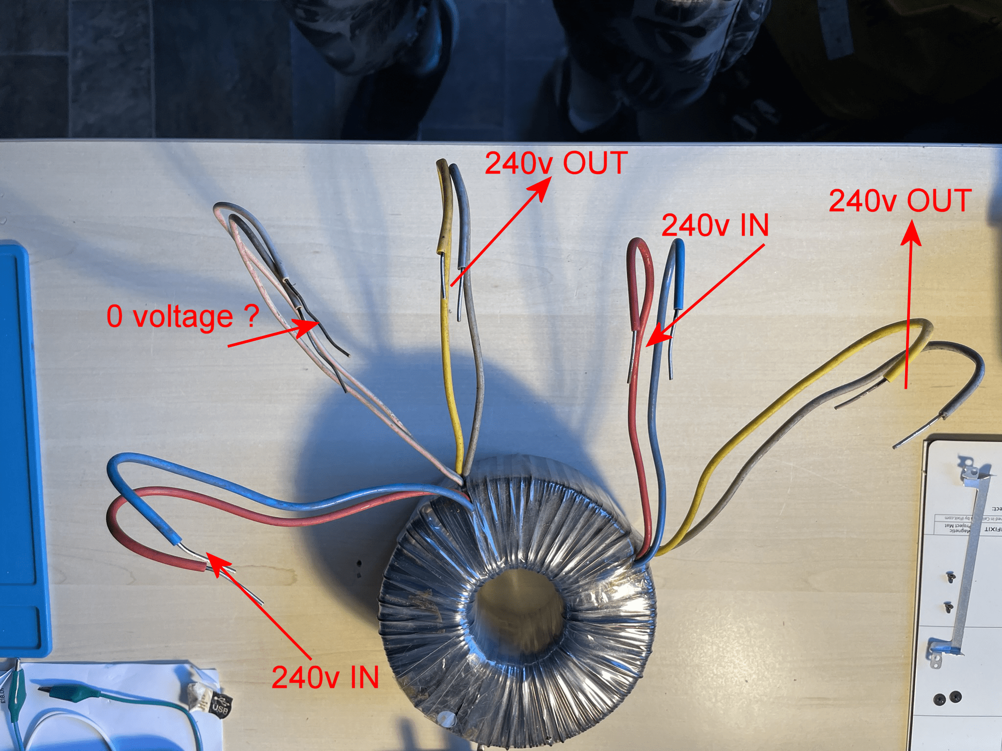

im getting even more confused watching videos lol.... for example with my AMETHYST DESIGNS LIMITED - AD3285T shown above.
Is it not as described when I bought it ? 240v out and 12v out ? and is it in fact just 240v in, and 2 x 12v out (since there are 4 wires output ?)
This is what's confusing as I have been basing my understanding of the wires visible, on the sellers description...

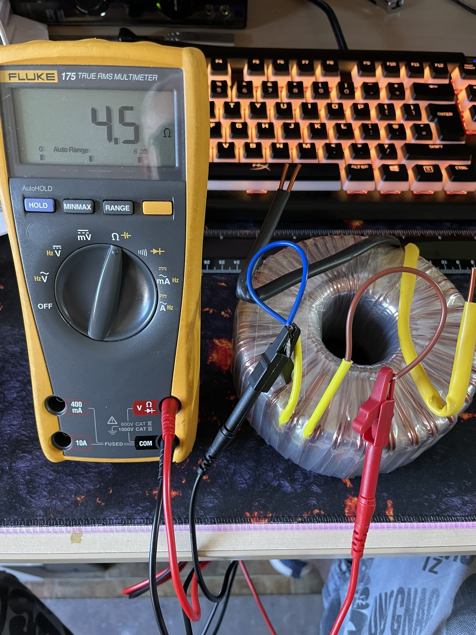

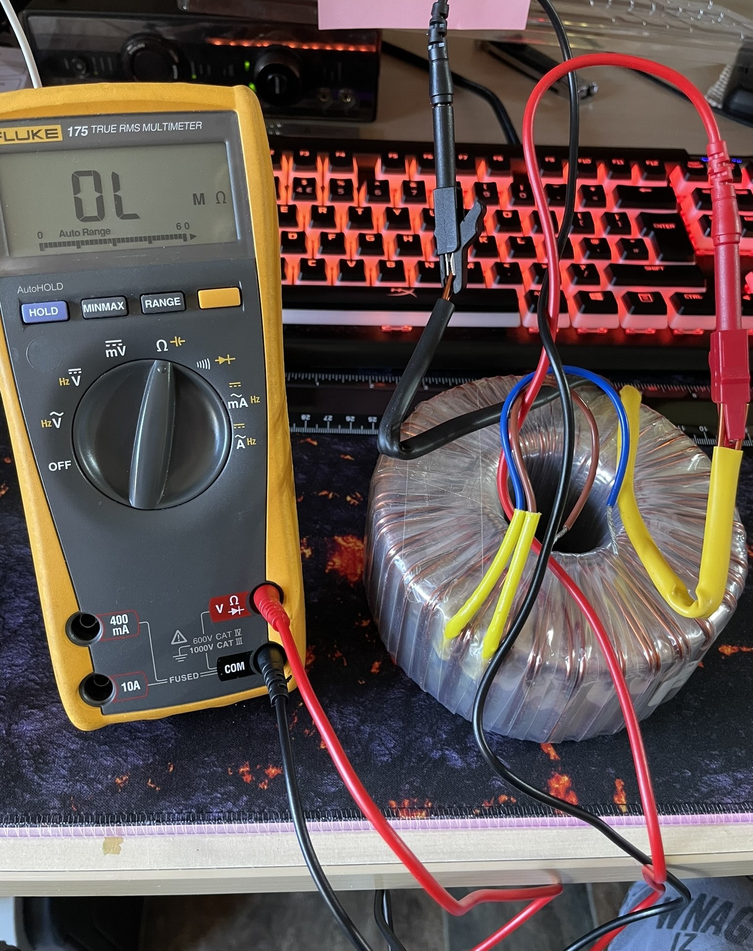

ok, for the AMETHYST DESIGNS LIMITED - AD3285T
DMM readings in Ω setting are;
BLUE + BROWN - 4.5Ω
BLACK + YELLOW - OL (zilch?)
same result with DMM set on
Is transformer faulty with no reading on black and yellow ? or maybe internal fuse blown ? (if it even has one?)
BLUE + BROWN - 4.5Ω
Doesn't look good, if 'OL' means very high resistance.
But also 'surely' those black and yellow conductors are much bigger than the input brown & blue ones? The secondary winding on the toroid look chunky, too. If so, that indicates a higher current capacity on the secondary winding, and therefore also a lower voltage - i.e. it would be a step-down transformer. Step-down transformers are the most common type and (just in case you don't realise) these don't offer mains voltage output.
TBH I'm quite concerned that you don't yet understand the basics, which is potentially very dangerous when working with high voltages. Learning is no bad thing, but take great care of your safety as you go.
transformer was sold to me as a, "300va transformer, 3.5kgs and 120mm diameter, 230v primary, 12v secondary"....
The black and yellow insulated wires are 'solid copper' , and much thicker than the Brown and Blue wires. They are not further insulated inside the yellow or black insulation.
So... its looking like this one is no use as its probably just 12v ac out, correct ?

From the image, I suspect these wires are enameled wires, please clean off part of them with a knife or sandpaper and then measure again. I guess the two wires in the black and yellow tubing are two separate pairs of secondary windings (12V+12V?).The black and yellow insulated wires are 'solid copper' , and much thicker than the Brown and Blue wires. They are not further insulated inside the yellow or black insulation.

ok, so here are the remaining 2 x transformers Ω readings
iLP TRANSFORMER - 9T029
RED + BLUE - OL (on both pairs)
GREY + YELLOW - OL (on both pairs)
PINK - 1.8Ω
iLP TRANSFORMER - 9T631
RED + BLUE - OL
GREY + YELLOW - OL
BROWN + ORANGE - 1Ω (on both pairs)
Are these then safe to connect to mains to measure output voltages ?
Do i need to join any 9T029 wires together ? (shown below) i.e. Blue + Blue, Brown +Brown , to mains N+L?

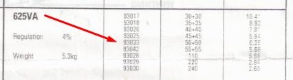

If I am understanding you correctly - none of those will work as isolation transformer for your dim bulb/isolator.
For an isolation transformer, you need two sets of windings - one pair of wires for 240V input, and another pair for 240V output. Those ones you have are 12V output.
I might also add that you really need to know what you are doing when using an isolation transformer - for example if you have your device under test powered through it, (with no earth connection) and you then connect test equipment that is earthed (eg the ground probe of a scope) then you have lost the protection that the isolation gives you.
I'd also add that decent sized isolation transformers are hard enough to come by.
Your AMETHYST DESIGNS LIMITED - AD3285T - most likely you aren't getting a resistance reading on the secondary because those wires are enamelled. You need to scrape away the enamel on each end to reveal the shiny bare copper and then you will likely find a resistance. This transformer will only give you 12Vac output - not the 240Vac you are looking for.
Finally - this link might help you decipher the ILP transformer.
https://davidmager.co.uk/index_htm_files/ILP transformers 2 .jpg
woodturner-fran,
You (and others), were correct about the wire varnish. it was on that thick I hadn't scraped enough away to make contact. cheers.
That AD3285T transformer does now work, but has 12v output, so useless for my task.
You also kindly provided the same sheet I had originally used to "guess-timate" if the ILP transformers might work. I searched ebay for ones that where in the "9" prefix-code range (or 625VA range), thinking it might work, especially the 93029 one (having 220v on secondary)... I know Mine is marked 9T029 , I had hoped it would be close enough to work given that it had 'two sets' of Red and Blue wires. But am just not sure how to test it properly without damaging it (as it might be 110v input).
93029 has 220v on secondary
What is the safest way to connect the 9T029 up to the mains without damaging it ? (Sadly, I dont have a 110V source (or Variac), and i only have an RCD socket in place for everything I do).
Do i connect just one set of Red and Blue to the mains ? if yes, which set ?
cheers
I just tested it on the mains (240v). SO, if i connect either set of Red and Blue to the mains, i do get 240v on the Grey and Yellow wires from the same grouping of wires. No voltage on the PINK wires when either set of Red+Blue are connected to mains ?
what can be deduced from these findings ? thanks
i.e.
i.e.
