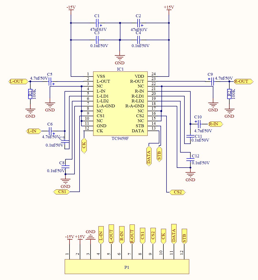

Two years ago, I have tried to use TOSHIBA TC9459 volume control IC, but failed.
Yesterday, after successfully codeing Muses72323, I tried rewriteing the code for TC9459, it successfully made the IC working.
This is the testing schematic
the datasheet of TC9459

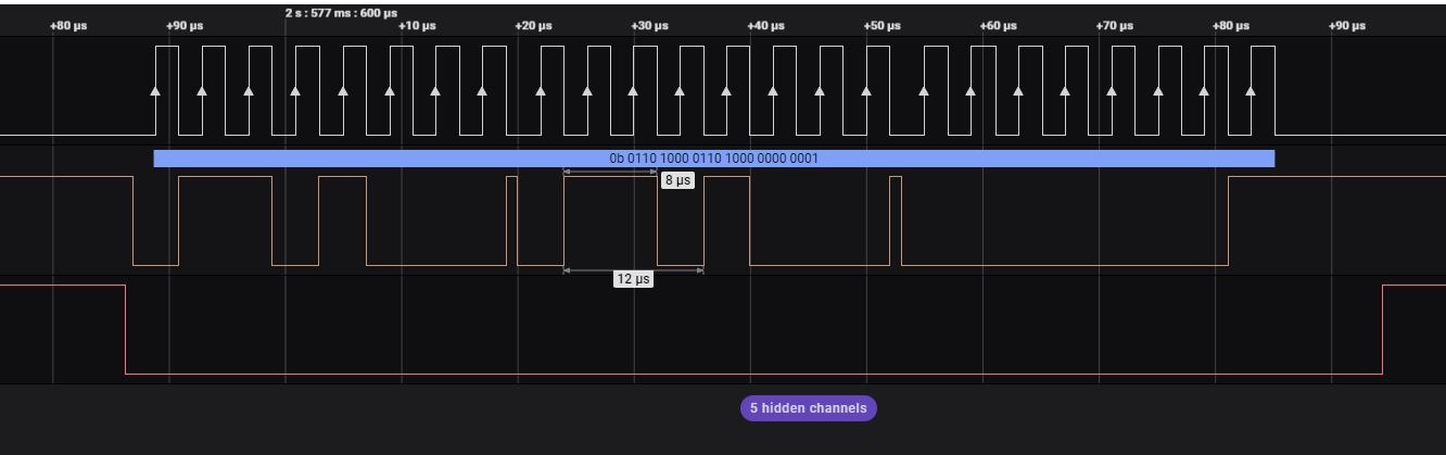

the testing code of UNO
电子音量IC(TC9459F)功能测试代码,2024年2月
#include <SPI.h>
//TC9459F与Arduino UNO连接
#define STB_Pin 10 //Arduino板的Digital #10接TC9459F的STB(#14)接口
#define DATA_Pin 11 //Arduino板的Digital #11接TC9459F的DATA(#13)接口
#define CK_Pin 13 //Arduino板的Digital #13接TC9459F的CK(#12)接口
//定义TC9459F的地址,和是否启用响度
const uint8_t Addr_Loudness = 0b10000000; //不启用响度,CS1和CS2都接地
uint8_t Volume = 0;//用于控制音量大小,根据TC9459F数据手册,最大音量为0dB,对应的寄存器写入值为0b0000000,最小音量为-89dB,对应的寄存器写入值为0b1001101
const uint8_t defaultVolume = 30;//默认音量,-30dB
void setup() {
//设置CS脚位
pinMode(STB_Pin, OUTPUT);
digitalWrite(STB_Pin, HIGH);
//初始化SPI
SPI.begin();
SPI.beginTransaction(SPISettings(250000, LSBFIRST, SPI_MODE0));//根据数据手册,芯片工作频率为0~1MHz,寄存器数据写入顺序为LSB
Serial.begin(115200); // output
void loop()
for (Volume = 0; Volume < 50; Volume++) //控制音量衰减由小到大(音量从大到小变化),衰减控制数值从0(0dB)增加到89(-89dB)
TC9459Write(Volume, Volume);
Serial.print("Volume=");
Serial.println(Volume);
delay(10);
for (Volume = 50; Volume > 0; Volume--) //控制音量衰减由大到小(音量从小到大变化),衰减控制数值从89(-89dB)减小到0(0dB)
delay(10);
//TC9459Write(defaultVolume, defaultVolume);
//Serial.print("Volume=");
//Serial.println(defaultVolume);
//TC9459F写入函数
void TC9459Write(uint8_t leftAttenuation, uint8_t rightAttenuation)
//拉低CS脚电位,准备写入
digitalWrite(STB_Pin, LOW);
delayMicroseconds(1);
//写入数据
SPI.transfer(leftAttenuation);
SPI.transfer(rightAttenuation);
SPI.transfer(Addr_Loudness);
//拉高CS脚电位,完成写入
SPI.endTransaction();
