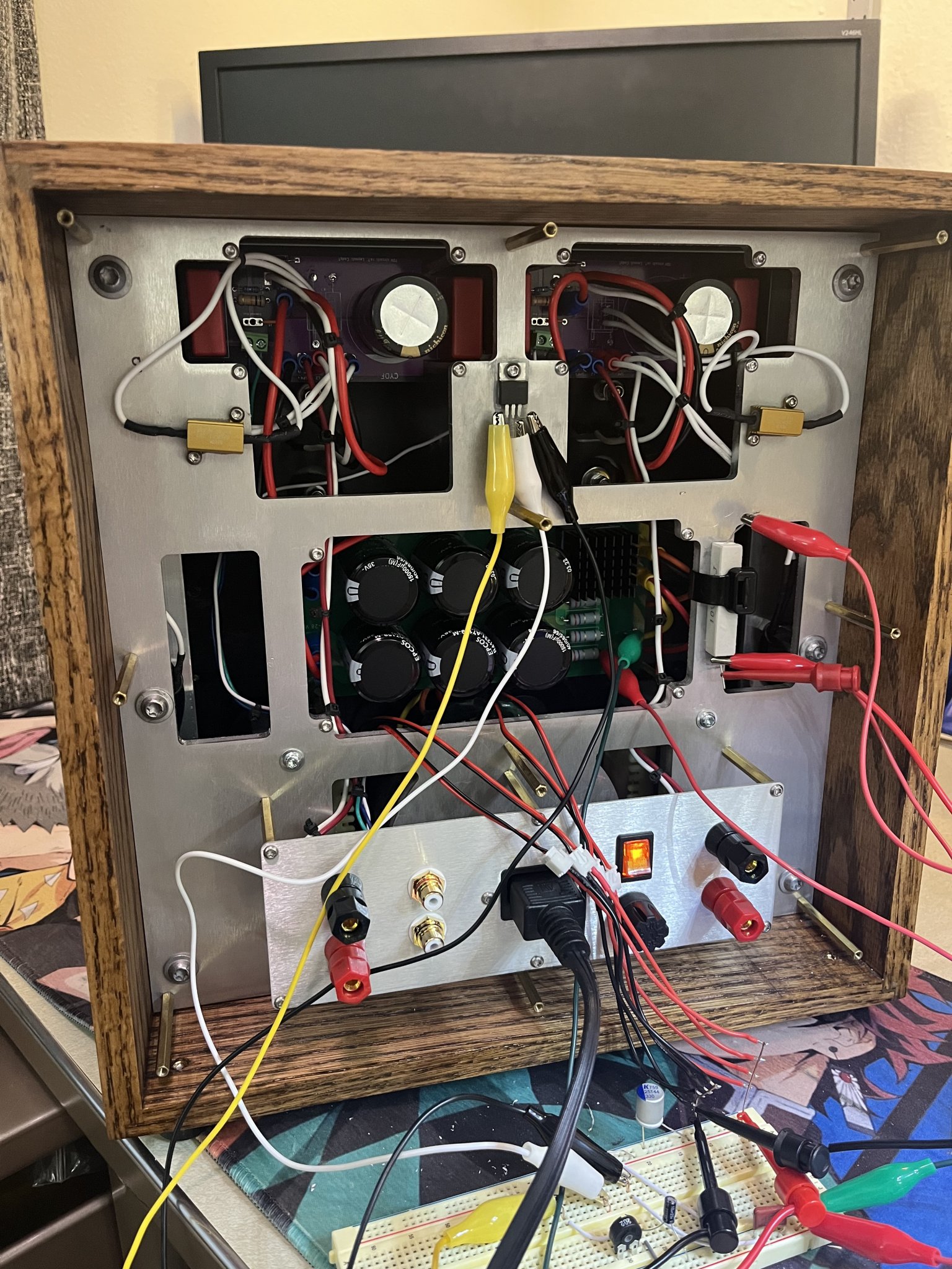

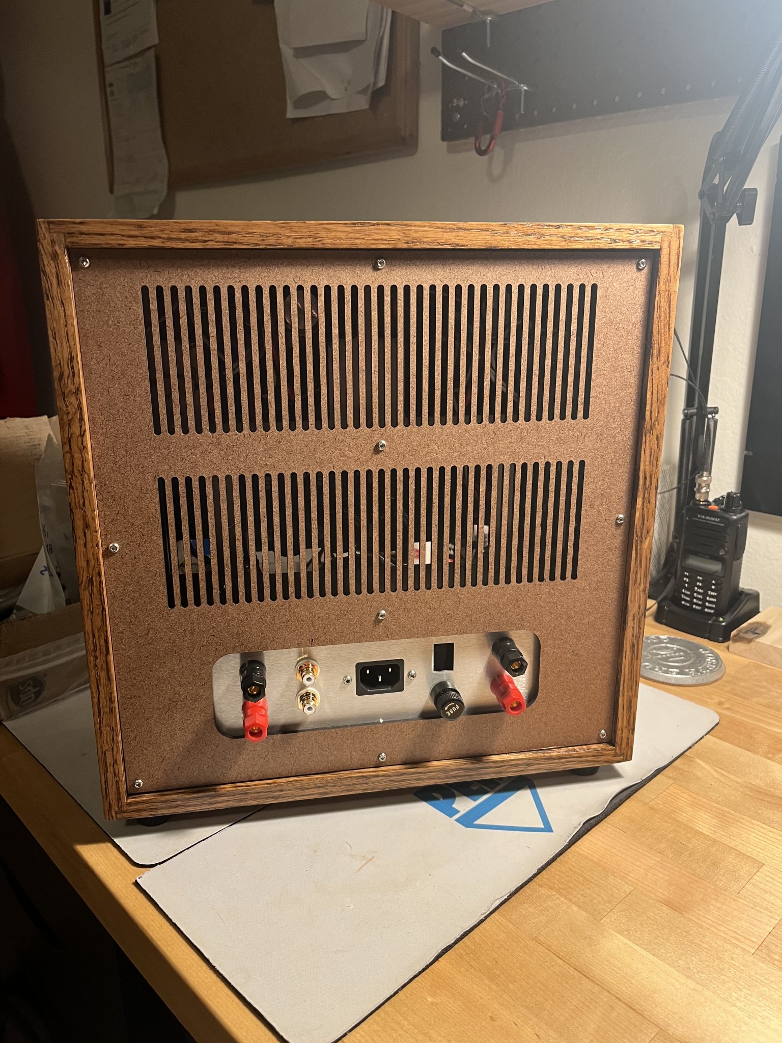

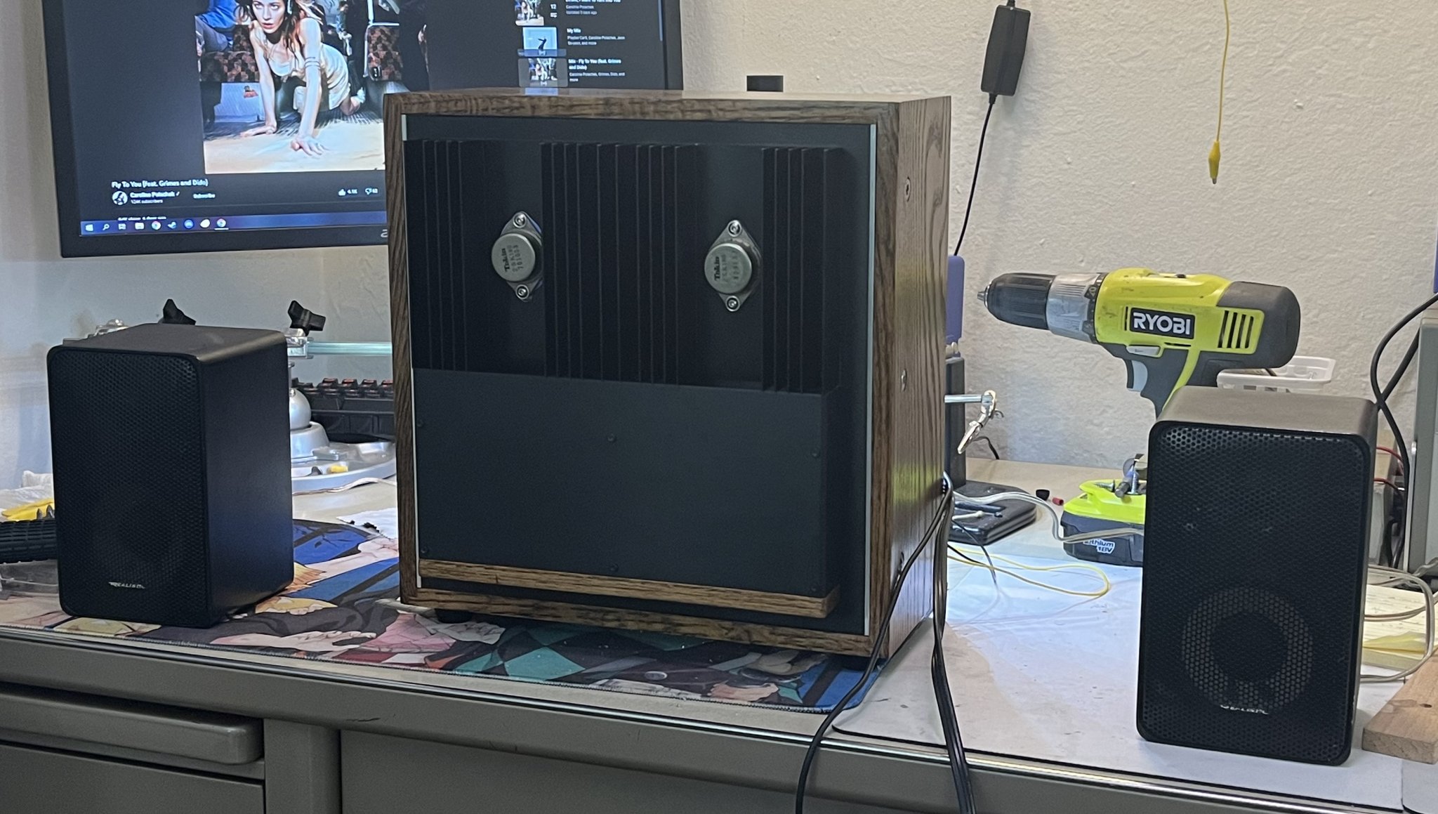

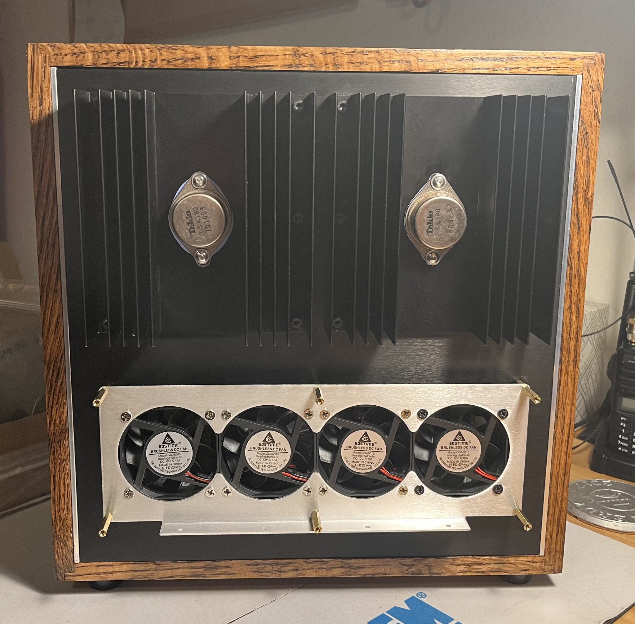

The fan shroud is finished and active cooling running.
Four 60mm fans are inlaid in the cutout that was in the front plate. They are covered by the black shroud that directs the air up over the SITs and sinks.

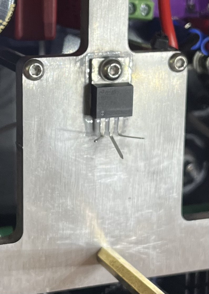

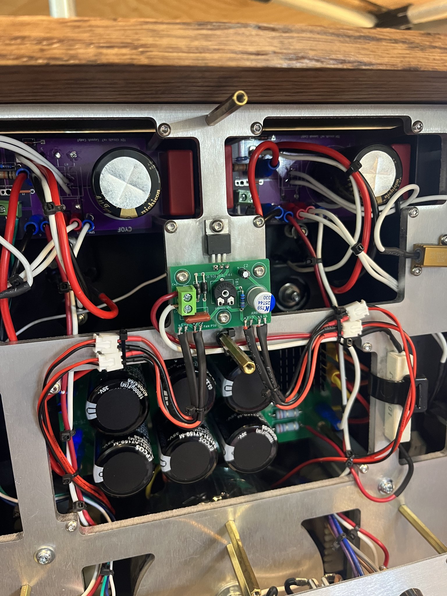

LM317 control circuit takes power from the main circuit and lowers it for the 12V DC fans. The output voltage is adjustable to tune for noise/performance. The LM317 is sinked to the aluminum mounting plate. I used a hobby knife to split my mica washers into even thinner slices to minimize heat transfer resistance. Added a thin layer of thermal compound to fill any gaps as well.
Air is drawn through the inlets on the backplate and also cool the internals a bit.
Making the fan control PCB currently, and once that’s done I’ll be able to call this project complete (until I decide I want to crank the bias up).

You guys are eons ahead of me on the electronic design but from a mechanical and maintenance perspective (working in computer/metrology labs with equipment all using fans) I would recommend you put some kind of air filters upstream of the fans.
Also you might want to put some knurled screws on the front plate so you can service the fans and the filters.

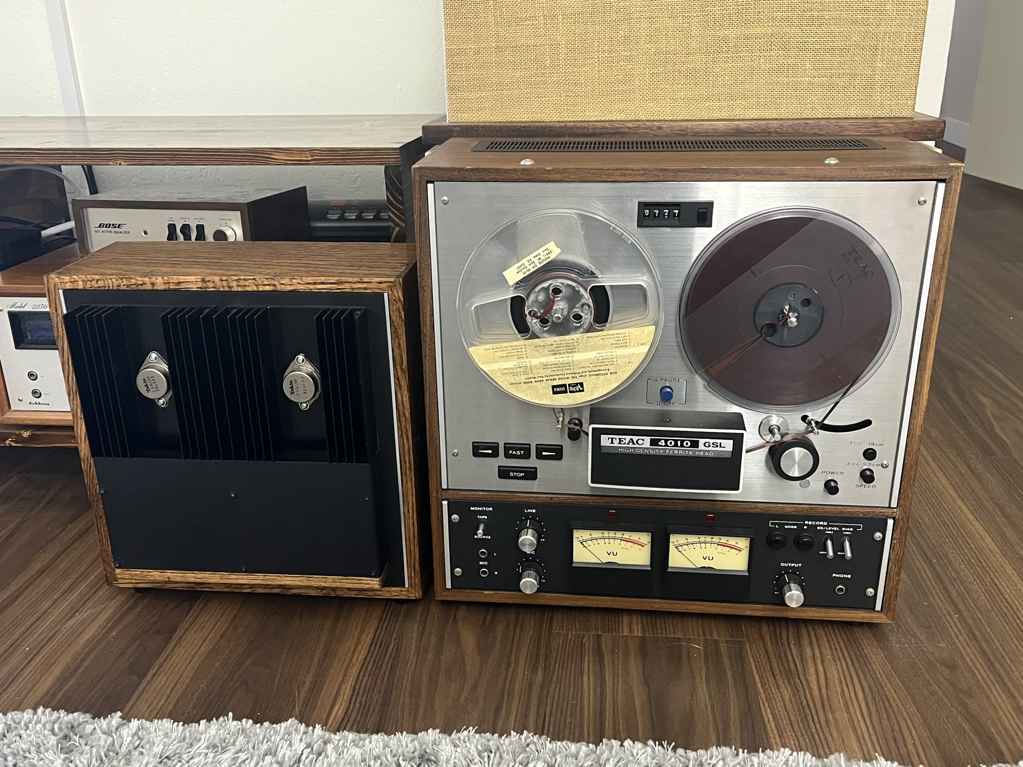

Other than that -and hiding the Bose equalizer- that the best looking amplifier I have seen in eons. Likely ever in my 45 years of audiophile habits... It looks vintage proper with the 2230 and the Teac R2R, except that I'll bet it sounds modern.
That internal metal plate is simple awesome. It is built like a R2R. Did you build the case yourself? You know, if you put some black mesh covers over the transistors, that amp would sit on a shelf in the living room and our Significant Others would actually like them.
IMHO you have found the Mother Lode of domestic amplifier mechanical design.

High praise! I really do appreciate the compliments. I didn't do any circuit design this time around thanks to ra7 and codyt so I went all out on the case to compensate. I have some fine filter mesh I can plaster over the intake vents--definitely a good call.@Jerdy... bravo!

Nothing like a little bit of finished wood to make things look vintage. That, and the fact I took direct inspiration from the Teac R2R to guide the design. As for things like thumbscrews, I chose all my fasteners based off what I could get for free through my work. Many of them are products I designed myself for certain electric vehicle OEMs... I can't pass up the opportunity to use some one-of-a-kind screws (and make everything Torx drive)!
