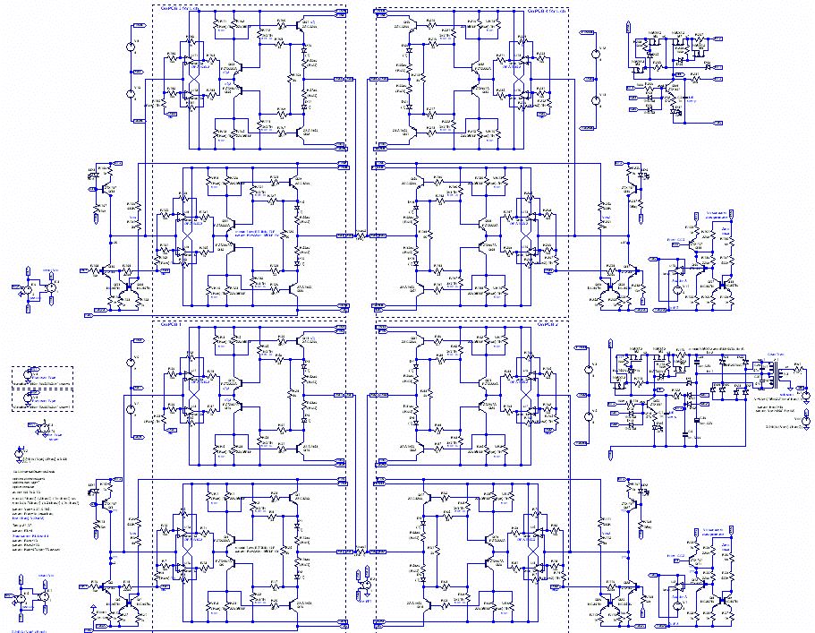

Attached 17L files which uses independent Class-G lift. The previous 17k version used common rail lift. It saved 4 MOSFETs but has a problem when one channel output is shorted -- the shorted channel gets rail lifted when the other non-shorted channel needs lift, and this defeats the advantage of Class-G for reduced SOA when the output is shorted. So independent Class-G lift is used in the 17L version. The full circuit is shown below
Autobias-ES3BB-MJL3281-OPA1656-2slice-ZXT851-shift-DCin-2Bridge2x8R-PS+2G-17L-cct.jpg
A hi-res zoom-able PDF version is attached.
It looks complicated but is for 2 channels and is modular -- as two PCB's, plus two power supply Class-G modulators, and one power transformer. Each PCB (Post 318) has two pair of power transistors for 13A peaks intended for 8 Ohm loudspeakers with 5 Ohm impedance dips. Each PCB includes the input level shift (aka VAS) and the bias centering stage using an opamp (bottom right) for DC input (but normally decoupled with a capacitor).
It's interesting to see a different power amplifier schematic.
In the PDF version it isn't clear on the wire crossings which connections are made and which are not. For example on the LT Spice schematic R172 doesn't connect to R166 but R162 and R166 do connect. But on the PDF reader that I am using R162 and R166 are shown disconnected, the dot showing a connection has been missed.
I haven't looked in detail but what are the differences between the 4 different amplifier schematics? Is there overall feedback from the outputs?

I have an updated PDF attached to fix the ambiguity of wire crossings. Thanks for mentioning it. I'd assumed most could load the schematic into LTspice to view it, being too large for a hires jpeg picture insert. Maybe there are many who can't use LTspice for viewing? Like MAC users? Etc?

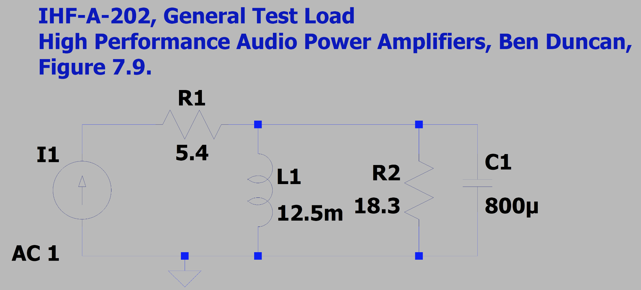

Re: Testing with dummy loudspeaker loads is a good idea. I had been thinking of finding one. AFAICS low impedance dips in "difficult" loudspeakers seems to be from a crossover interaction and not the speaker drivers. So a loudspeaker model needs more than just a single speaker driver model, it needs all the crossover components as well. Anyone here got a complete model they can share?
BTW the IHF-A-202 seems to be for a 20ms sine burst twice a second. It would be a useful test for this amp. I notice it was used for the Crest 8001.

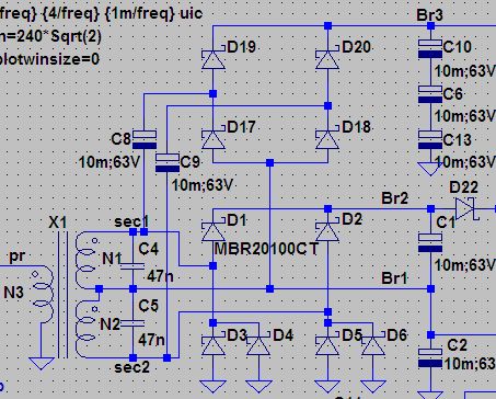

Attached is a sim with 3 step Class-G. It improves max efficiency with music to 50%. Recall Crest 8001 is 2 step-G with music or 1/3rd power is 31% max.
To get 3 voltage levels at 33%, 66%, 100%, I add a full-wave doubler giving 140V no load, sagging under load to about 110V peak to the power amp, giving about 1600W/8R peaks per channel (but not suitable for continuous sinewaves with the transformer rating and capacitors used here). To build it, I'd lower the secondary voltage slightly to say 30V FL and use lower cost 50V caps. See snip below. View the PDF for the circuit or zip run it.
Since the full wave doubler takes 80ms at startup to reach full voltage I have delayed the music recording by 80ms (a different wave file file to previous sims).

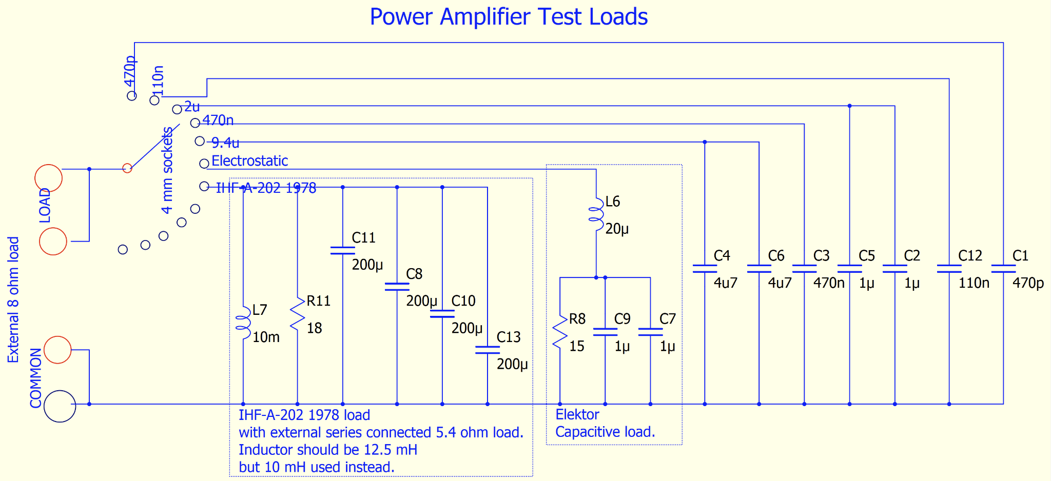

On IHF-A-202 I believe that IHF is the American Institute of High Fidelity and the standard is 'Methods of Measurement for Audio Amplifiers'. I don't have a copy of the standard (which appears to have been superseded) but it was described in the magazine Elektor, issue January 1979. It specifies a reactive (dummy loudspeaker load) that I used. It also specifies a tone burst among other tests.
I have also attached a circuit diagram of the load that I built. The different loads are selected using a wire link that plugs into 4 mm sockets. A rotary switch would be preferable but any high current parts that I found were rare and expensive so I used 4 mm sockets and a link. There are some spare sockets for any additional loads that may be added.
The circuit is used in conjunction with a load that also uses wire links and sockets to select the resistance from 0 to 9.9 ohms in 0.1 ohm steps.
Any suggestions on what other dummy loads could be used are welcome. It would be useful to have an agreed standard to compare amplifiers.

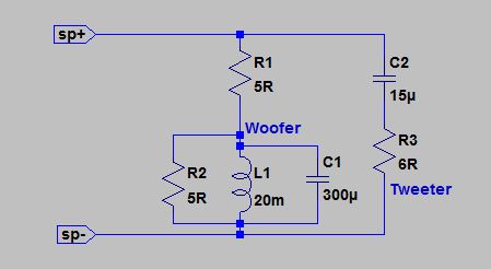

Thanks for the model and references. I have added the speaker model (files attached)
My test music file is just a guitar strum courtesy of member Mason Green. Iy gives some sharp rising peaks. In my sim I can see the peak speaker current for full swing is significantly more than the usual pure 8 Ohm load - it shows the equivalent load is determined by the 5.4 Ohm in the model, which represents the voice-coil dc resistance to a first approximation. My amp need to drive more like 5.4 Ohms. It is close to what I was considering. But that's only for a single driver and not a system with a crossover. Ben Duncan's book Fig 7.9 (p271) says the model is "for a single drive unit".
I then tried a model for the JV60 speaker (sold in Australia as a kit) to see if adding a tweeter further reduces impedance and the peak current requirement. The zip includes the JV60 sim - it is the file with ...2x8RLS.asc (Duncan version ...2x8RS.asc). BTW the 2 extra speakers are parked if you want to change between models.
The peak current increased from 15A for the Duncan model to 20A for the JV60. That's equivalent to 4 Ohms with the tweeter. Notice its not 5 Ohms in parallel with 6 Ohms or 2.7 Ohms - its not that simple.
Next I reduced the transformer secondary voltage from 35V to 25V since I am driving 4 Ohms, lower than I had expected. With the doubler I get 3 levels at about 30V, 60V and 90V. Slightly more volts than 35V secondaries thanks to the doubler for the top rail. I get up to 1.7kW peaks (82V peak). Overall music efficiency with my 6:1 PMR recording gives about 34% efficiency with the JV60 model in place.
It looks like I need to rethink how to get 20A peaks. I previously thought I could make the bridge with 2 PCB's and increase the current limit from 10A to 13A or 14A but now it looks like I need 4 PCB's per bridge to get 20A peaks, or 8 PCB's for 2 channels.
