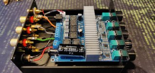

I recently had a reason to get me one of those TPA3116 2.1 boards. From the few choices I ended up with the one with most adjustments:
TPA3116 2.1 Digital Audio Amplifier Board HIFI DC 12-24V BASS Speaker 50W*2+100W 721968958942 | eBay
First test with a 19v laptop PSU wasn't very promising, there was hiss and buzz from every channel. The buzz disappeared almost completely when I touched the heatsink. After that I assembled the amp in an aluminium enclosure, hoping to get rid of some interference.
The hiss from main channels disappears when I turn the treble pot clockwise. But after that the buzz gets louder... not good.
The amp is connected to my pc via FX-AUDIO DAC-X6, first using the usb connection. I could pretty much hear every single thing that happens inside my computer. Tried to get rid of that with optical connection, but no good. The interference has to come from the mains network, because I also get sounds from my speakers when the freezer in the same room starts up. The freezer has safety earth, but the PSU doesn't.
I will try to get this working, so next steps are:
1. Test with another PSU
2. Test with other sources and computer without the DAC between
Any tips on the amp itself? Should I try to make some grounding between the board and the enclosure? I don't have any pcb stands in there at the moment, they would probably make some connection between them? At the moment the only connection is from the pots.

Yes, a good quality PSU might improve it, but it's not a possibility here. I wan't to do this as small (and cheap) as possible, I have plenty of those laptop bricks.
Did try with a brand new Fujitsu OEM PSU but no improvement.
Took off the heatsinks to see what's going on under there, and will it make a difference; no. Well, at least the other chip is mute now, no output at all, don't know what happened
Only thing I noticed so far, that the SDZ and FAULTZ pins show nothing on the muted chip, while the working chip pins measure 16,7v. The pins are connected together, so the chip should recover from faults, right? Or is it fried now?

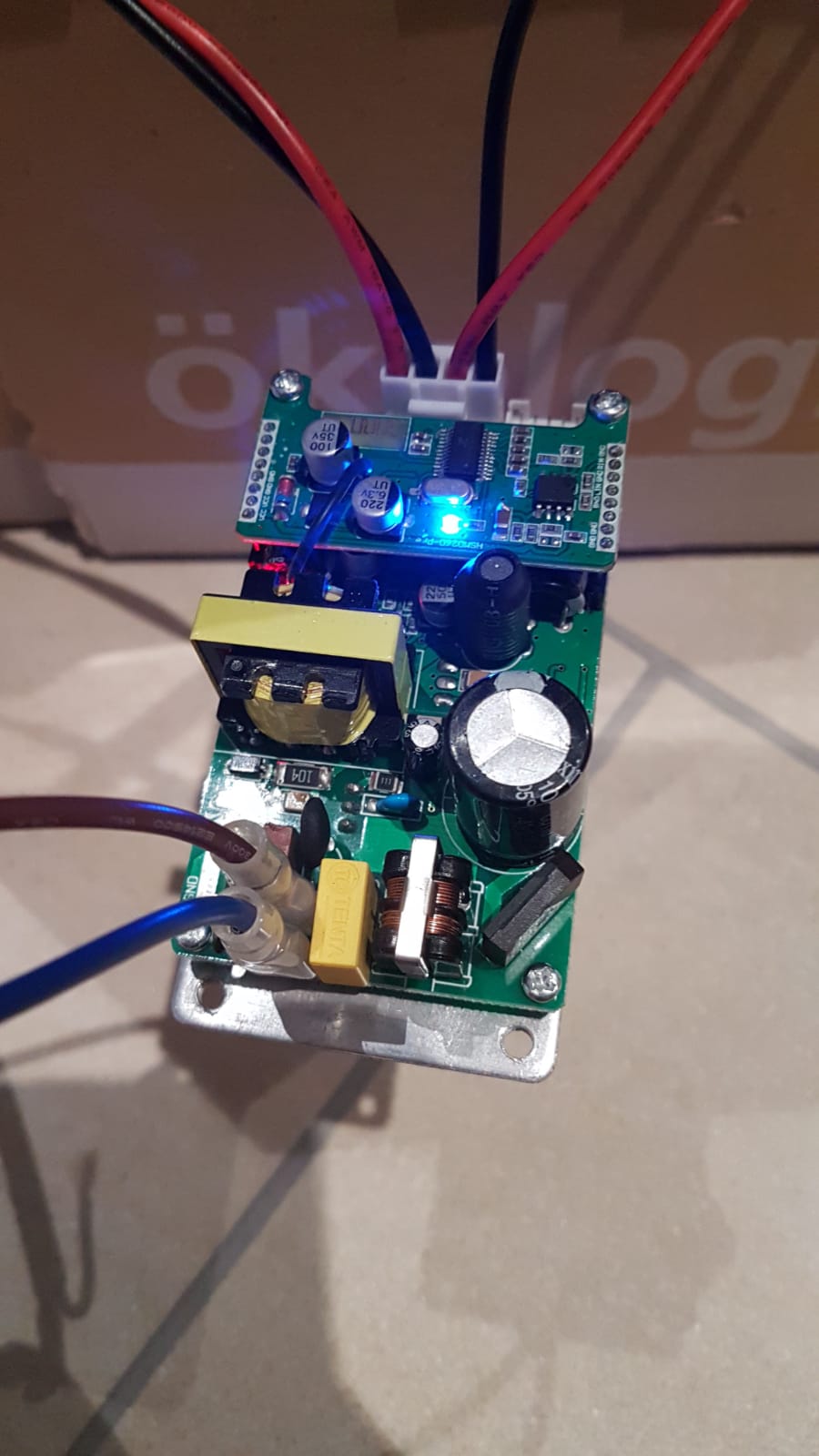

The output z of that laptop supply will not give kick-drum bass.
I use the tpa3118 mono boards and mount a few inches from MeanWell 24v 100W supply.
The little boards sound unbelievable, bass like a subwoofer.
yes i can agree - i use a different model - a cheap mean well LRS150-24V is not bad for 21euros over amazon

Hi
You just use a different PSU and now a chip is set down --> not working anymore?
Hi
Changing the PSU didn't do it. It worked just fine after that. Something happened when I took off the heatsinks.
Don't know where to begin with troubleshooting, I might leave the amp as it is and use it later for a small sub or something, because the other chip still works.
The heatsinks were fastened with screws, not thermal glue?
Physical stress can damage the very thin PCB tracks.
My experience with a defect TPA3116 stipulates: Power off, speaker disconnected. Check with an Ohm-meter on the power supply terminals (red probe to supply "+", black probe to supply "-") if the impedance increases steadily to above 20KOhm. Then, measure the impedance from the two outputs (to the speaker) and to ground - any below 200 Ohm? Same from the two outputs (to the speaker) and to the positive supply terminal - any below 200 Ohm? And, between the two output terminals.
If no low impedance measurements -> speaker connected, no input signal and power on. Are the potential at the two speaker output terminals (to ground) around half the supply voltage and the same for the two terminals?
Thanks FauxFrench, I'll try to give it a go:
Yes, only screws
Supply connected to the board? And then measure from the supply post? I get some readings from the meter in ohm-scale, just quick flashes, but it doesn't have auto-scale. In 1k and 10k scale, nothing.

As I understand, it is the main channels ("MC") chip that doesn't work while the SW channel works? If so, let's concentrate on the MC chip only.
You write "nothing". For impedance I understand this to mean high impedance while for voltages a low voltage near 0V. Correct?
You give an important information: The FAULTZ and SDZ pins are low which indicates the chip on startup sees a fault and mutes the amplifier on the SDZ-pin by pulling it down with the FAULTZ-pin.
What fault does the MC chip see (our quest)?
I find one strange measurement value among what you show: "-right output: 66,4". If that means 66,4 Ohm, it indicates an output problem. Is it 66,4 Ohm or 66,4 K?
For your impedance measurements to the "+" and "-" terminals from the output terminals, I only have half the values I expected. For the MC chip you have 4 output terminals: two for left channel and two for right channel. My experience from measuring on 7 defect TPA3116 is that one of the 4 output pins "hang" (short-circuited to) on either "+" or "-", typically "-".
I will kindly ask you to redo the impedance measurements, without speakers connected and no power. From all 4 output lines to "-" and from all 4 output lines to "+". May one be hanging?
If no output line is hanging, we will turn to the input pins. If one of the input pins are outside correct operational value, the FAULTZ will be pulled low. Lets see afterwards.

Hello
I recently bought a TPA3116 amplifier with built-in psu und bluetooth module.
It works well but without music it’s a bit noisy. Amp is always at 100% volume. When turn on and off you will get some plops on speaker.
It cost just less than 17$ shipping included.
