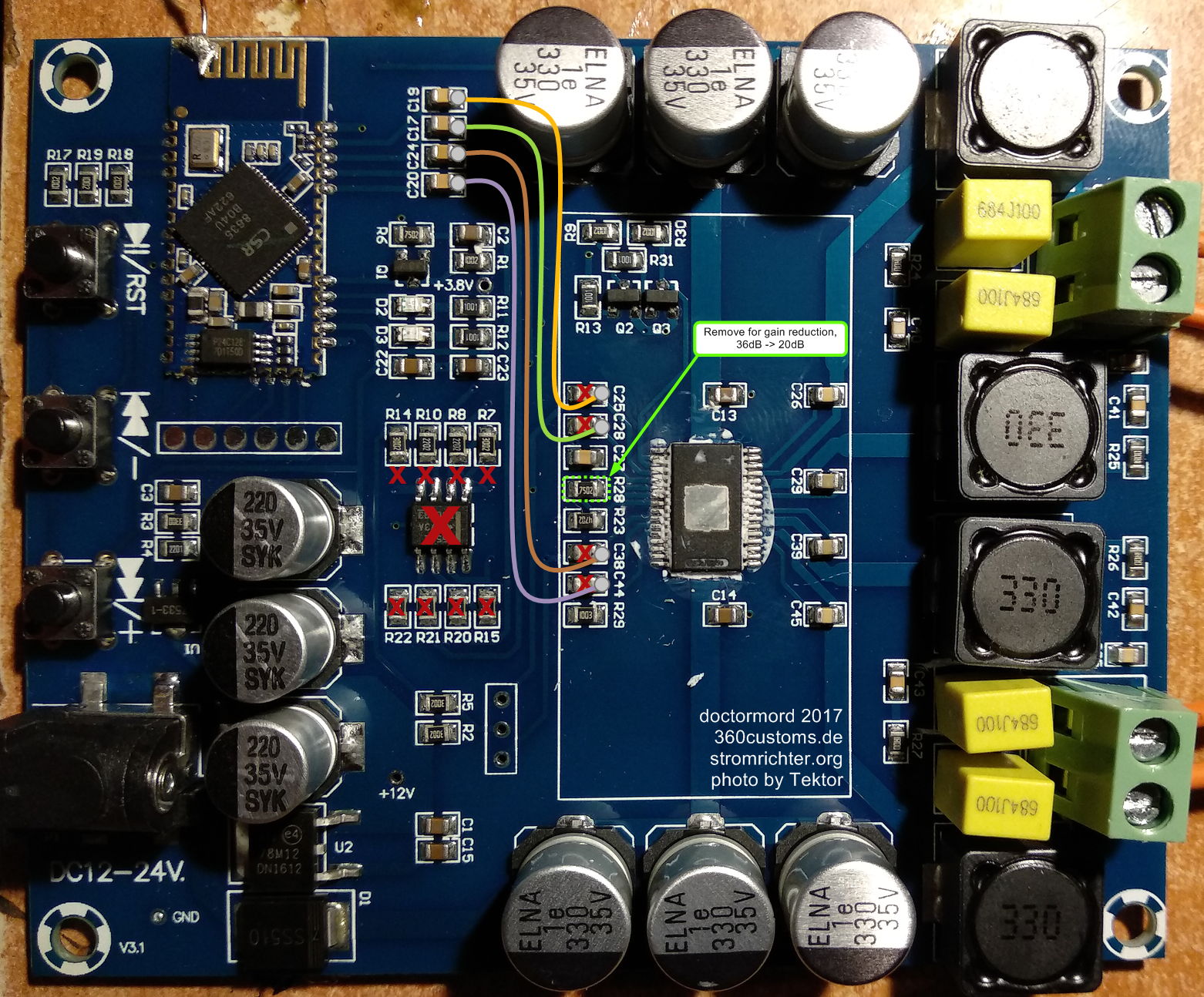

What does this Differentiall-2-Singe-Ended mean? Is it important or should it be removed?
Has anyone tried this to remove noise?
Has anyone tried this mod to remove noise?

remove most of the noise by from the tpa3116d2 just removing r38. Thanks doctormord !! Are there any good/noticeable benefits with continuing with your recommendations.
*removing R28
