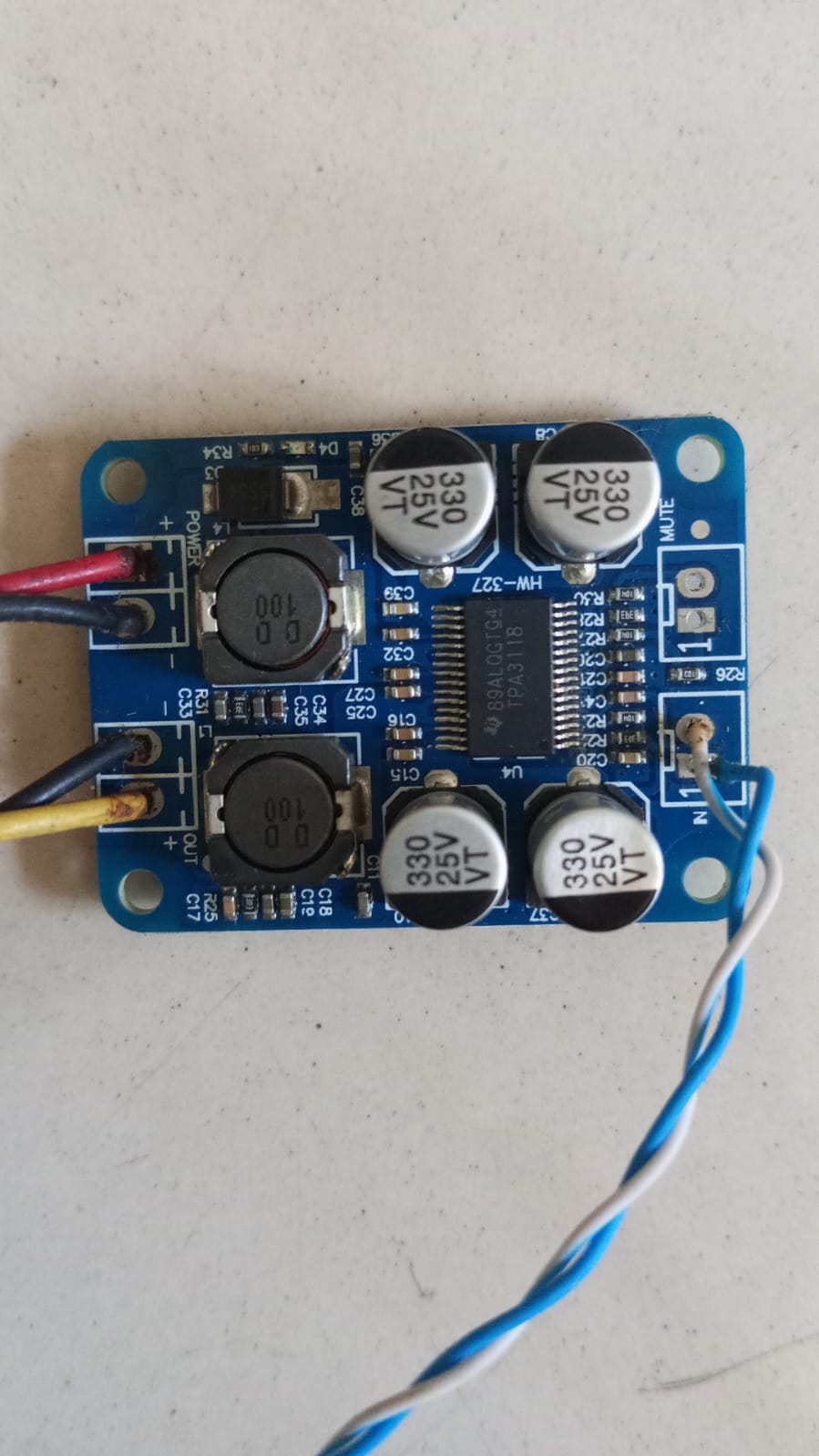

And unfortunately I've had the fake one burn up a speaker at one point. It put full Vcc on the speaker terminals and made smoke! Thank you China! I guess that's what I get for trusting China in the first place. I definitely learned to count pins after this event a couple years back now.Fake 28
Genuine 32

I have been building and using class-D modules based on genuine TI-chips for about 12 yrs.And unfortunately I've had the fake one burn up a speaker at one point. It put full Vcc on the speaker terminals and made smoke! Thank you China! I guess that's what I get for trusting China in the first place. I definitely learned to count pins after this event a couple years back now.
Not a single burning failure occured during all these yrs.
These chips look pretty reliable to me, never used additional speaker protection.
Never had that either with any TPA3116/3118 contrary to TA2020, TA2022, TA2024 and very unfortunately MA12070 (the already discontinued king of sound). The ones you love hurt the most 🙂

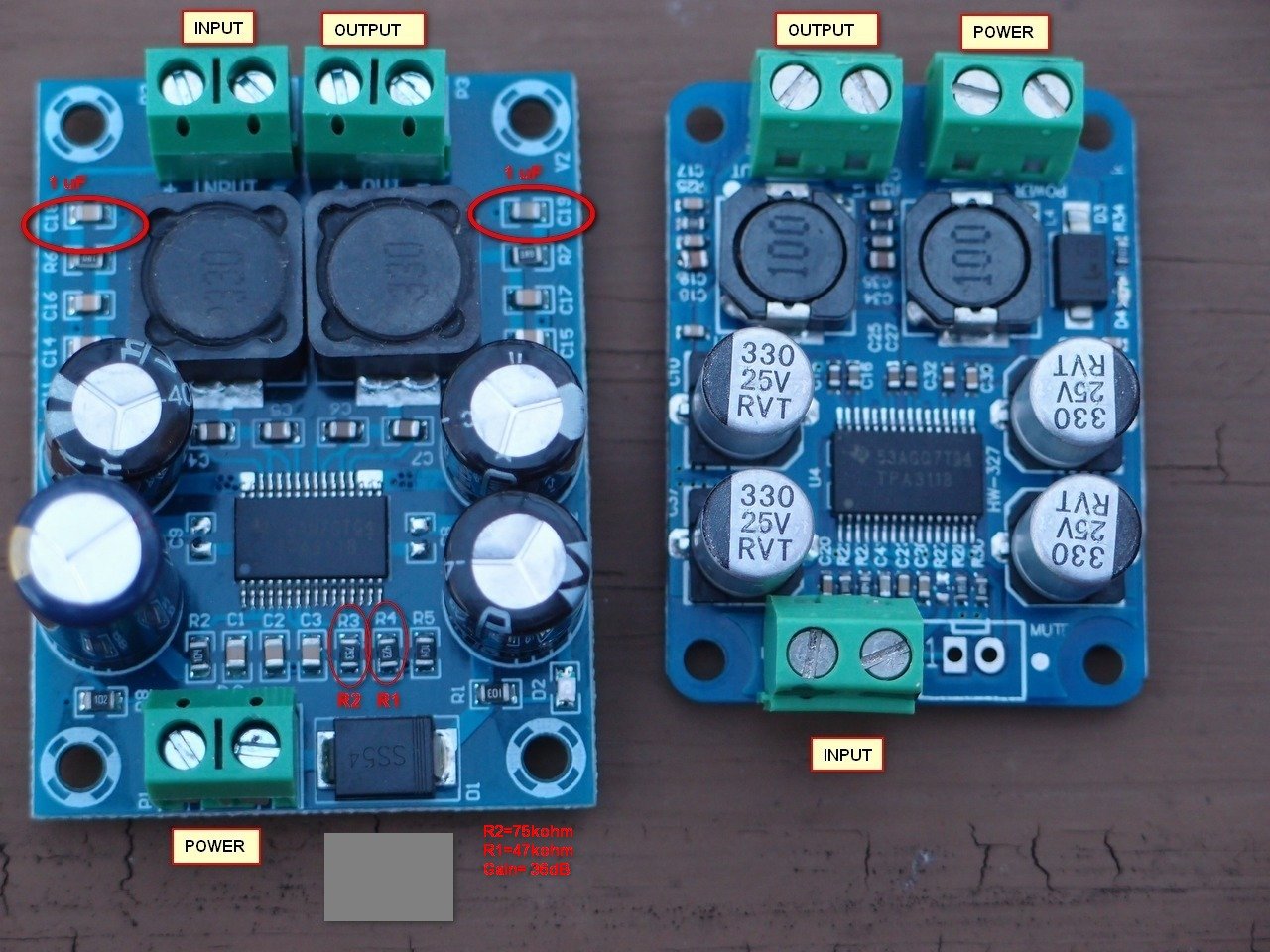

Fortunately , I didn't faced this issue but these AliExpress fakes can't handle difficult 4 Ohms speakers with impedance dips. Audio cuts out during deep bass and a sensitive tweeter emits continuous buzzing sound, audible during quiet passages I'm using these for the last 5y regularly as a PC speakers (6 Ohms Sony ) with a Laptop brick @19VDC. I also have a Allo Volt amp with the genuine 32 pin IC, it handles 4 Ohms gracefully those same speakers.And unfortunately I've had the fake one burn up a speaker at one point. It put full Vcc on the speaker terminals and made smoke! Thank you China! I guess that's what I get for trusting China in the first place. I definitely learned to count pins after this event a couple years back now.

This one is good, but this one (on the left) is even better sounding. I could never figure out why. I did some swapping of inductors and caps. I didn't spend more than an hour or two on it, but there's a difference.Fortunately , I didn't faced this issue but these AliExpress fakes can't handle difficult 4 Ohms speakers with impedance dips. Audio cuts out during deep bass and a sensitive tweeter emits continuous buzzing sound, audible during quiet passages I'm using these for the last 5y regularly as a PC speakers (6 Ohms Sony ) with a Laptop brick @19VDC. I also have a Allo Volt amp with the genuine 32 pin IC, it handles 4 Ohms gracefully those same speakers.
