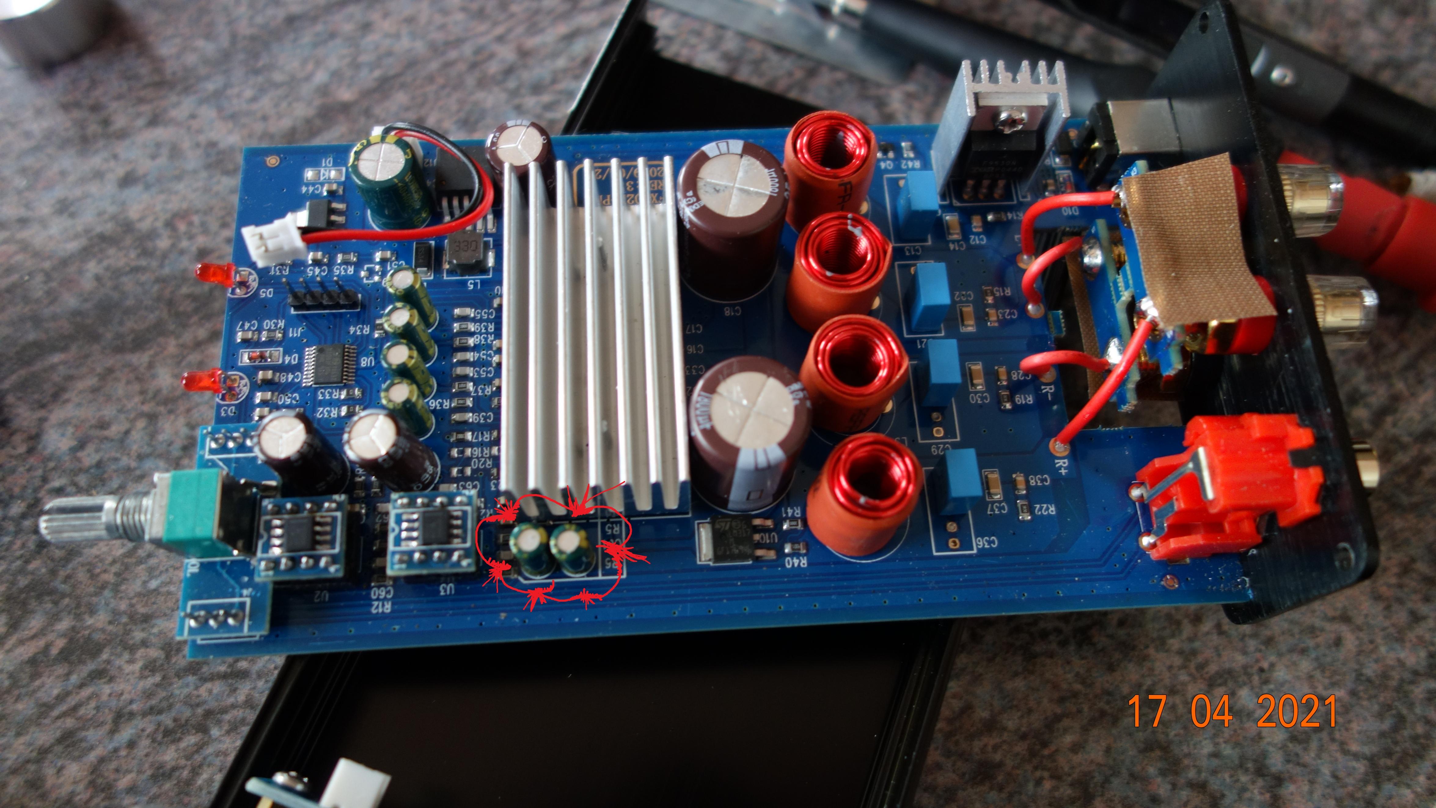

broken SMD capacitor
Anyone know how I could replace this broken SMD capacitor on this FX D502 class D amplifier? Anyone has a schematic?
How did it break like that?
I was wondering if there was a way to get an analog line out from the onboard USB DAC, so I opened it up, but instead found that this capacitor was broken. I was broken on one end only at first and then when I touched it with a plastic probe to check, it complete fell off. I'm guessing it drives the subwoofer out which I don't really use anyway.
In anycase, is there anyway to get an analog out before it hits the power amplifier stage? Sorry if this is a naive question. Thanks!
The problem is that - here are the owners of the FX 502S PRO amplifier. Therefore, it is not even possible to measure the value of this capacitor :-( The topologies of the amplifiers are different.
Now, if about the amplifier FX 502S PRO, then I am ready to tell you everything and even more than the "manufacturer" knows 🙂 Sorry that we could not help you :-(
I have changed a few things in the design. But, beforehand, I carefully studied this topic here. The most important and significant for the sound is the change in the output voltage of the power supply. At least 27-28 Volts should be supplied to the amplifier from the power supply. In general, the stock power supply unit is not capable of providing full-fledged sound quality. And you need a power supply for a voltage of 30 volts and a current of 8 amperes. Also in the amplifier, I replaced the output capacitors ( of dubious quality 1uF x 63V for high-frequency polypropylene Panasonic 1uF x 250V), I also replaced NE5532 with OPA1656.
The only info is about big impact in music quality but no explanation why. It is mentioned a big CAP on pin 14 but from the TI datasheet should be pin 9?
With FX 502S PRO Can I change CAP C24 (pin 9) by a big CAP 470uf 16V ? I hope who can teach me clearly.
Yes, I did that (470uF Panasonic FM) on pin 9 and it sounds much better. Dark, Bass and punch. I soldered it over the existing 1uF SMD cap.
