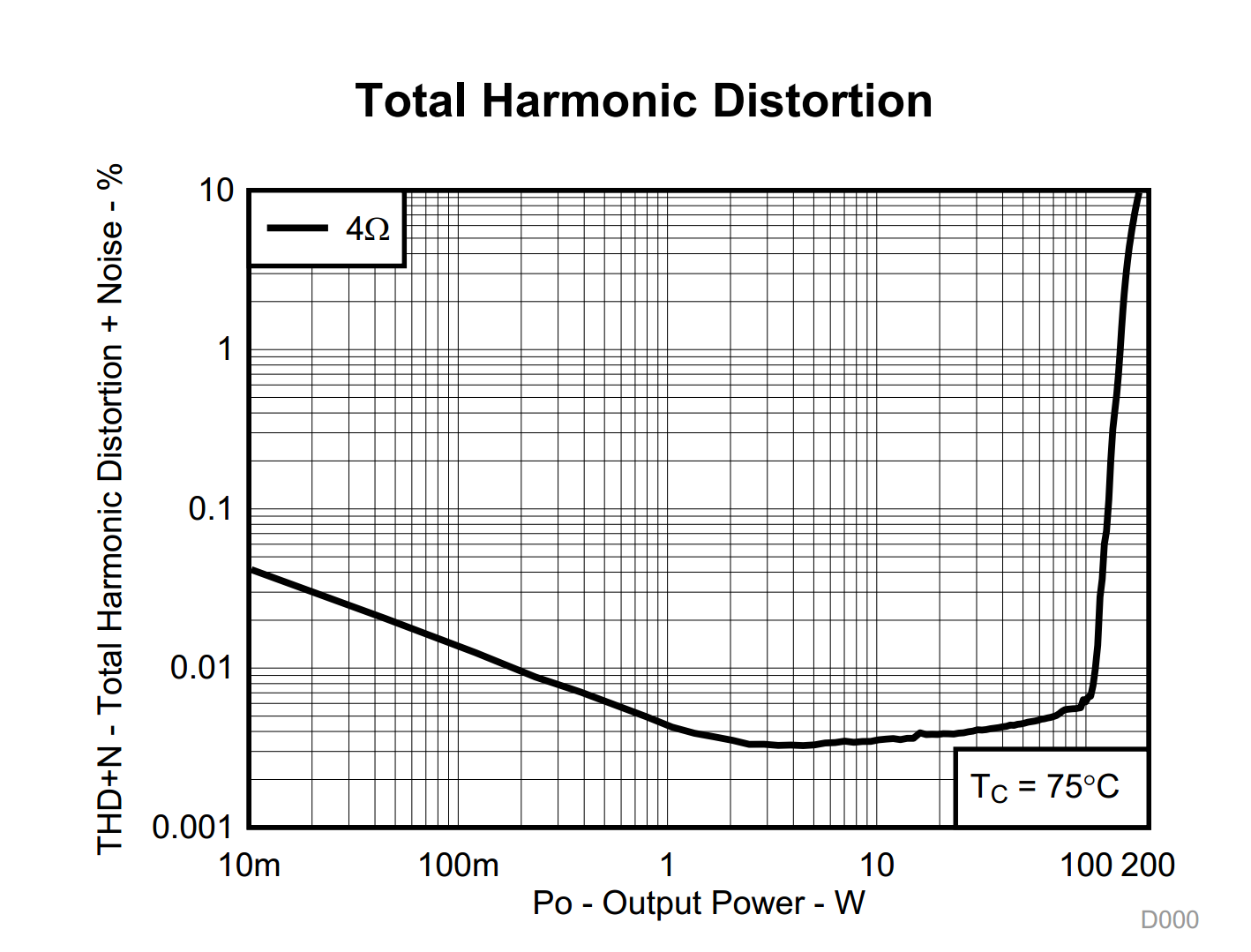

TI has released TPA3251d2 'AKITA" higher power analog in class D chip with higher order modulator similar to Hypex NCore but with pre filter feedback. First heard about it at CES 3+ years ago. Can be configured as 1,2,3 or 4 channel with 36 volt supply for output stage.
I'm really curious how this chip sounds. Pretty impressive description:
"TPA3251D2 is a high performance class-D power amplifier that enables true premium sound quality with class-D efficiency. It features an advanced integrated feedback design and proprietary high-speed gate driver error correction (PurePath™ Ultra-HD). This technology allows ultra low distortion across the audio band and superior audio quality."
