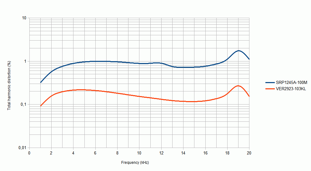

If the L is changing with the audio envelope, it causes the output filter Fc and Q to move around with the L, causing the high frequency response of the filter to dynamically change.
It isn't a huge stretch to imagine low frequency content effectively causing AM/PM modulation of high frequency content, causing IM distortion.

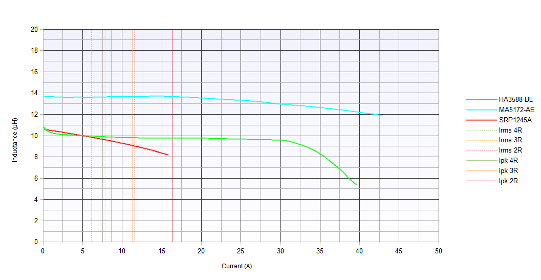

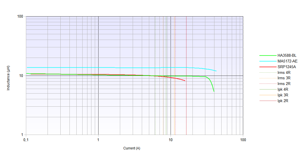

I think there will be quite a difference between Inductors using ferrite and those using some kind of iron powder like carbonyl. Compare the L vs current diagrams and you will see the difference. Ferrite shows a sharp saturation point, iron powder degenerates in a more smooth way. Actually I compare 10uH smd inductors in a stepup converter (3 amps ripple current at 250kHz) and found that carbonyl cores are less lossy than their ferrite counterparts.
So we have
carbonyl = soft saturation, less loss
ferrite = hard saturation, more loss
For the comparsion, lin vs log makes the "difference".
All 10uH inductors
Coilcraft HA3588-BL = AGP2923-103KL = VER2923-103KL
Coilcraft MA5172-AE - stated as 10uH, from the datasheet
Bourns SRP1245A
While Coilcraft prefers dual-log, Bourns do dual-lin.
