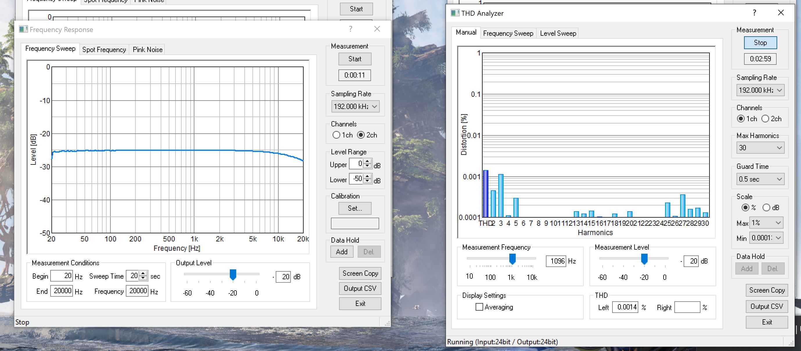

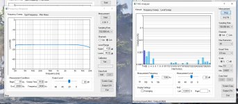

It drops 5 dB from 2k-20k ... ??
This filter for measure, i fix it.
No, 600kHz will kill my soundcard.OK. Please show also without measuring filter.
YesMeasurements you show above is for the TPA3255?
Upon completion of the group buy, I will introduce 2 new amplifiers, Gallium Nitride and 3255, with some schematic tricks added to reduce distortion below 0.0006.
My amp
Can you also show me the measurements of the Akita TPA3255 that I bought in the group?
