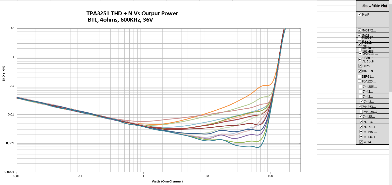

Did you measure it yourself? Where does the file come from?
Not. This is Texas Instrument data.
At a frequency of 1 kHz. most inductors work in almost the same way. It makes no sense to compare them at this frequency.
The difference manifests itself at other frequencies and at a power of more than 1 Watt ...

Use TPA3255 for its intended purpose and there will be no questions about the inductors used. When used in PBTL mode, it doesn't really matter what kind of inductors you have.
For good stereo with low distortion (if there are passive filters in the speaker), you must use two TPA3255 microcircuits in PBTL mode. Even the cheapest filters from SAGAMI (7G14J-100M-R) provide very little signal distortion. Perhaps the best.....
Without a lot of closed loop feedback around the inductor, there is still unresolved hysteresis distortion, so the inductor matters for the typical TPA3255 application: Blog - PURIFI

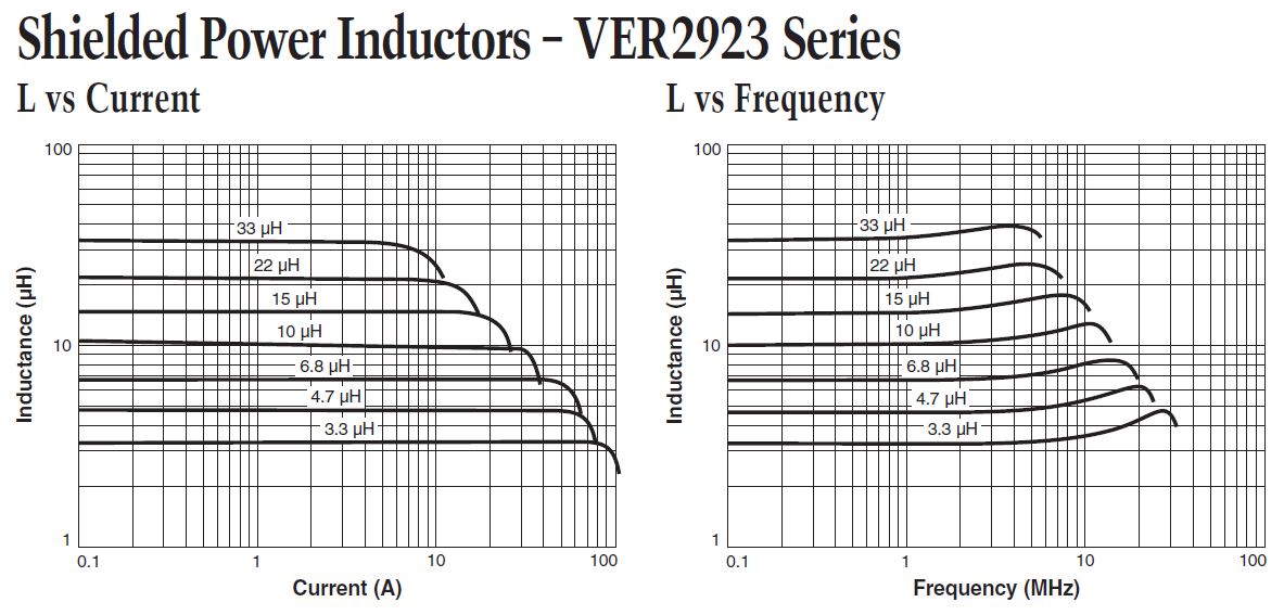

The SAGAMI 7G14J-100M-R is pretty decent and the saturation current is moderately high. The Coilcraft AGP2923 & VER2923 has a higher saturation current and very flat L vs I curve.

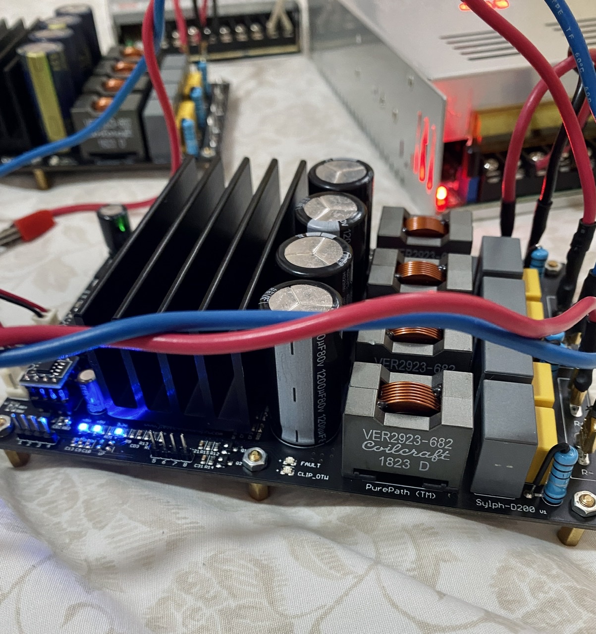

By the way, JLesterP used the 6.8uH shielded version (was changed to 10uH later, due to delivery issues) VER2923 / AGP2923 inductor on his TPA3255 Sylph200 design:TPA3255 - all about DIY, Discussion, Design etc.
