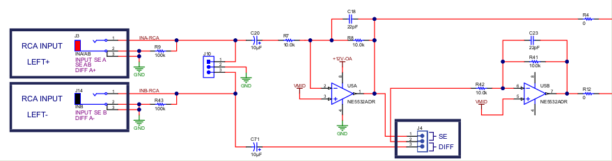

Thanks! So what would you do about volume adjustment? Do you have a go-to method which I could package in the same enclosure I place this amp inside?

Piccy Figure 6) page 18) Input impedance to the amplifiers is 10K. Set it up single ended and use a 10K log pot. Not sure which way up things would go and it might be an anti-log pot but wiper to input on the RCA. Top to your source. Bottom to ground on the RCA.

Hi, Is there a way to increase the gain on the T/I EVM board.

Not via jumpers...

Piccy is Figure 6) on Page 18). R8 and R41 set the gain (With R7 and R42) for the SE/DIF amplifiers. Input impedance is set by R7 and R42. Gain is R8/R7 and R41/R42.
Gain as supplied is unity. Change R8 and R41 to 20K for a gain of 2. You can do similar with R7/R42 but it changes the input impedance. 20K would give a gain of 1/2.
Don't go mad.
