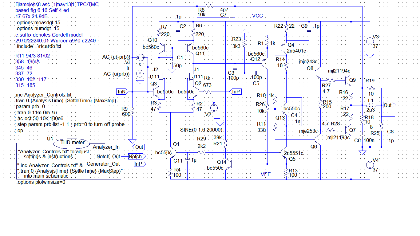

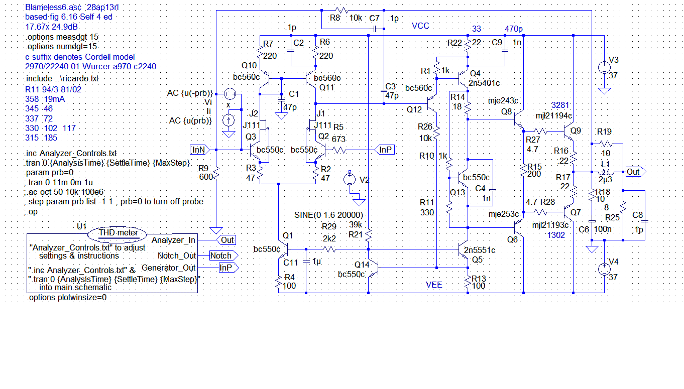

Starting point is Douglas Self’s fig 6.16 from his 4th ed. cos that’s close to what I was playing with in 1990. I’ve used Bob Cordell’s BJT models and some FET models from Scott Wurcer. These give the worst results of any models I can find so are likely to be close to real life. I’ve used mjl21194/3 cos they are the worst of Cordell’s OP devices and closest to Self’s mj802/4502 and the Sanyo device I used. This gave Self'’s results for THD with frequency … and also what I remember from 20+ yrs ago, which was encouraging.

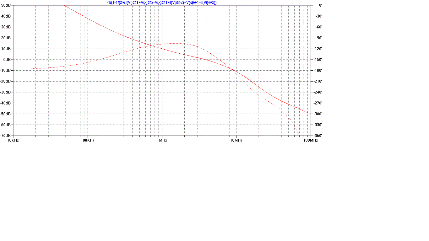

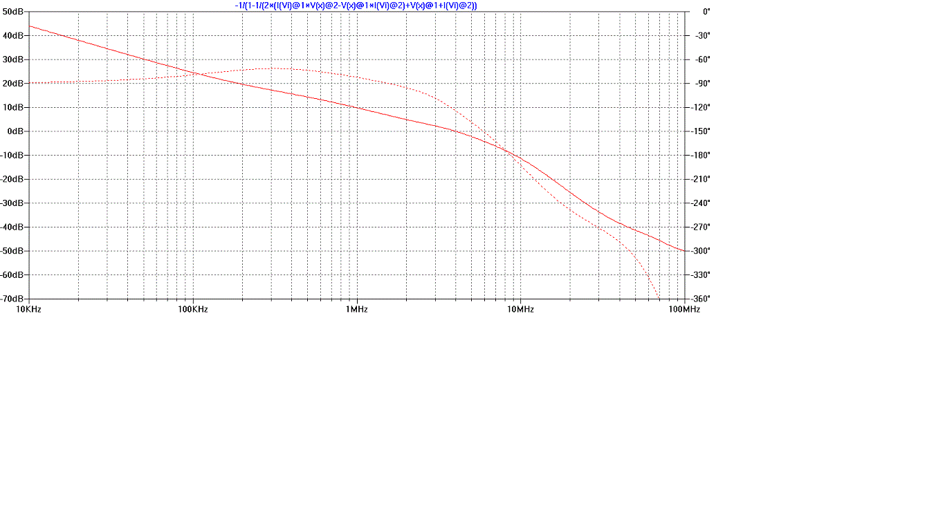

The Open Loop responses are done with a Tian probe (LTspice4\examples\Educational\LoopGain2.asc) at the –ve feedback point. Connect R5 to Ground for this. .AC closed loop responses (not shown) to check for excessive peaking. Connect V2 to R5 for this. For these and plain .TRANS, you need to get rid of the ..
First off is Two Pole Compensation (TPC) around the VAS. I’ve sorta used Cordell’s method by splitting Cdom and taking a tweak resistor R23 to earth. C7=4p7 from the stability tests.

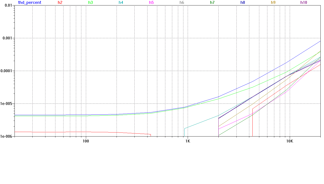

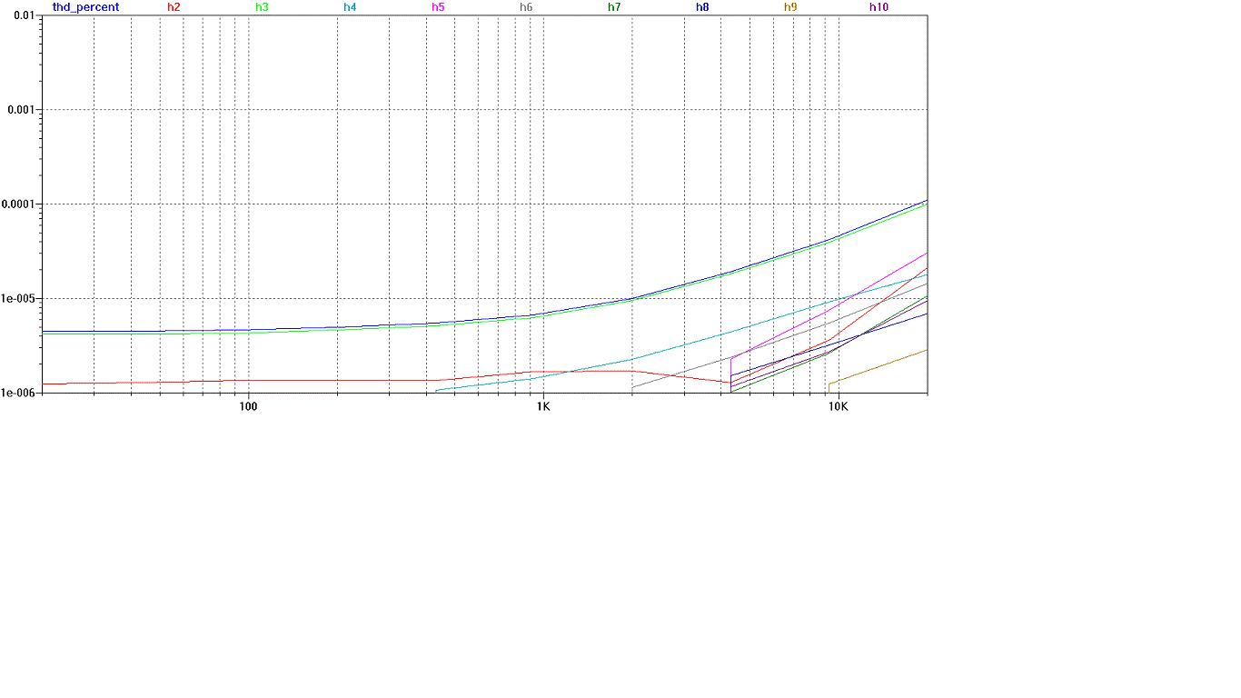

Distortion at 20V into 8R up to 10th harm. using Eugene Dvoskin’s Total Harmonic Analyzer from the LTspice Yahoo Group including stuff from jcx. The distortion residual shows 2 cycles of 20kHz with the fundamental superimposed at 0.01% to give some idea of scale. Ignore the lower freq waveforms. Takes a long time.
- connection between InN and the base of Q3
- U1 the THD meter

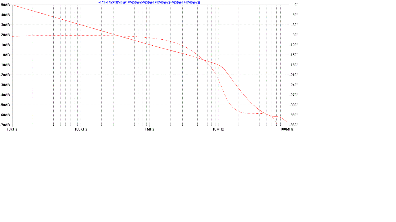

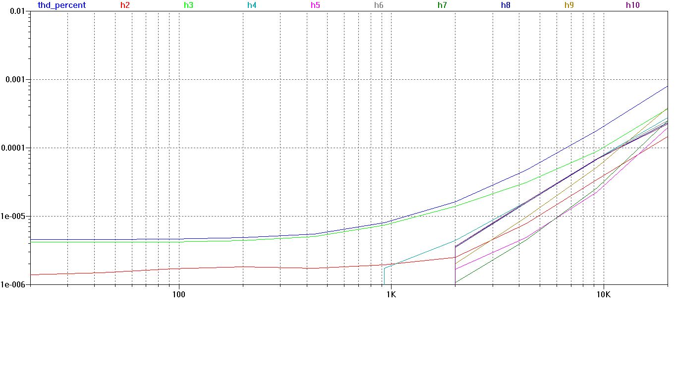

Next, we follow Michaelkiwanuka’s advice and take R23 to the output instead of ground to give Baxandall’s Transitional Miller Compensation (TMC).
I won’t enter the pedant’s debate about the equivalence or otherwise between TPC / TMC but note the final result shows very small improvement in distortion.
Neither of these compensation circuits have been optimised so I invite the various champions to offer improvements for both configurations on what I think is near a ‘real life’ device.

Prof. Edward Cherry suggested Cdom should be fed, not by the VAS collector, but from the output. I think someone calls it Output Inclusive Compensation but I like ‘pure Cherry’ as he not only popularised but also analysed it in various JAES papers.
Various gurus say it is difficult to make stable but in my experience, it is no worse than plain Miller.
Cherry offers the VAS emitter resistor R22 as a powerful tool to control the stability of this local loop. It reduces the transconductance of its input which. if made big enough, will always make things stable. I’ll offer a useful zero by decoupling R22 with C9 in the low nFs.
But pure Cherry is probably too frisky to use with Triple output stages and a supa dupa VAS. Maybe OK for Triples and a single BJT VAS but then its Ccb starts to matter.
This is the fabled 1ppm THD at 20kHz so this performance is well past the stage where layout, decoupling and grounding play an equal if not more important part in THD performance.

- The simple compensation means you can get very good +ve PSR by just adding C1 of equal value to the other side of the current mirror
- R7/8 were chosen to give equal Vce on Q10/11 & J1/2; for a noticeable effect on distortion. A bonus is that these larger resistors on the current mirror give very nice overload and recovery without extra clamps.
- Much less critical of Iq variations
- stability with ‘real life’ power rails.
- Huge bandwidth ... which can be limited by an input filter but I’m nervous. Simple extra stability dodges available which take it out of the realm of ‘pure Cherry’.
- –ve PSR rejection. C11 is at the base of Q1 not for PSR reasons but to ensure clean overload & recovery
- If built, the THD introduced by ‘real life’ layout, decoupling & grounding may swamp the improvement from J1/2 input cascode FETs. However, they may help CMR (and hence THD) if the amp is fed from eg a 10k pot. Remaining THD is mainly 3rd which sorta implies the input. (could be Beta droop in Outputs. Using MJL3281/1302 certainly reduces 3rd
- Better biasing schemes than the simple ‘bias spreader’ though its tolerance of Iq makes it less fussy than eg Self’s fig 6.16 Maybe a crude feedback control mechanism.

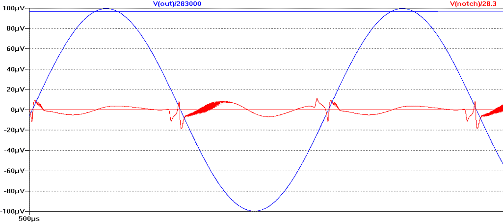

But the effect is usually not subtle. The guitar speaker was one of my standard tests of stability.

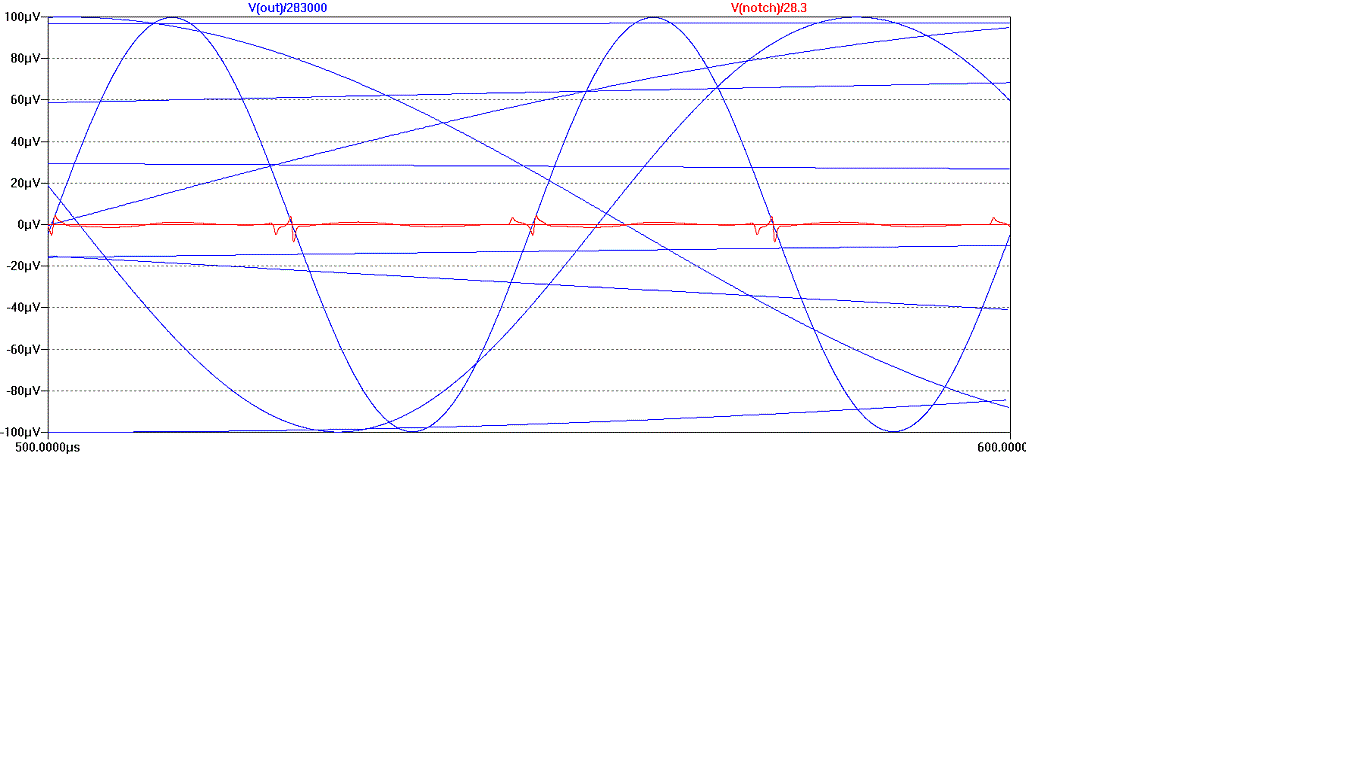

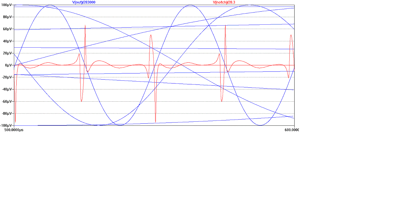

This pic is of something completely different but if you remove the crossover spikes from the red curve, you get an idea of what to expect. Usually only on part of a cycle. It may or may not go away as the amp heats up, cools down, signal level & history etc.
Many (most?) Golden Pinnae amps, especially those without an output inductor, exhibit this often very obvious 'feature'. No wonder they sound different.
A more subtle example may not be seen on a cheap scope. You may find THD becomes very bad on very specific loads when it is excellent on 8R resistors. Curing the instability restores good THD on these loads.
I'm sure Bob Cordell has mentioned this, either in his book or on some thread here.

I think with this type of artifact, you need to identify whether it is loop gain related oscillation, or whether it is parasitic. If loop gain related, the solution is to sort the compensation out. And I absolutely believe in output coils (with 2r2 or 3r3 damping resistors) and Zobel networks ( on the amplifier side of the coil!).
Parasitics are usually a bit more difficult to put your finger on. I have seen the problem in EF3, but the fixes are easy to implement and they work very well. Cascode instability is also another one, as is parameter modulation ( Cob specifically).

Excellent to see such work.
It would be nice to see the Bode plots done so that 180 phase is the same line as 0 dB.
Quicker to interpret, and a sensible standard to simplify comparisons.
Optimised TMC can do at least as well as OIC. At worst the optimisation may end up with a zero ohm resistor to the output and a zero farad capacitor to the OPS input, to produce OIC.

As I said earlier, I've been a beach bum for a long time so can't really do sensible measurements this millenium.... generated by a simulation or by actual measurement?? Can't say I have ever seen this first hand. Makes me want to try your "test protocol". So you are suggesting that this happens into inductive loads rather than capacitive??
The pic is a simulation of something else entirely .. but you asked for something to look for on a scope.
I've seen it on both inductive & capacitive loads.

Bonsai, I obviously have my own ideas but what are your favourite easy fixes to try with 'parasitics'?bonsai said:Parasitics are usually a bit more difficult to put your finger on. I have seen the problem in EF3, but the fixes are easy to implement and they work very well
__________________
I'm a newbie with LTspice and am often frustrated by the auto scaling.Dave Zan said:It would be even better to see the Bode plots done so that 180 phase is the same line as 0 dB.
Main grouse at present is I must show phase from 0 to -360 so can't have it cycle and show +/-180. I tried to turn the Tian probe round but I failed to get that to work. Suggestions gratefully received.
My obvious contention is that TMC has no advantage over 'pure Cherry' and is usually worse.Optimised TMC can do at least as well as OIC. At worst the optimisation may end up with a zero ohm resistor to the output and a zero farad capacitor to the OPS input, to produce OIC.
I'm hoping someone will show differently using my examples. I've made all my models available and the circuit is simple enough not to obfuscate the issue. I believe they are 'realistic'
I've my own opinions re: TPC vs TMC but in practice, there is little difference.
