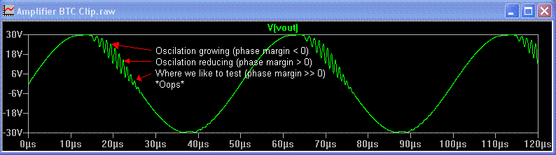

I've found (in simulation) one reason you might get oscillations on part of a waveform. Full story is here. Short version:that's why I am curious as to exactly what sort of instability you are seeing? what would I expect to see on the scope?
A lot of folks test their amp's stability by doing AC analyses (or other tests) under quiescent DC conditions. The problem is that most output devices show a large drop in Ft and beta at high currents. This can cause a significant change in stability margins, or even outright instability. A classic symptom is bursts of oscillation triggered by clipping, as shown below.
I think you're walking into the same trap. Here's a simple experiment: Try redoing the AC analyses of the 3 circuits with a 6A current source connected to the output. Or to be more realistic, just connect a 4 Ohm load to the output, and change the DC conditions to get +25V or +30V at the output.I was hoping some gurus would pontificate on the 'real life' stabilty of the 3 versions I presented.
I'd be interested to compare the results to what you showed in posts 1, 2 and 4.

One reason for my respect for LTspice is that .TRANS actually simulates this very well.godfrey said:I've found (in simulation) one reason you might get oscillations on part of a waveform. Full story is here. Short version:
I don't think you'll see my 3 examples exhibit this cos I check for it. But if you modify them to demonstrate supa dupa THD, please check for it too.
BTW, it was da Golden Pinnae amps which did this .. not my designs, sim or 'real world'.
