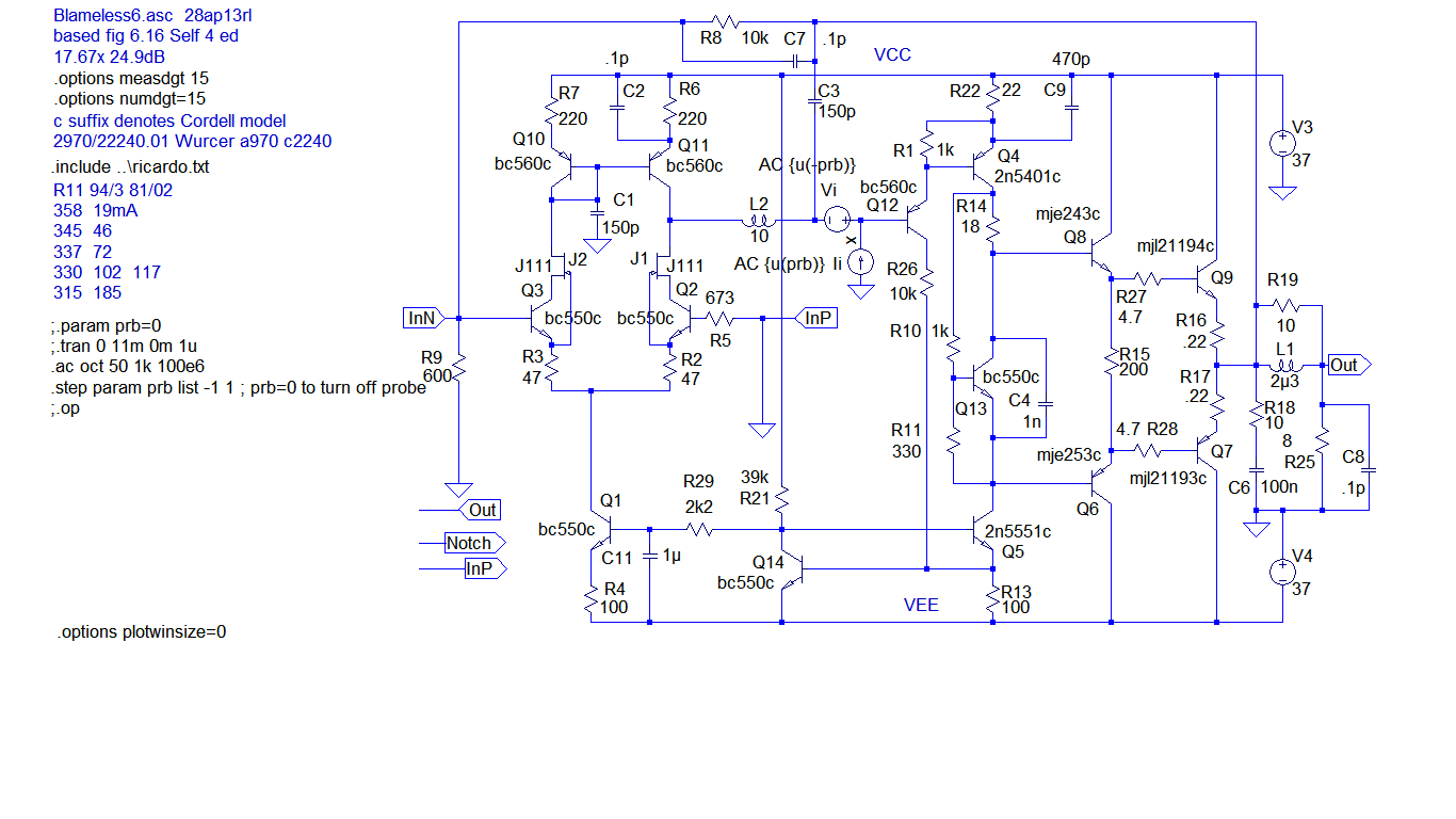

I repeated the sims in posts #84 & 85 with a large inductor breaking the main loop between J1 drain and the input to the VAS. This is in line with Waly's exhortations to check each inner loop without the influence of enclosing loops. David, I hope this new schematic meets with your approval
I'm pleased to find that the stability results, R22=0 Bad, R22=22 Good, are unchanged. So at least for simple power amps like these, unstable inner loops also result in unstable main loops. Waly's evil unstable inner loops hiding behind stable main loops are not here.
I'm beginning to like Nyquist plots even though they are more work .. certainly for tweaking stability .. eg the changes required with different output devices. You get a better feel for what each tweak is doing.

The amplifier is stable also in practice, not although, but because the output transistors are slow.
At the ULGF of 10 MHz (http://www.diyaudio.com/forums/solid-state/235188-tpc-vs-tmc-vs-pure-cherry-9.html#post3480607), with largest device Ft of 6...8 MHz, the output transistors will not really amplify under any operation condition. At the ULGF, they just provide a cut-through via their base-emitter junction resistances and capacities.
I asked in DIYAudio earlier and had no response to the question "How close is a transistor to minimum phase past Ft?"
Later read Dennis Feucht's treatment of transistors past Ft and it is similar to your idea.
If it is possible to run the loop well past the Ft of the transistor then that increases the amount of distortion reduction possible.
...where Bode is sufficient ... and when the full Nyquist plot should be examined....

A practical question that has been raised recently in different threads here is: The theory you just explained distinguishes between stable and unstable. In practice, we would like to have an estimate, *how* stable it is.
With Bode diagrams, we have developped a feeling, how large the margins should be. Now, with multiple feedback pathes, the inner most loop often shows stability margins in the Bode plot that would make suspicious in a simpler system. On the other hand, performing transient simulations, all seems to be fine.
The question is: does the theory you mention give some help to evaluate the safety margins (knowing that in practice all will be worse than in analysis and simulation)? Are we e.g. to apply the same phase margin standards in a system with nested loop(s) as in a simple one?

Unfortunately I am not aware of any general method of consistently determining stability margins in multi loop systems. As I've mentioned elsewhere, something like the minimum phase margin is not correct, as this depends on the order the loops are individually analyzed (like 1-2-3 and 2-1-3).
In fact, stability margins are not directly a topic in the control theory, but more like an engineering quest. There are several more restrictive "engineering" theorems, on of these tells that if the loops have a common node at the output, then all loops can be analyzed in one step, by breaking them at the output node. Therefore the usual phase and gain margins can be determined. While being quite intuitive, the proof for this theorem is not trivial. E.g. this theorem may help in splitting the TMC analysis in a Miller loop and 3 loops at the output node (global, R-C1, R-C2). Because of the Miller ULGF being far away, it is possible to approximate the TMC stability margins by analyzing the 3 loops at the output node (and observe the TPC like phase dip).
Probably, this is the result we are using in simulation with a loop probe between output node and common node of all feedback paths. Exactly here, we now often see e.g. phase margins lower than we would like to.... There are several more restrictive "engineering" theorems, on of these tells that if the loops have a common node at the output, then all loops can be analyzed in one step, by breaking them at the output node. Therefore the usual phase and gain margins can be determined. ...
In this extreme example (http://www.diyaudio.com/forums/soli...nested-miller-compensation-4.html#post3466552), the phase margin is around 60 degree, and even in a conceptual simulation model with only ideal circuit elements, it does not become much larger. On the other hand, transient simulation shows excellent (small-signal) square-wave response *at all circuit nodes*: no overshoots in the wrong direction, no ringing ... (margins of outermost loop are nearly ideal: around 90 degrees, more than 20 dB).
If one simulates, on the other hand, the conceptual model of a standard topology with idealized transconductance input stage, integrator as VAS and a single pole in the output stage, one also can create a phase margin of 60 degree in the global loop. In this case, however, the square-wave response does ring.
This leads me to the conclusion that the phase margins are not exactly comparable. (After all, I would expect that the complete transfer function has to be taken into account.)

If I may ask the question, 'Why are we obsessed with Phase & Gain Margins?
ANSWER : we want to see if the system
In da old days, Phase & Gain Margins were used cos other investigative methods might lead to the device (eg an amp) giving up the Holy Smoke.
But in da 21st century, we have much better tools like LTspice.
If we want to look at overshoot/peaking today .. JUST CLOSE THE LOOP and look at overshoot/peaking This has the same info as Loop Gain Bode plots & Nyquist .. except it gives us DIRECTLY what we want.
Remember, we only want to know how close Nyquist gets to (-1,0) cos this is inversely proportional to peaking.
For device, load variation, just CLOSE THE LOOP and vary your device parameters and load ... just as you would do in 'real life' for a production item. Doing this even crudely tells you useful stuff .. even if you can't do full Monte Carlo.
And of course 21st century LTspice has .TRANS which lets you look at stuff which was definitely Holy Smoke in da old days.
my usual disclaimer that Bode/Nyquist still useful if yus trying to improve stability .. even if the Phase/Gain margins dun haf much significance in themselves ..
Cherry 1982 talks a lot about 'insight'. Our models will never be exact. But good modelling gives us a better idea of what is going on and what to do if something is not quite right.
You know when your model is becoming useful when it simulates stuff and changes that you see in 'real life'.
