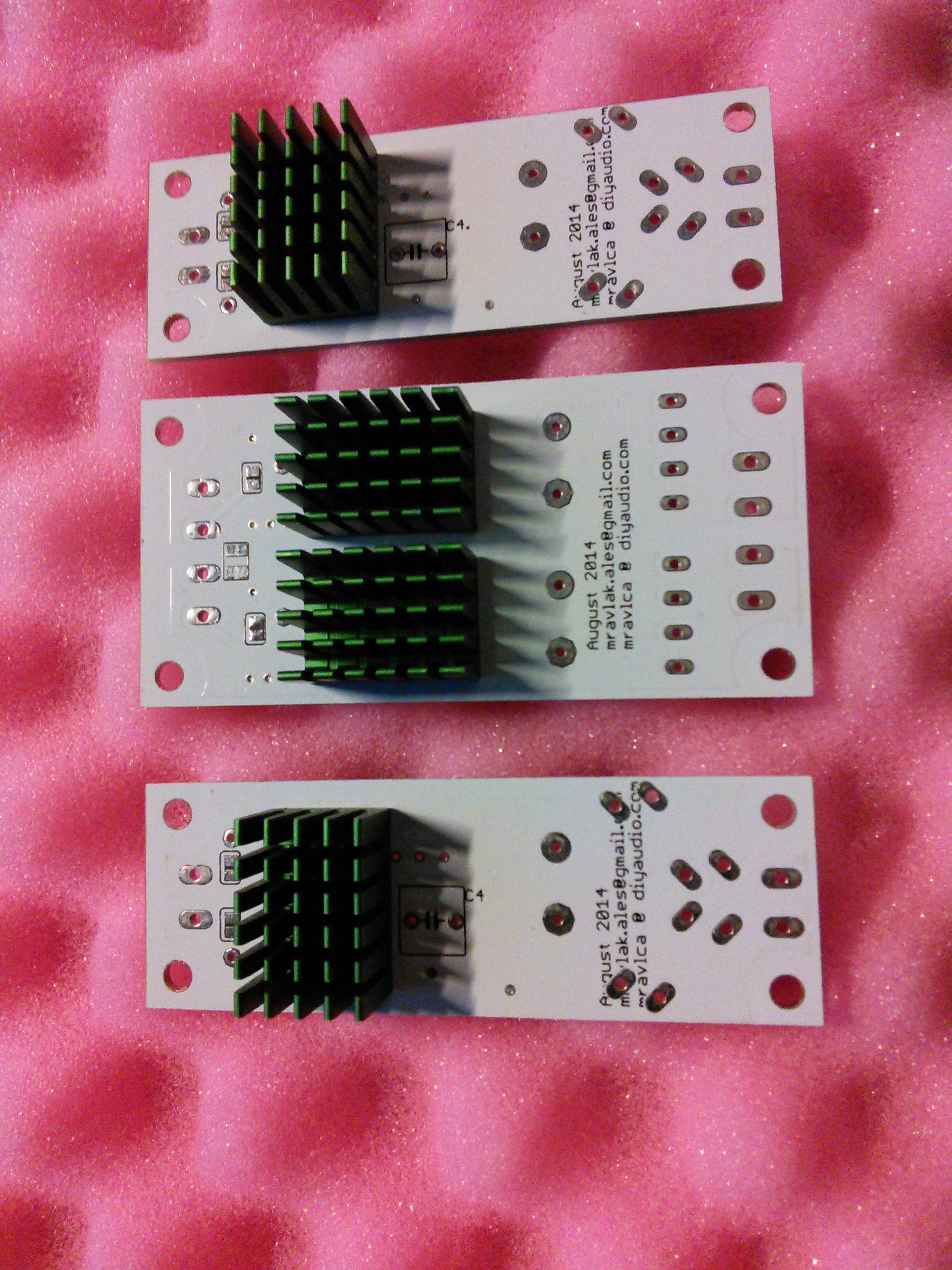

I have busy lately and I have built some PCBs with TPS7A4700 regulator. This is a low noise regulator with output capable of 1A.
Specs
Input voltage range: 2.2V to 25V AC, 3V to 36V DC
Output voltage range: 1.4V to 20.5V DC
Output voltage noise: 4uVrms (10Hz, 100kHz)
Dropout voltage: 350mV at 1A
Output current: 1A (with sifficent heatsink)
More details
-Output voltage is configurable via solder jumpers
-Sensing pins for better performance, DUAL PCB has sensing for positive voltage only, SINGLE PCB has sensing for positive and negative voltage, if not used they can be bridged to output via solder jumpers
-DUAL PCB can be easily configured to operate in symmetrical or single voltage output (solder jumper), transformer with dual secondary windings is a must when you use symmetrical output
-SINGLE PCB can have better capacitor in sensing circuit, there is space for 5mm lead spacing capacitor (for example: Wima 1uF/63V PET)
-DUAL PCB uses bridge rectifier, SINGLE PCB uses rectifying diodes to convert AC voltage to DC voltage.
-user can fit 0805 LED diode and dedicated resistor to indicate working state of regulator
PCB size & colour
-DUAL PCB: 77mm x 37mm
-SINGLE PCB: 75mm x 26mm
-all PCBs are in black colour
What is in the offer?
TPS7A4700 single voltage output 21€
What do you get for the price
Single PCB with smt components soldered on 1pcs
SBYV27 rectifying diode 4pcs
Epcos 1uF/63V PET capacitor 1pcs
Screw PCB connector 2pcs
attached aluminum block 1pcs (works as heatsink or heatbridge)
M3 nuts 4pcs
standoffs 4pcs
Panasonic FR capacitor 1pcs
Shipping & fees, payment
Priority shipping worldwide for one PCB is 3€,for each additional PCB you'll have to add 1€. I accept only PAYPAL, fees are included in the price. You'll receive invoice for what you are buying.
Price calculation examples:
1PCS single PCB + shipping = 24€
2PCS single PCB + shipping = 46€
3PCS single PCB + shipping = 68€
...etc
Best Regards,
Ales

Does that mean that dual PCB will be able to handle 2A current ?
What is the price for Dual PCB ?
Kuni
Hi Kuni,
depends how you look at it. Dual PCB can handle 1A per voltage rail, so 1A for +12V and 1A for -12V. Price for one is 35€ and with Panasonic FR is 37€.

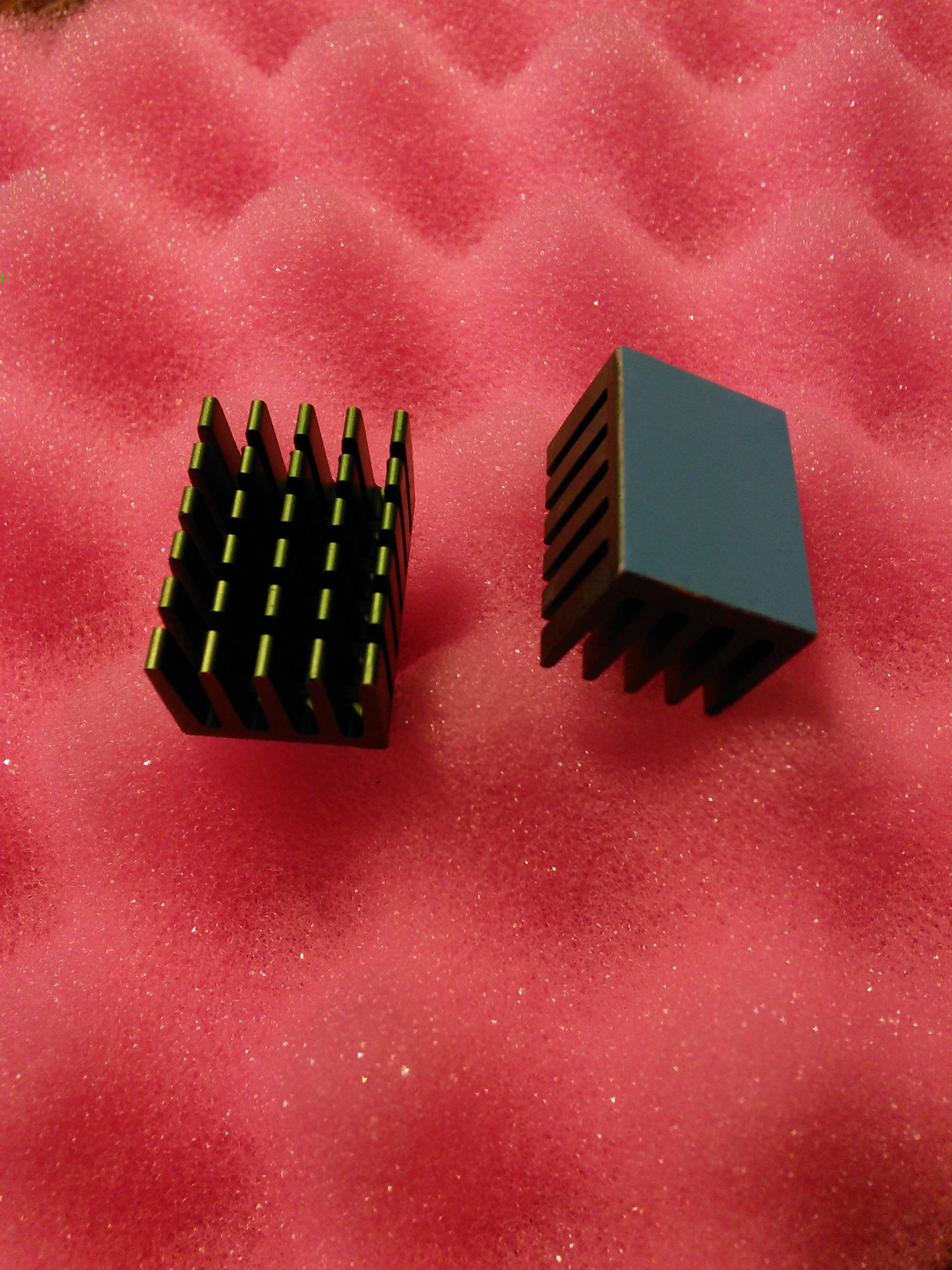

Hi Ray,
thank you for your comment. I am currently working on a simple guide how to setup output voltage, what transformer to use and the purpose of those aluminum things etc... That aluminum is meant to be used as a heatbridge but I need to buy some standoffs to make presentation correct.
Best Regards,
Ales

Thanks Ales, it looks like your on the case...
I had assumed the aluminium thing was to couple the regulator chip to the chassis or a heatsink, sandwiched under the board. The standoffs will hold it in place right?
Ray
Ray
Yeah, standoffs should hold it in a place, but you do need to use silicone thermal insulator pad between PCB and aluminum. You can also fix it to base with screw, the hole needs to be of 6mm diameter.

Hi Ales,
Received the package. Looks very nice! I'm thinking of using smd cap for c4. What do you recommend in place of epcos/wima? Thanks.
Best regards.
Darrell
Hi Darrell,
Thanks! I recommend you to use 1uF X7R 25V 0805 size, any manufacturer should be ok. Don't use X5R because it has lower temperature rating.
Best Regards,
Aleš
