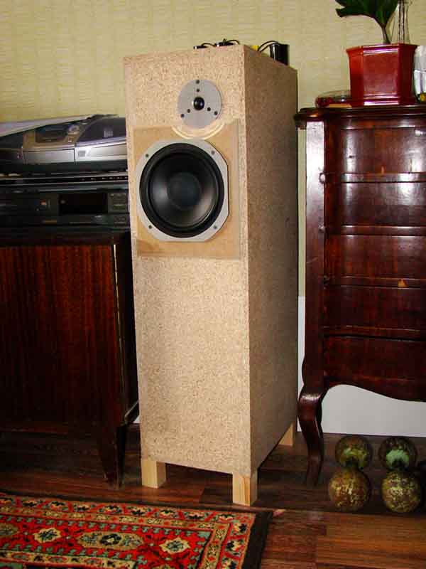

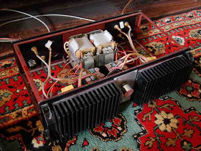

Nelson Pass said:
Anybody got a current drive loudspeaker out there?
I am using the current drive system over 5 years.
