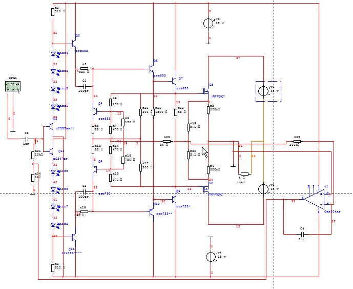

Yes, I have seen it, as it was published on Internet.
It helps me a little with crossovers and with understanding what I am pushing in right direction.
With it I could check my own opinion, as unite the stuff
in a system. But schematics of my "current drive" amps
are different from yours. I have two ones.
Soon, I wiil open my report on the subject.
ahem... in the real world there is no such thing as "infinite impedance".menekken said:is your amplifier a real current amplifier with infinite impedence response from 20 to 20000 hz????
A (real) current source is anything where Zout > Zload. A good one is when it's not just ">" but ">>" (that in practice usually means at least one order of magnitude larger).
menekken said:great!!!
i'll wait for your schematics!!
Yes, it is a real current amplifier with infinite impedence response from 20 to 20000 hz. You are quite right.
You are quite right too.

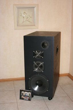

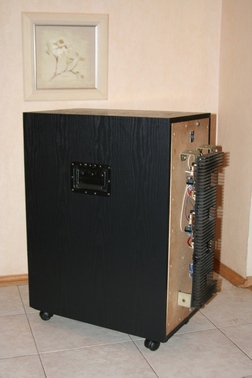

This is my 3-band loudspeaker with current-drive amplifiers.
I have applied a modification of the classic JLH amplifier class A as Hi & Mid current-drive amplifiers. TDA7293 is a low frequency amplifier now, but it isn’t in current-drive mode. I’ll use current-drive mode for Low Fr. with a mechanical FB.
