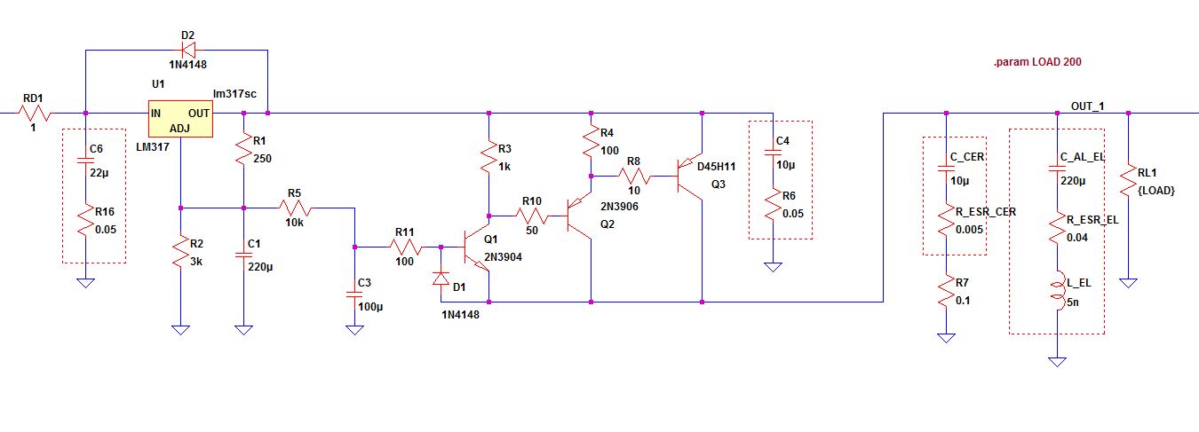

I recently came across this little circuit for improving an LM317 output to seriously low noise. It was developed on a russian forum and was shared by traktorist3d on the Miro AD1862 thread. He also does a dual rail version.
The transistors Q1 and Q2 are actually sot32 and are mmbt3904 and 3906. I'm struggling to find the D45H11 in stock anywhere I use.
Maybe one to consider for the low current draw rail on the amp?

Hi Jim. I have some D-Noizator PCBs but I think they would be overkill for Richard's little amp and if I wanted to upgade from the LM317 I would be more inclined towards something like this;
