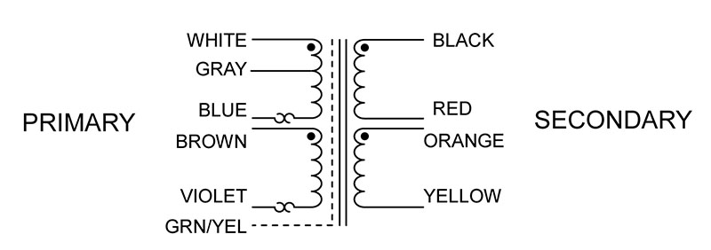

He was indeed referring to the gray tap on the primary, not the green/yellow ground wire.

Use gray/ blue for a lower line voltage.Hello, I ordered a pair of Triad Magnetics transformers but am unsure of what to do with the gray line illustrated below. I haven't seen that before on a primary winding.
Thank you.
Cut it off close (but not too close) and cover with heat shrink? Usually I connect unused taps to a terminal that goes to nothing, in case I want it for a different configuration later. Then heat shrink it. Start playing with tubes much and you’ll have all sorts of unused taps. And you might wish you had them back on another project.
Hi, yes I've read it (data sheet link below). My question remains what to safely do with the grey wire as I will be wiring primaries for 120v. For 120v the data sheet instructs you to "Input to White & Blue, jumper White & Brown, jumper Blue & Violet" but it does not reference what to do with the extra grey. wire. Thank you.
https://www.mouser.com/datasheet/2/410/VPM24_2080-844679.pdf
In the case of 120v primary wiring, the grey tap is unused but must it be insulated, as it will be live with 100v when the transformer is powered.
You are correct, the data sheet does not indicate this, but it should. Good catch.
It's there so the transformer can be used in countries with 100v power, like Japan, and others with 220v.
Best of success with your project.
If the data sheet doesn’t tell you to hook it to anything, it can be ASSUMED that it’s not supposed to connect to anything. All mains connected anything needs to be insulated for mains voltage. Connecting to an otherwise unconnected terminal gives it somewhere safe to go, so its not flopping around loose.
