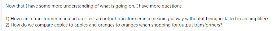

Now that I have some more understanding of what is going on, I have more questions.
1) How can a transformer manufacturer test an output transformer in a meaningful way without it being installed in an amplifier?
2) How do we compare apples to apples and oranges to oranges when shopping for output transformers?

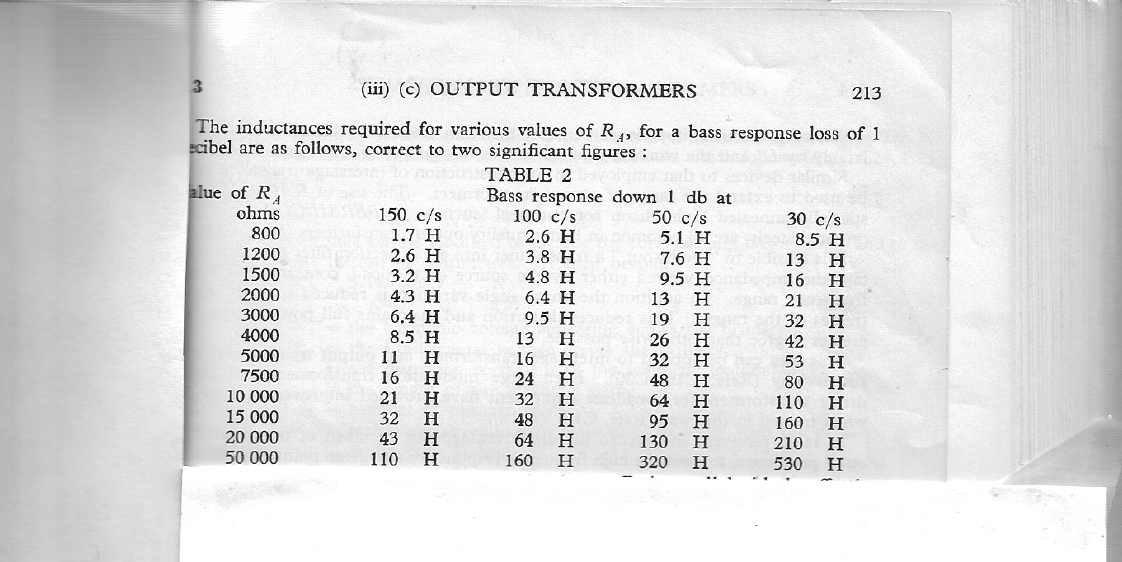

Someone posted this table here on the forum (I think). Does anyone know what book this is so I can read the rest of it? Books like this usually contain example calculations, and those always help me greatly.
In your case, you would pretend that the secondary load is a resistor of value marked on the OPT spec, so the OPT's contribution is its rated 6000 Ohms. Pentode output valves can be approximated, close enough for rock and roll, as infinite, so you end up with the numbers you originally calculated! This is also the worst case for primary inductance requirements. Triodes relax the requirements (from a frequency response standpoint) greatly.This also makes sense, but I'd need an example to be able to perform the calculations myself.
That page is undoubtably from RDH4.
Oh, how perfect!
Got it. Page 213 exactly as you said! I wish I had time to read and understand that whole book. I do want to read this part though.
Link for anyone who needs it. http://tubebooks.org/Books/RDH4.pdf

And now I come back to these:
That makes sense, but I don't recall "primary inductance" on any spec sheets. I'll look again. Maybe that's something studied only by transformer designers. When a transformer manufacturer just specifies "inductance" what exactly is it that they mean?

And therein lies one of my (our) problems:
It seems to me that this is impossible for off-the-shelf transformers. In other words, trust the transformer designer to do it right and bigger usually is better but not always, up to a certain point of diminishing marginal return. Then test it in an actual amplifier and if it ain't right, either provide different transformer specs to the transformer maker or change the amplifier or both.
It is possible to dodge most of the impossible tradeoffs by using two cheap, crappy transformers instead of a single SOTA, super good one.
The low frequency is handled by a big lump of iron, which doesn't require complicated winding techniques to reduce the leakage inductance and could even be an ordinary 50/60Hz transformer, and the high frequency part is processed by a smallish ferrite transformer having negligible capacitance and leakage inductance.
The composite result is a very good transformer, and the additional costs and components add up to a much smaller cost than a very good, traditional transformer.
