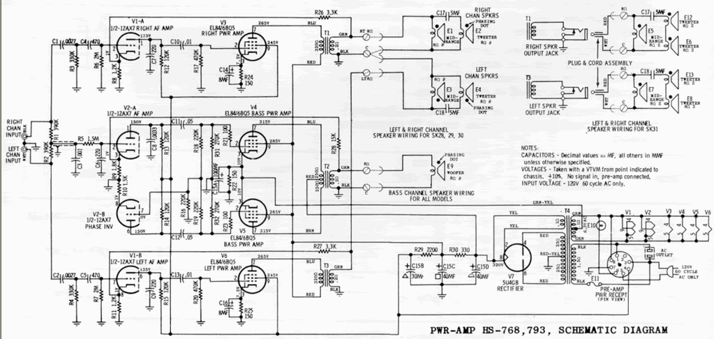

Console manufacturers used this idea in the ‘60’s. Such as Motorola HS-768, where higher frequencies were amplified in stereo by EL84 SE amplifiers (filtered before amplification) and LF amplified by a single PP EL84 amp with much heavier transformer.It is possible to dodge most of the impossible tradeoffs by using two cheap, crappy transformers instead of a single SOTA, super good one.
The low frequency is handled by a big lump of iron, which doesn't require complicated winding techniques to reduce the leakage inductance and could even be an ordinary 50/60Hz transformer, and the high frequency part is processed by a smallish ferrite transformer having negligible capacitance and leakage inductance.
The composite result is a very good transformer, and the additional costs and components add up to a much smaller cost than a very good, traditional transformer.
