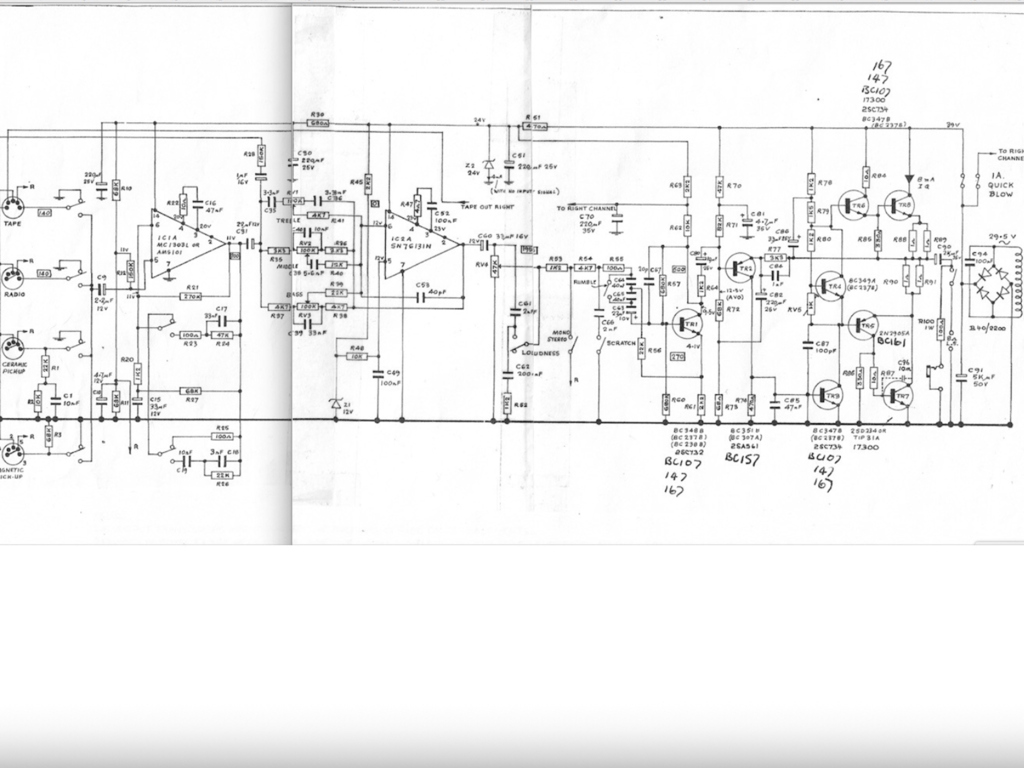

Normally if a fuse blows on an amp circuit I would normally assume all the transistors are suspect, and replace them because of the possibility of "hidden" damage. By running the amp with a shorted Tr5 other devices may have been partially damaged. It is possible that the pnp input device is suffering due to a reverse base-emitter bias and has a gain loss.
The only way I would consider re-using a device is if it has passed all checks compared with a new component. That usually takes time and by the end of the exercise, finding it doesn't is a worse waste of time than just plugging in a new one. In your case, I would be curious to know if the pNP input transistor - or the NPN driver - have a gain loss. Does your DMM have a transistor gain test socket? You may not have the original info but you might see if the gain is lower than you would expect.
To check the gain of the individual channels you need to make sure that the input signals are the same. It may be that the transistor in front of the main amplifier (TR1?) is not behaving, but that may be due to the switches not working as there are quite a few to select options. With the mono/stereo on mono do you measure the same voltage at the inputs to the two channels (preferably with both fuses intact)? - that is on the collectors of the Tr1's. (You might want to make a temporary AC probe using (say) a 1uF capacitor and 100k resistor attached to the collectors to isolate the DC before measuring the signal on your DMM. Connect this temporarily (without shorting anything else - you've had enough of that!) before turning on and allow a few seconds for the capacitor to charge., then measure the volts acros the 100k. If you've managed to create a simple sinewave generator, that is, to provide the input signal.
I replaced both TR1s and TR3s with BC237Bs and also replaced the TIP41Cs on the left channel just because it was easy while I was at it, and they only cost pence.
Switched on and what a difference! Both channels much louder at less than 2 on the faders than the left channel had been at maximum. So much so that I swapped R20 back to 1K2 from 470R, resulting in very firm and dynamic sound at level 3 - far better and much louder than before, and still not getting too hot. I haven't had time to take more measurements as I have had to come away to help my parents with hip operation stuff, but I have kept the old transistors for whatever analysis I can carry out. I had to do a slight adjustment to bias on the left channel to avoid distortion, and I have the feeling that the right channel trimmer doesn't alter anything, but I will take measurements when I can get back to it and report back.
Once again, many thanks to all for the help, advice, thought and hard work - I'm sure guiding me through this has been like pushing a double decker bus with flat tyres across a ploughed field, but it is really very much appreciated!

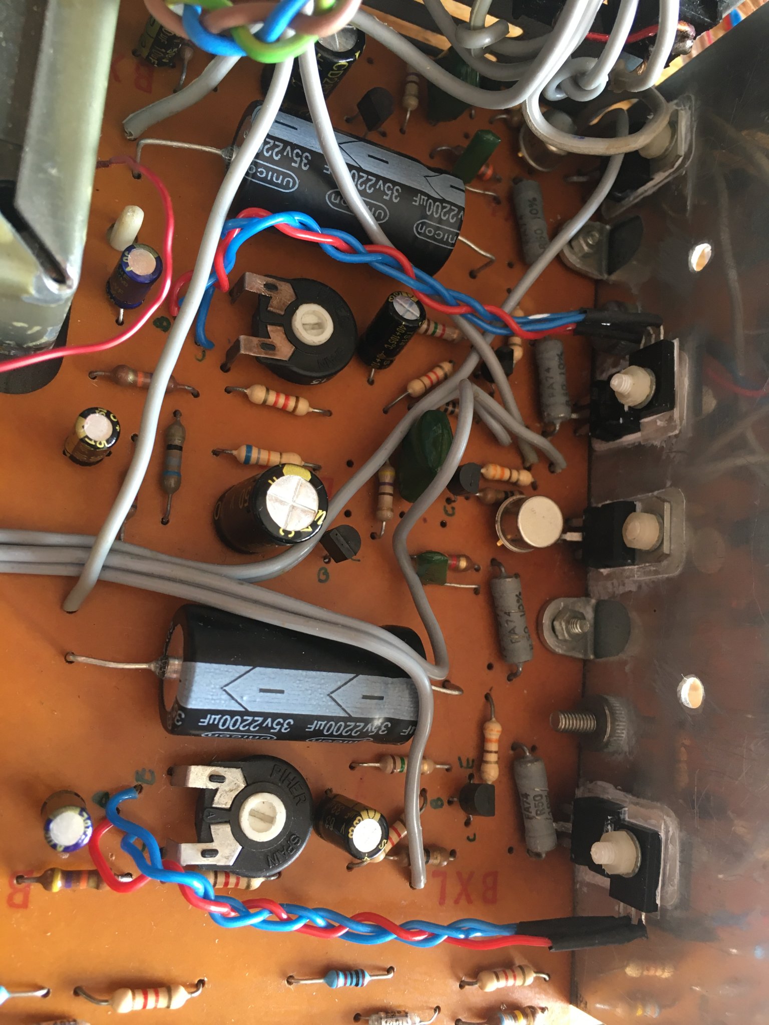

I re-fitted the BD139s, attaching them to one of the output transistors
The difficulty with setting bias continues, however. If I set bias to be the same on both channels, the left channel is very distorted until I increase it.
This is the right channel (sounding good)
And here is the left channel (sounding good)
There is a slight rustling background noise on the left channel which doesn't vary with volume.
There is also some mains hum which goes if I touch the chassis, but I assume that this is some grounding issue - I'm not too concerned, as the only place I can plug it in here at my parents' house is on a multi point extension lead which also supplies pc, router, monitor etc. I can investigate later when I know I have a cleaner mains supply.
Any ideas about the right/left discrepancy? I didn't replace the left channel output TIP41Cs after I blew up the right channel, so maybe I should?(when I can get some - Cricklewood Electronics is a long way from here)

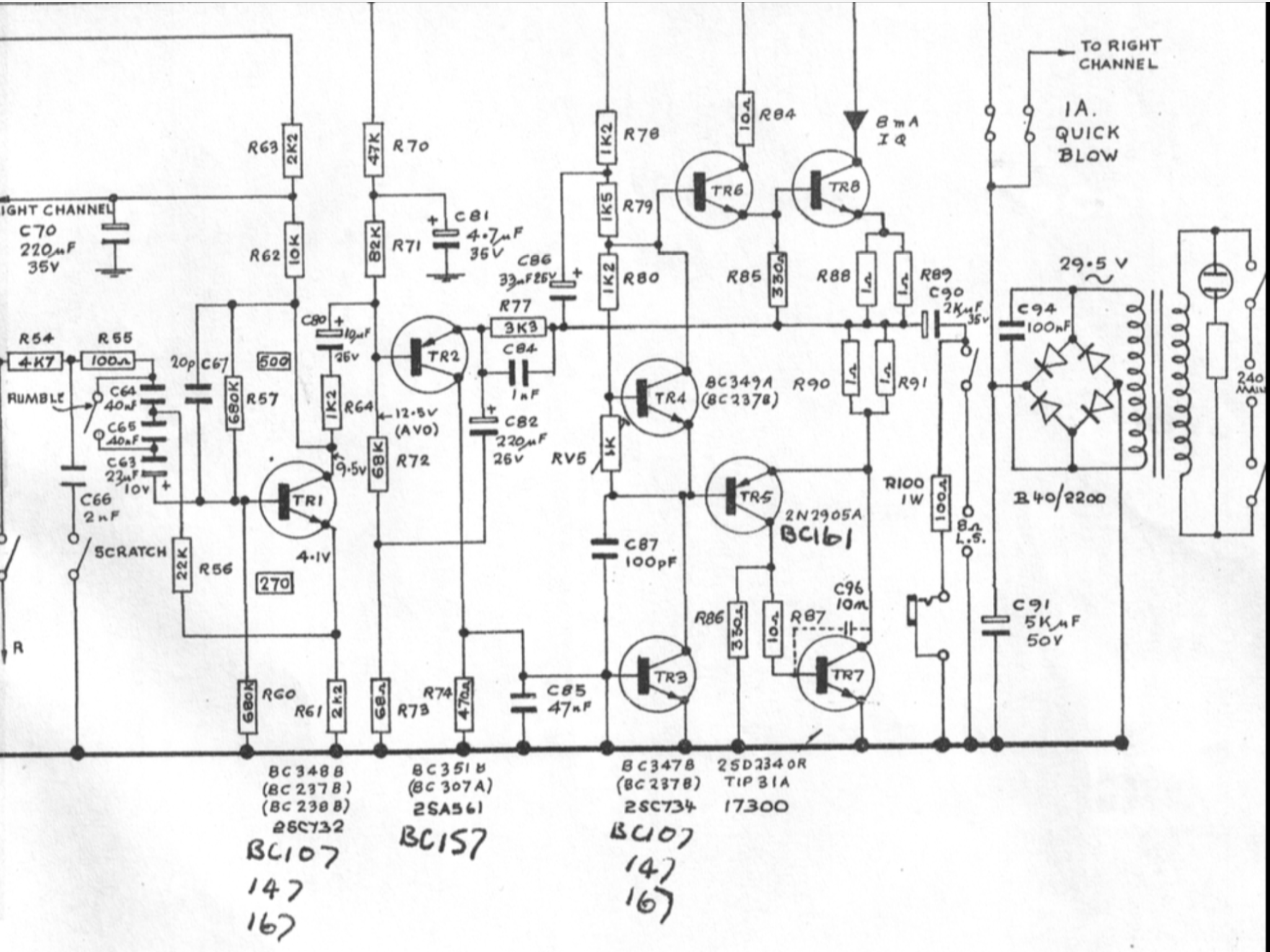

The BD139s added onto the heat sink are TR4 on the diagram - Vbe multiplier.
I have taken some measurements - on the above diagram at TR1 the emitter is marked 4.1 V and the collector 9.5 V
I have 2.47 V left channel and 2.36 V right channel at emitter and 8.55 V left channel and 8.91 V right channel at collector.
Base of TR2 is marked 12.5 V I have 13.04 V left channel and 13.3 V right channel.

I'm a little concerned that you didn't start at the beginning again before moving your BD139 to the heatsink.
So,
The voltages on Tr1 are a concern to check because the diagram voltages usually indicate typical voltages. While the operating voltages are not outrageous and may depend on the actual supply voltage, the differences may indicate trouble like oscillation. That comes back to whether you have an earth loop in your set-up, or improperly earthed or screened cables, perhaps.
Can you repost the whole diagram as if there is an input to Tr1 signal it might be possible to connect an earthed input to see if your noise goes away, to skip the preamplifier section.

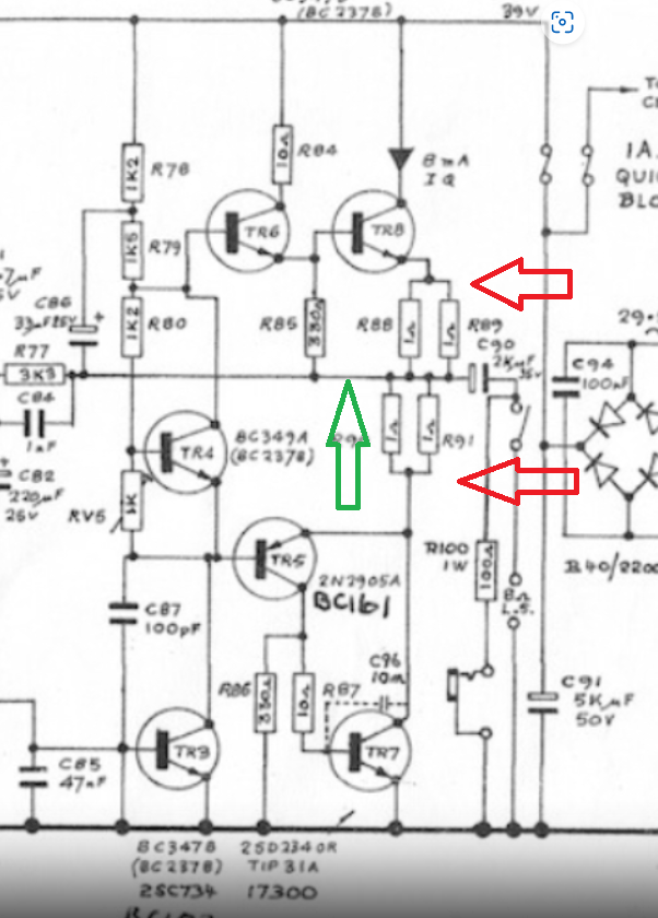

I'm not sure where you are up to with this either.
1/ What voltage do you measure between the two arrows (red). That voltage allows the bias current to be calculated. Measure on both channels.
And:
What voltage is needed between those points to get the left channel to sound clear?
2/ Now measuring from ground, what voltage do you see on the green arrow point. This should be approximately one half of the total supply voltage.

Can I suggest that you measure the voltages across both of the 0.5 ohm (the parallelled 1 ohms) as a further check (i.e. between the red and green arrows)?
It may indicate if there is a significant imbalance in the two halves as they would be expected to be the same. They may be, but it may offer a clue if not.

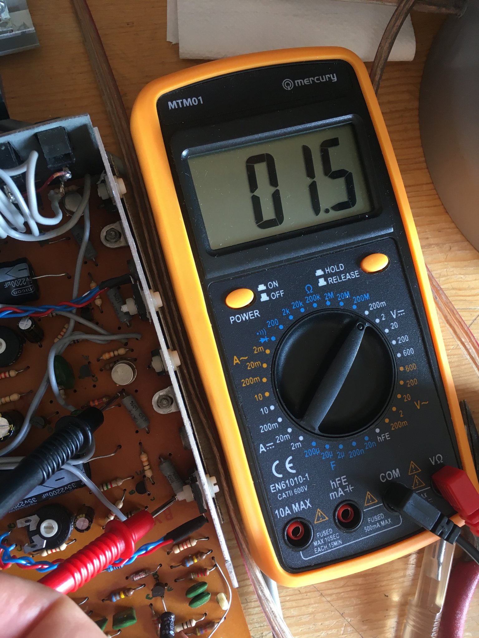

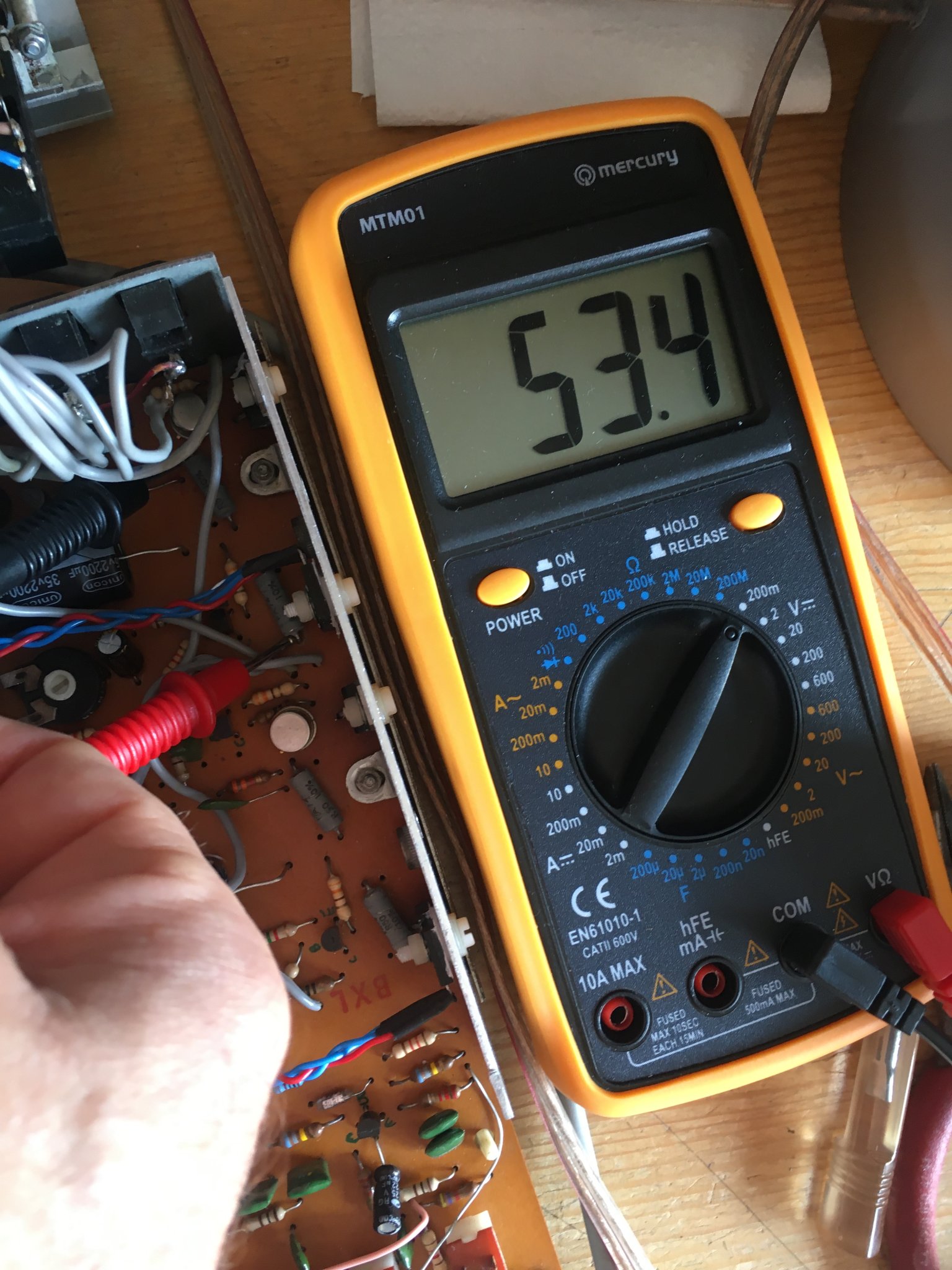

My board doesn't actually have two pairs of 1 ohm emitter resistors, but two single 1/2 ohms, but the readings are:
Right channel - 9.2 mV across both, 4.5 mV across each individually.
Left channel - 128.6 mV across both, 63.8 mV and 64.9 mV individually. This is the point at which the sound is no longer obviously distorted, but if the bass tone control is raised it distorts - this is not the case on the right channel.

I've managed to get a few more measurements, but I may not be able to get back to it for a few days due to care duties, so if I go silent I'm not being rude, just busy elsewhere!
Emitter resistors all measure 0.5 ohm
Measurements at base of transistors is as follows:
TR2 L - 12.9 V R - 13.2 V
TR3 L - 0.6 V R - 0.6 V
TR4 L - 17.4V R - 18.26 V
TR5 L - 17.5 V R - 18 V
TR6 L - 19.5 V R - 19.5 V
TR7 L - 0.6 V R - 0.6 V
TR8 L - 18.8 V R - 19.4 V

TR6 and TR8 voltages might show a problem.
The base of TR6 should be around 0.6 volts higher than the base of TR8 and your measurement shows just 0.1 volts difference.
First suspect would be either a solder blob between B and E of TR6 (measure on ohms to see if there is a short) or a faulty/incorrectly fitted TR6
