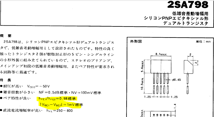

BTW, devices like 2SA798 have their emitters connected internally, making them useless for a modern circuit.
Very small package though. I can do SOT23 by hand and make it look ‘acceptable’ but the 5 pin versions and SOT363 are a step too far for me
