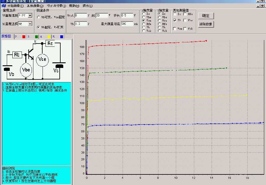

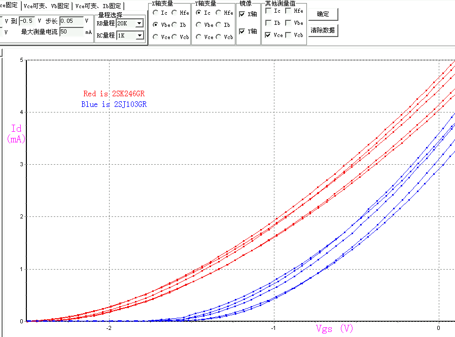

My intelligent semiconductor characteristic curve project
I use LTC1090(ADC) and M62359(DAC) with C++Builder software develop this curve.
It can measure PNP or NPN and N(P)MOS ,JFET,zener/diode/3-termination Reguregulate / opto-isolator
can draw Vce(Vds)->Ic / Ic->Hfe / Vbe(Vgs)-Ic / Ib->Ic / diode's Vd->Id / 3-termination Reguregulate's Vi-Vo, Io->Vo curve
such as the NPN£¨2SC3519£©Vce->Ic curve result is below
