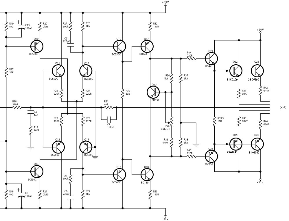

For wg_ski and john_ellis, I begin to draw the schematic of the amplifier, (not finished) and it seem to me that the BD441-Bd442 are pre-driver, not VAS.
For Nareshbrd, the bias are ok, but the four output transistor of the amp are place between the heatsink and the PCB and it have a very poor heatsink,
too thin. Also I leave them always on.
It is possible for me to have some BD139-16-BD140-16, but the BD441-BD442 are a no go. I need to find a good substitute for the BD441-BD442,
so, in the same time why not to change the BD139-16-BD140-16 for something more actual.

The BD139/40 are in the VAS position, and run at around 20 mA. That will be hot enough that you will sit up and take notice when you put your finger on one of them. With that much emitter degeneration it’s not likely to run away, but at almost 1 watt I’d put a small heat radiator on each.
The 441/2 are in the driver position - no “pre drivers”. With that 18 ohm bias resistor between them they will run HOT at over 2 watts apiece just idling. They often do this with BIG amps to keep switching distortion low when driving a big bank of outputs, and when they do they put them on the same heat sink with the outputs. If I was going to run them that high I’d be using MJE1503x and using pretty good size heat sinks or on the output heat sink. MJE243/253 is certainly possible but I’m pretty sure the 1503x are going to be easier to get.
Thanks for the circuit. I agree with wg_ski that sometnhing like the mJE1503x would be better. The BD441/442 are only 3MHz type devices and not really suitable as drviers in a hifi amp anyway.
Due to the high dissipation as mentioned the devices really should be on the main heatsink. IF they're not, the high dissipatoin will mean they get very hot and that means the bias stabiliser can't do it's job properly. On the other hand I have found the bias current of a EF2 to be reasonably stable when the drivers and output are on the main heatsink, along with the bias stabiliser. I would also recommend the non-insulated version and mica+silicone grease or one of the new highly thermally conductive silicone washers as the thermal resistance can be, with good mounting, lower than those devices fully insulated.

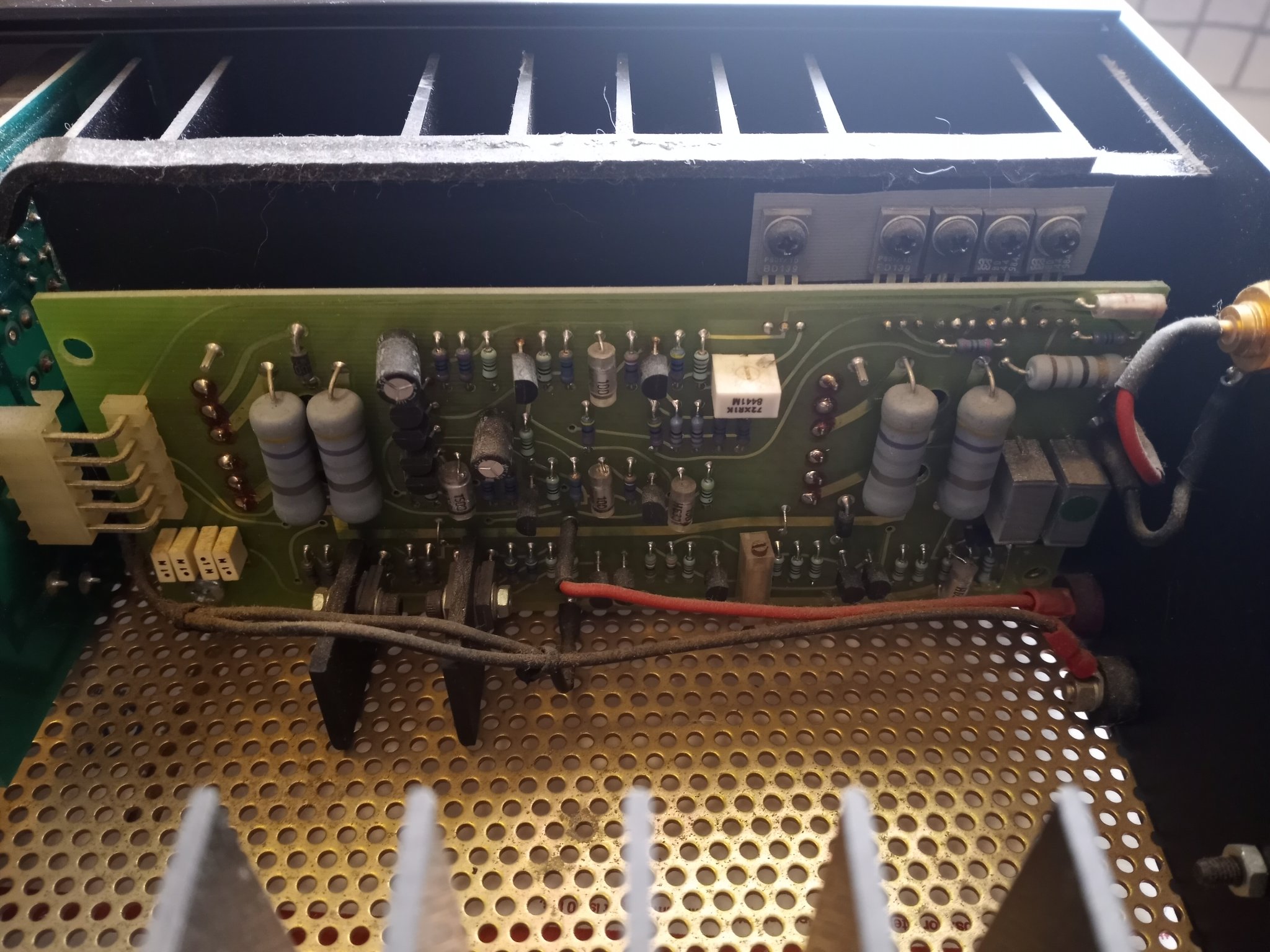

Here's a picture of one channel as requested. The output are under the PCB connected with the wire a the upper left of the picture.
The BD 139/140 and the BD441/442 are at the upper right of the picture.

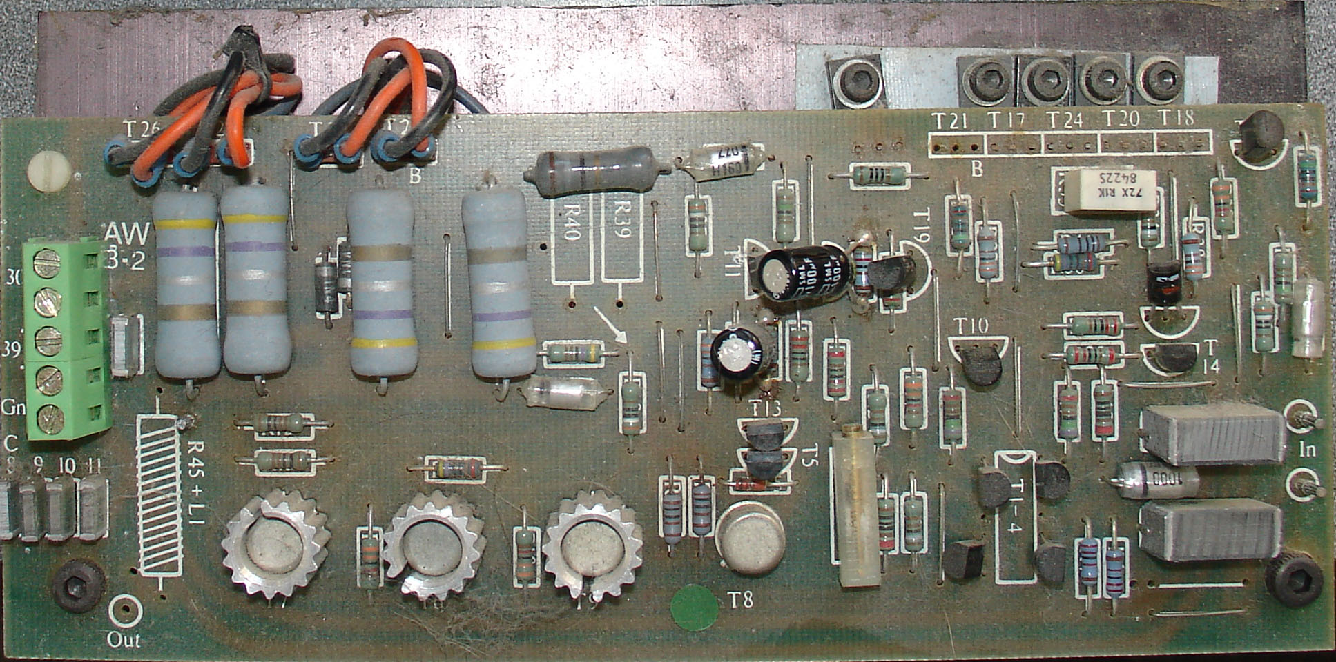

A more recent board of the same amplifier, The TO-39 transistor BC141/161 was replaced with BD139/140, and the output transistors connections are now integrated in the PCB
