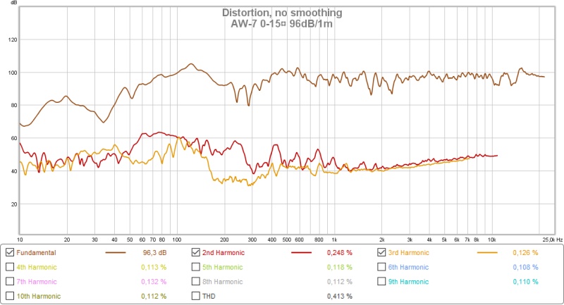

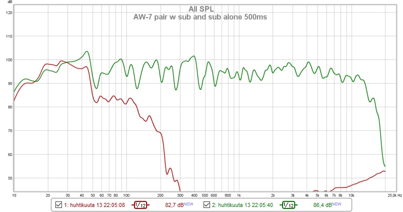

i have made 5 pcs with the bigger 6½" T18 in sealed box. Decent bass when positioned near the wall or in a bookshelf (or table as nearfield) I use them in HT setup with 2x15" subwoofer. Recommended! I have never seen or heard the smaller L12 coax.

SEAS Loki is bass-reflex, but one can use a bit smaller sealed box, when subwoofer is included in the system anyway.

My version is not Loki, but Finnish Audiokit AW-7, with alu tweeter. Xo is different as well. Xo tweaking is easy...
L/C/R speaker similarity is most important in HT systems - response and phase must match, to get good imaging and localization of sound.

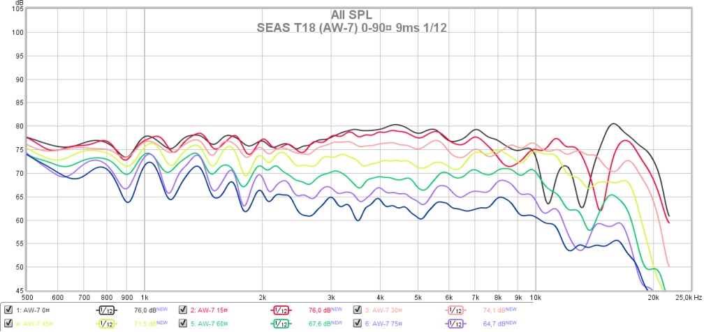

Measured dispersion of my AW-7. On-axis looks nasty, but at 10-15deg response and LW is smooth as baby's butt!

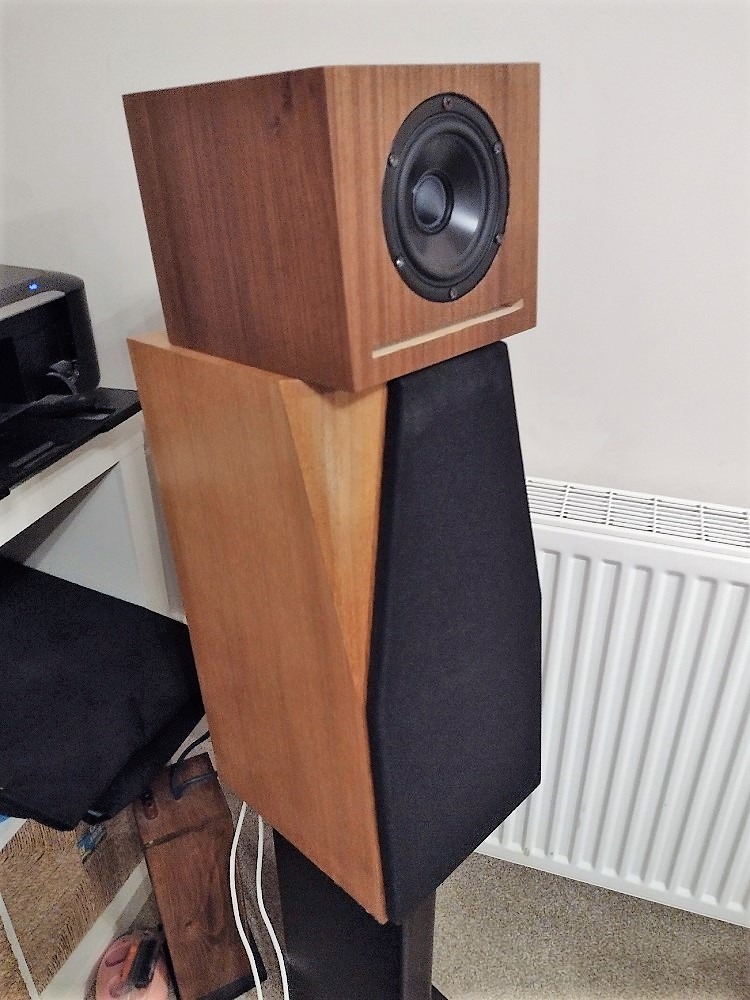

Sorry I'm late to the party but I've also made a pair, I got a chap on eBay who makes small single driver cabinets to make some boxes to the SEAS design document. Only cost around £100 so a good buy
I have to say that they sound astounding considering the size of the box. They aren't perfect, as you can't drive them stupidly loud but I'm getting good levels (not headbanger) in a 6m x 3.3m room. This is with a KT88 PP valve amp.
I finished them recently and attach a picture of them on top of my usual stand mounts. The camera angle makes them look bigger than they actually are.
I went for external crossovers as the cabinets are very small. The drivers are good enough to warrant foil inductors and Russian paper in wax capacitors. I went for the standard SEAS crossover implementation and (in my opinion) it sounds very good.
If you want maximum WAF in your life then they are well worth considering. I'm trying to go the other way and get some ESL57's into the living room, but these will do very nicely in my workshop.

What are the Seas coaxes sitting on? Those look like NHT C3s but in a new finish.
