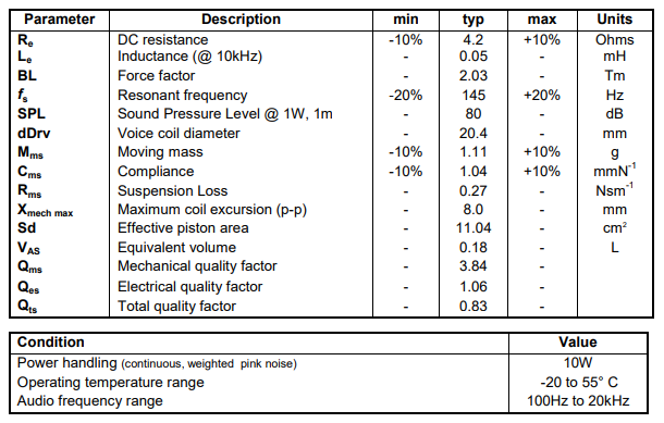

But does anyone have an educated guess what the power handling (as little as that probably means 🙂 ) would be on the TEBM35C10 if used only above, say, 1kHz? Is the power limit due to excursion capability or thermal, or something more insidious?
Interested in this as a possible ambience tweeter because of it's wider than usual HF radiation pattern. And because of size and price.

Hello Bill.
I have done some testing with this little one in the past.
They sound horribly distorted under 400Hz, but very nice above that. If you were to use them from 1kHz and up, I'm sure they could take some heat, at least more than the rated 10W... Also, being so small, they are not well ventilated, but since you are not using them anywhere bass range, it should be fine.
I used a 4th order at 500Hz and I was able to get some spl by pushing them a bit. They are not meant to be loud, but as ambience tweeter, they should do fine indeed.

Thanks, perceval!
I got some on order. I will probably use several per channel to get the level handling and room distribution up.

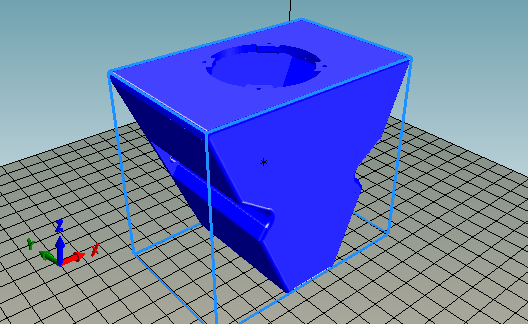

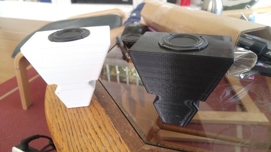

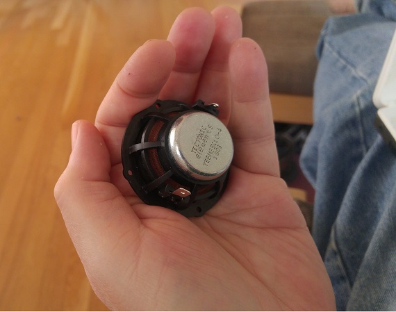

Getting there. The BMR drivers came in and I 3D printed a few little enclosures for them to try out, maybe later today. A printed box is about the only practical way to mount these little suckers if you plan to use the tiny mounting holes, the cutout is pretty complex and not much room for error. Of course, if you plan to use wood and construct by hand, you could just cut a 46.5mm dia hole and use silicone glue to mount the driver, but the mounting holes wouldn't be usable since the holes are on a diameter of only about 47.5mm! The screw sizes, btw, would be either M2 or #2 self-tapping type. About the same size as the screws that hold remote control units together. I got some on order from ebay.
These things are TINY, here is one in my not-particularly-large hand:
These are two enclosures I made to test it out. The black one was supposed to be a revised version (different side mounting slots), but I managed to choose the older file instead when I went to print last night 🙁
The plan (if this works out) is to have 4 of these per side mounted to the back of each speaker, firing upward and toward the sides. With one each, I don't expect to get much volume from them -- not sure I'll get enough with 4 each for that matter! Hoping that running them with a highpass will let me drive them a little harder.
This is what the 'revised' version looks like. Mostly just moved the mountings more toward the fronts and changed some angles/slopes to make things easier for the 3D printer.

Well, so far so good. I should probably start a separate thread about this, over at multiway.... When I get further along.
The single driver actually seems to do pretty well. Seems to work best so far crossed in about 1700Hz, playing about 4 or 5 dB below the mains. I don't have the FIR phase scrambling in, yet, that will take some more work. I also haven't measured anything yet. Delay sounds best around 15msec (WAY more depth to the sound field, but the ms value doesn't seem touchy). Over 25msec starts to sound too thick, under 5msec affects the tonality more (at least when the BMR is crossed in lower in frequency).
Oddly, it makes it easier to differentiate instruments and voices. Maybe that's just from more treble info in the room. Hard to say. I have to say it does sound much better to my ears so far. Turning off the ambience field brings on actual disappointment, don't want to leave it off. So I'm going to go forward and print out 8 of the enclosures.
Patrick's mention of crossing the channels gave me something that was easily tried, and it does seem to make the room fill more. Having the BMRs at back of the SmallSyns does well at preventing any speaker localization. If I had a way to wire them and make them look good, I'd consider putting some 'wall sconce' sets up in the far edges of the room, though that might still cause the sound field to shift too noticably when moving in the room.
