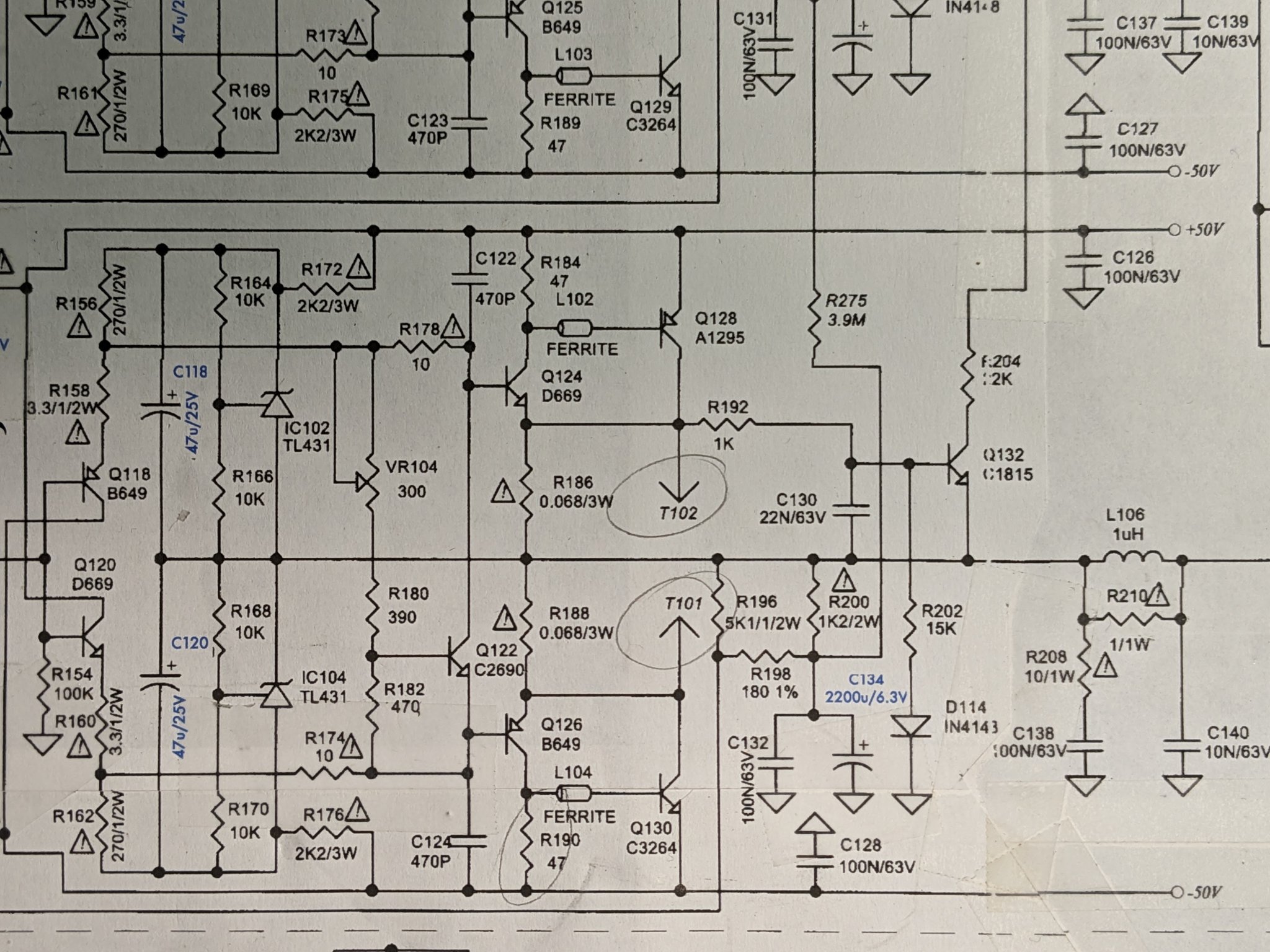

You could try measuring dc voltage between T101 (or T102) and chassis, repeat for other channel T103(or T104) and GND, these are the bias test points so should be conviently located, they are on the emitters of the output transistors rather than the spkr line.
I measured the suggested test points to ground. After startup I got the following:
T101 -8mV
T102 10mV
T103 10mV
T104 -5mV

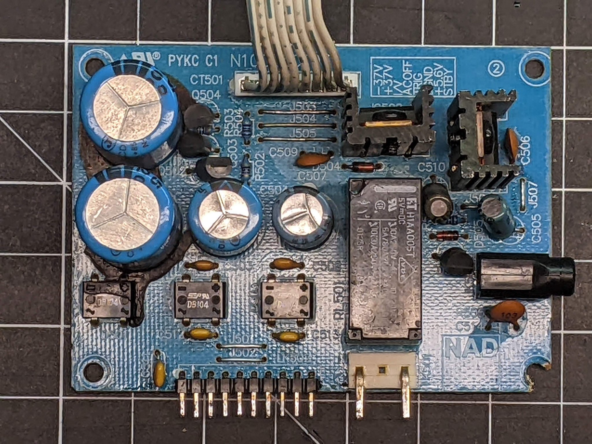

I finished the repair
This thread has been dormant for a while but I have continued to work on this project. Long story short I fixed the amp! Woohoo! If long meandering posts from noobs bumbling around disinterest you stop reading. The sum of all that follows is I fixed it. I am sharing most of what I tried to get it working again so that If someone else is troubleshooting this amp perhaps my post can provide some helpful clues. I also want to thank all those who posted comments. I could not have repaired this without your help.

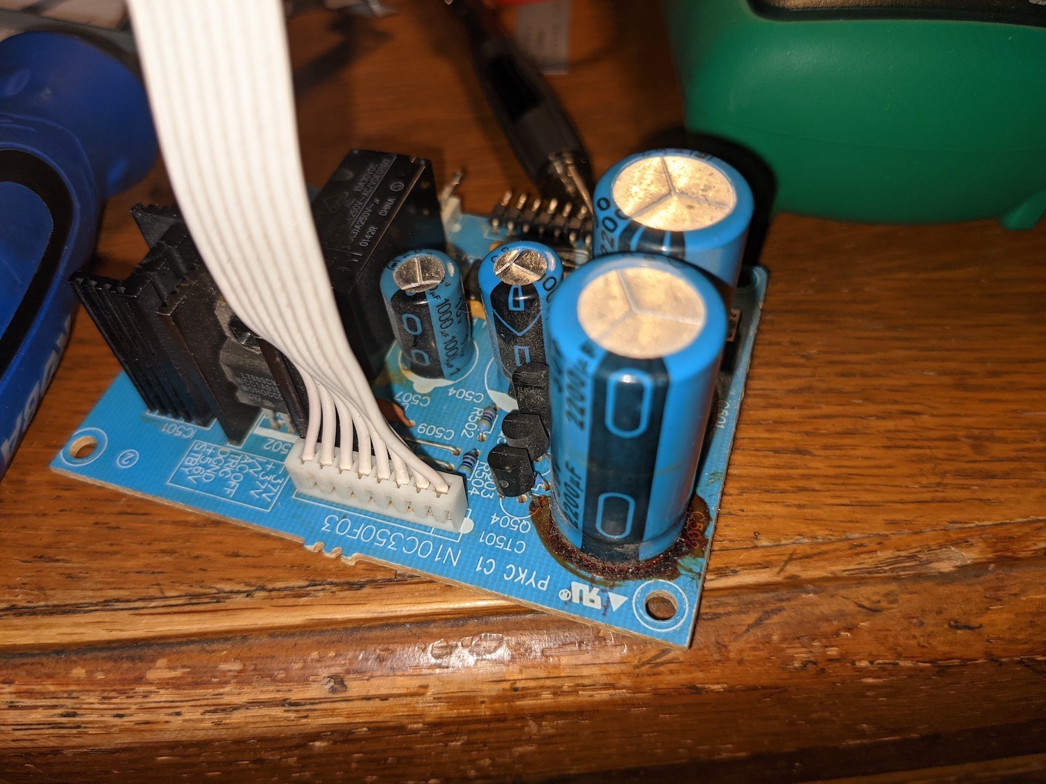

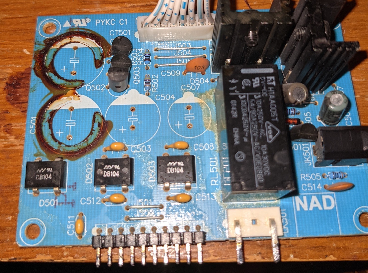

2200uf power caps leaking
Stain under the 2200uf power caps
22,000uf Power Caps leaking
Stain under the large power caps
All Caps replaced

Next I took a closer look at the UPC1237 protection IC indianago pointed me toward. I down loaded the datasheet and tested the voltage on every pin.

The input for pin 4 was way out of spec. This is what was tripping the protection circuit. Pin 4 is for the ACOFF. I was confused and frustrated I had just replaced the electrolytic caps and the power should have been just fine. Then I found the service change doc that discussed this very problem. C511, C512, and C513 are ceramic caps that fail short and trip the protection circuit.
The recommended replacement caps are metallized polyester film caps. I ordered new caps from digikey, PN DME2P1K-F and installed them. They are considerably larger.
I took the time to test the removed ceramic caps with a DMM and all three tested good. I also tested them with an LCR meter at 120 Hz. The results were as follows:
C511 99.99nf and 570 Kohm
C512 96.05nm and 1.083 Mohm
C513 113,16nf and 2.18Mohm
The replacement caps did test better but I would not have expected the ceramic caps to cause a problem with these values. I would have never found this issue if it were not for the service bulletin from NAD.
When I reassembled and turned on the amp it started working again. What a beautiful sound.

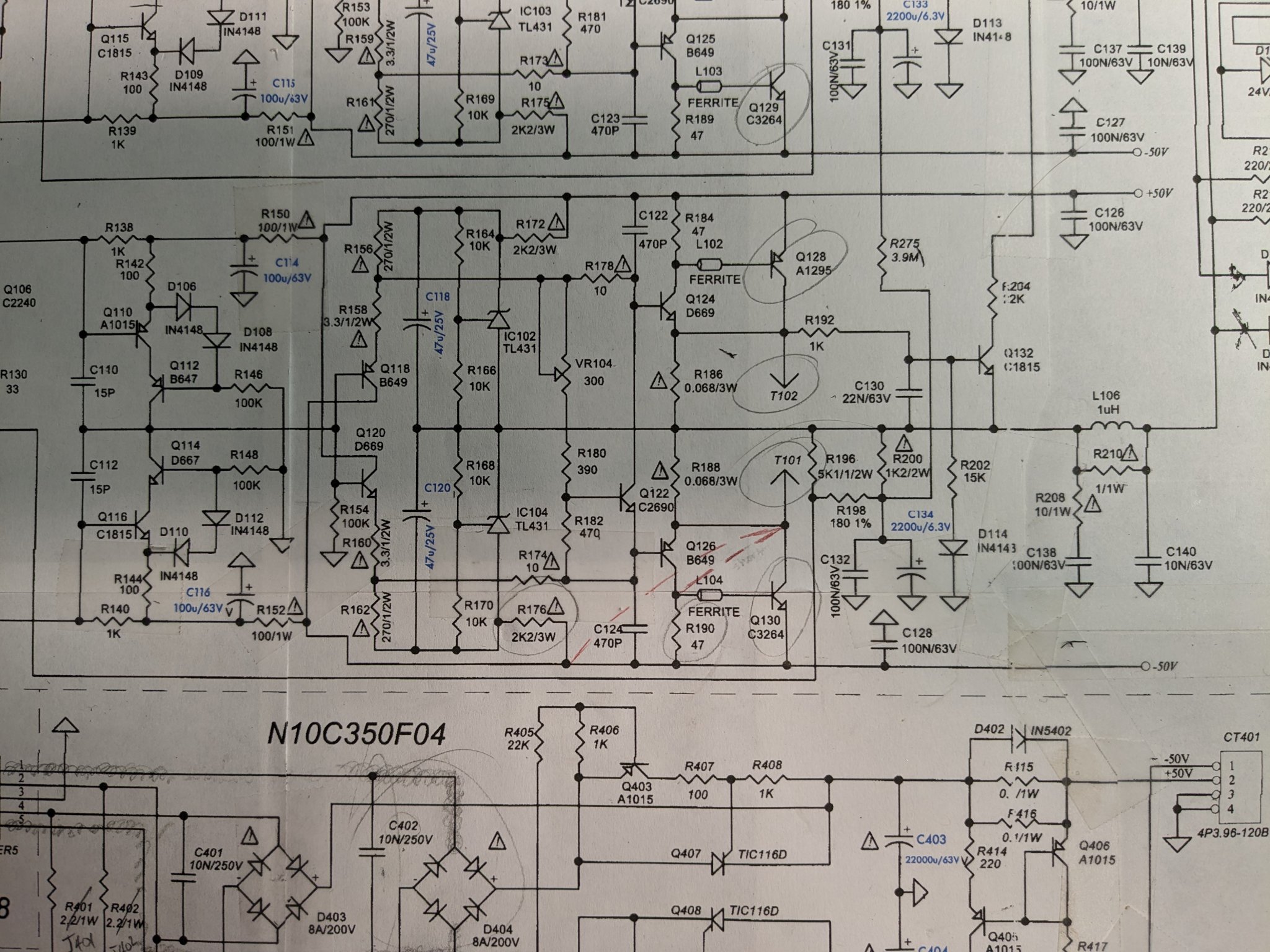

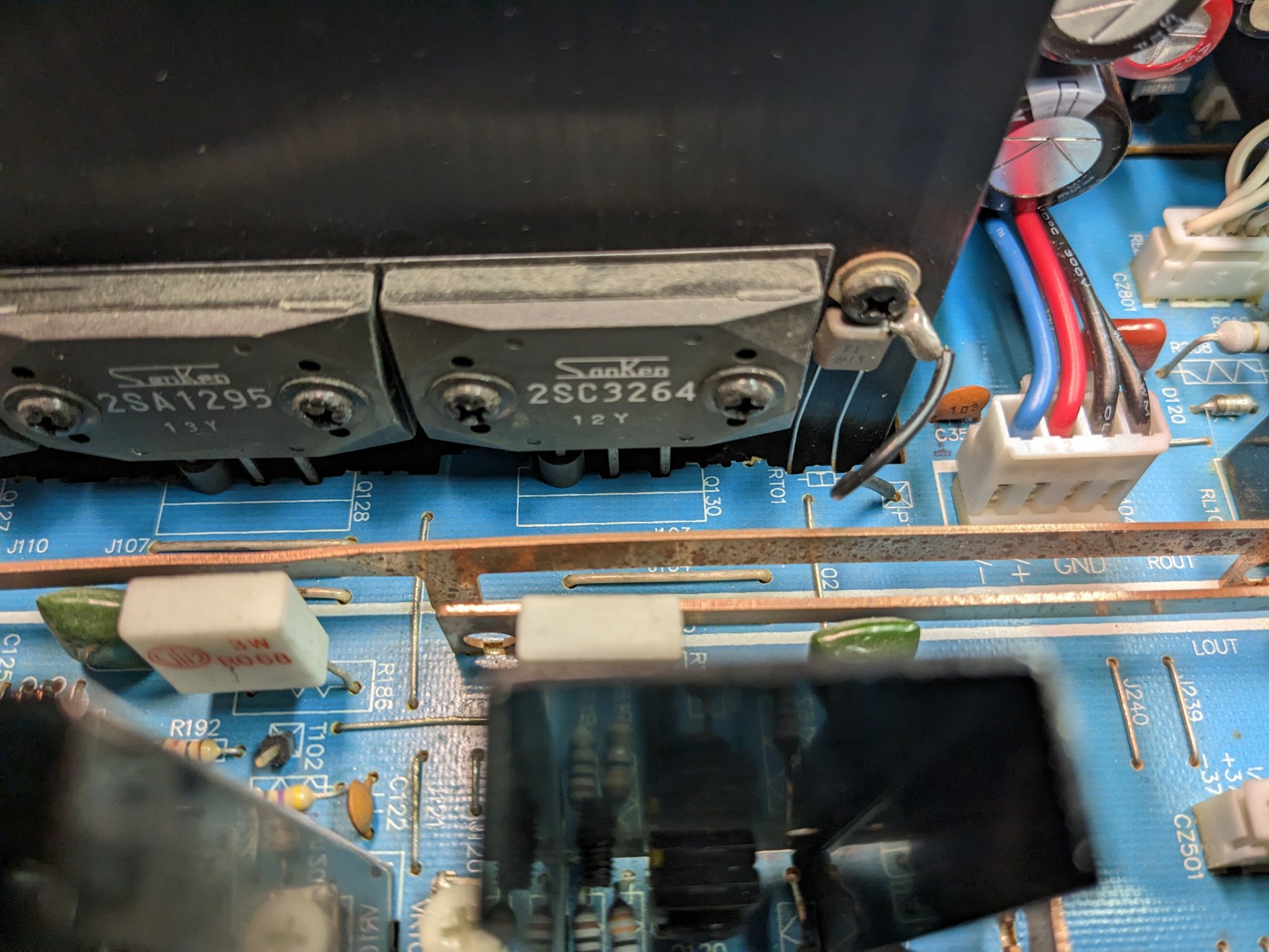

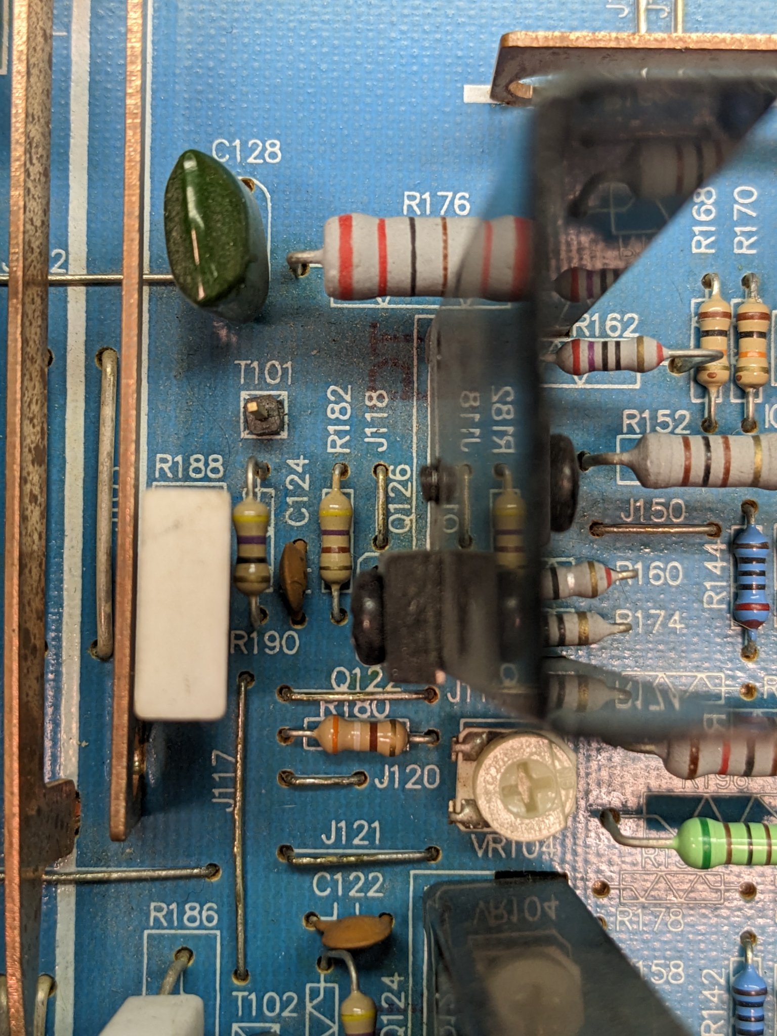

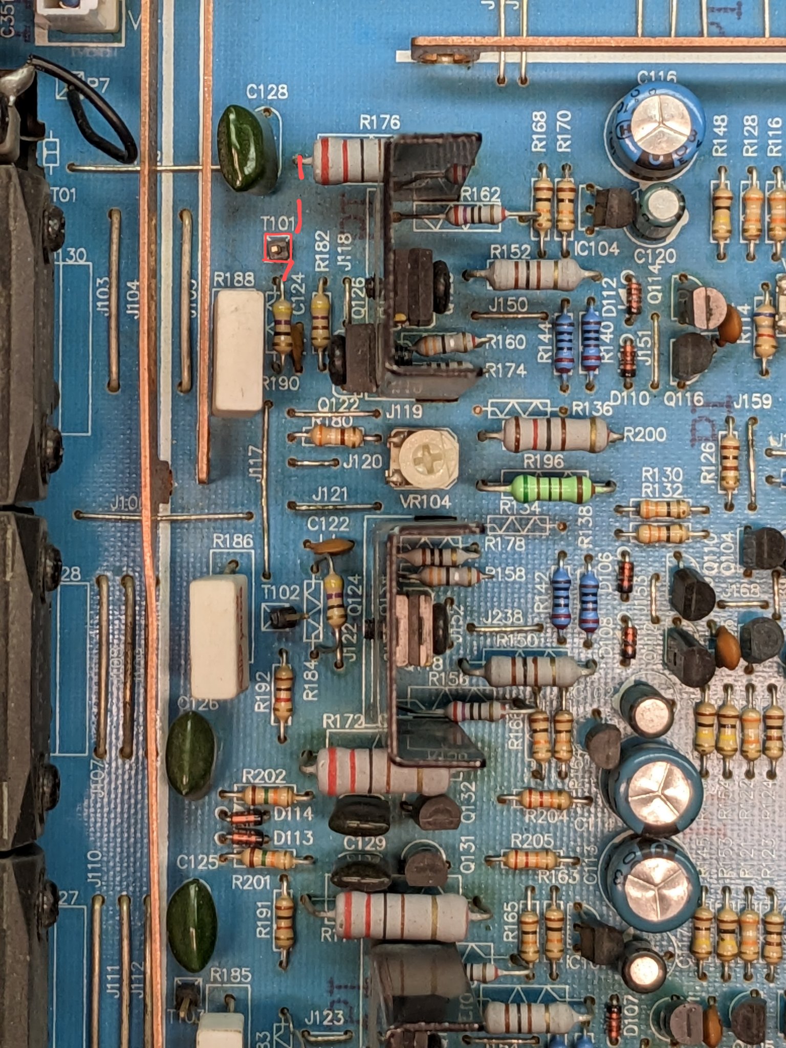

Thanks for the response! In the attached closeup, you can see how close T101 is to a lead on R190—that would have been the easiest thing to short with my probe. Since I was coming in a bit sideways and from what is "above" in the photo, it's also possible my probe touched R176, but less likely. The rail to the left looks close, but it would have been pretty hard to hit. I scribbled those two possible shorts on a more zoomed-out image of the board, and drew dashed lines for the same two possibilities on the schematic, also included.
Just to be sure my fuses are right: the schematic lists the fuses I blew as as T6.3AL250V-50T-063H. I used Amazon and bought a 10-pack of what are listed as 10Pcs T6.3AL250V 5x20mm 6.3A 250V Slow Blow Fuse T6.3AL Glass Slow-Acting Time-delay Fuse (3/16 in x 3/4 in). I didn't find much with the old google, but the "50T-063H" part on the schematic seems to refer to a Hollyland part number. I'm not sure.
Finally, I included a photo of the transistor Q130 that could be mixed up in this.

I believe those MT200 package transistors were discontinued last year.
One doesn't debug a disaster by looking at the board. One looks at voltages around the place your probe was to see they are correct.
Rather than blowing fuses over & over one inserts some resistance in the AC input line to cut the amount of energy the amp consumes in fault mode. A 60 W tungsten light bulb is the usual device for small amps. I have my bulb socket in a grounded steel box with a circuit breaker ahead of the bulb, and a nice NEMA15 socket for the amp power plug. Those lamp sockets are made for solid house wire, and stranded wire tends to pop off the screw and fly around. Tungsten bulbs can be found at flea markets charity resale shops etc in old lamps. Europeans can use a one cup tea heat element as a resistor, but such appliances do not exist in the western hemisphere.

A short from TP to R190 would probably zap the output transistor. Have you measured them in circuit between C and E and B and E to see if they read short? Measure both output transistors.
Do the same for the drivers Q124 and Q126
The two 0.068 ohm resistors are to low to read on a meter so just make sure they read 'short' and have not gone high or open.
Use a bulb tester rather than keep feeding it fuses.
Yeah, and I used Pomona grabbers to adjust the VRs, then switched to the probes for the last bit where I wrecked the amp. Lesson.Why you should use a pomona grabber instead of a meter probe.
For me, looking at the board is really more about trying to understand as a non-expert what I'm looking at. Fortunately I have a light bulb limiter I made when I built my guitar amp. For that I used a 600W barn bulb in the socket. That's a pretty responsive tester, but it's what I have on hand for incandescents! Too bad I wasn't using it when I ran those voltage checks. Regrettable.
Checking continuity on the drivers, Q123 and Q125 (on the seemingly unaffected channel) test as open between all of C-E and B-E, but Q124 and Q126 are short between C and E. And on the outputs, Q128 and Q130 are short between C-E and B-E. I'm guessing that both the drivers and the outputs on that impacted channel are kaput. I don't know the role of Q122 and Q121 in this, but I reckon I'll test those as well before I start on a shopping spree. For today, without having put any power through the thing (currently I don't see what would be the point), that's where I'm at. Time to source replacements for the (discontinued but apparently gettable) outputs.
