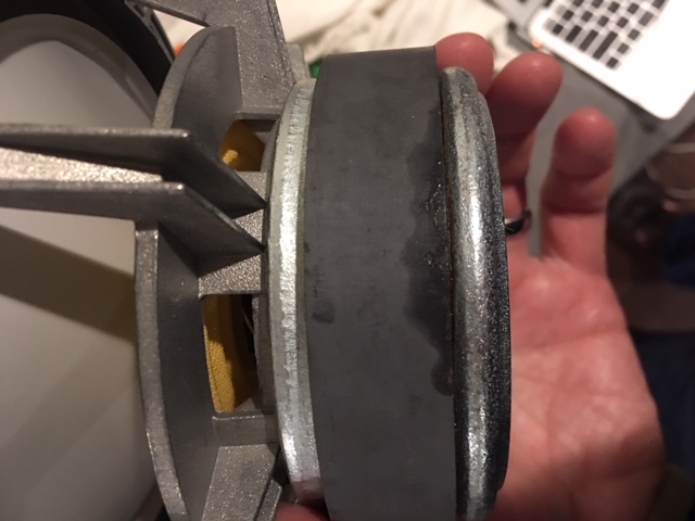

The other weird thing is that on the driver that is giving me issues I noticed what appears to be a dried looking liquid stain sort of thing on the part that is magnetized. I took a picture but can't figure out how to post it here from my computer - all the options in posting seemed to require it to be hosted somewhere but I may just be missing something. I don't know if that is relevant or indicative of anything, but offer it up in case it is.

Thank you for the explicit instructions - this is the weird "wet" looking spot I noticed on the driver. Not sure what's going on with it.
May just be excess adhesive, but unlikely to indicate a fault in the woofer. I'd be more concerned with checking the tinsel leads as I have suggested.

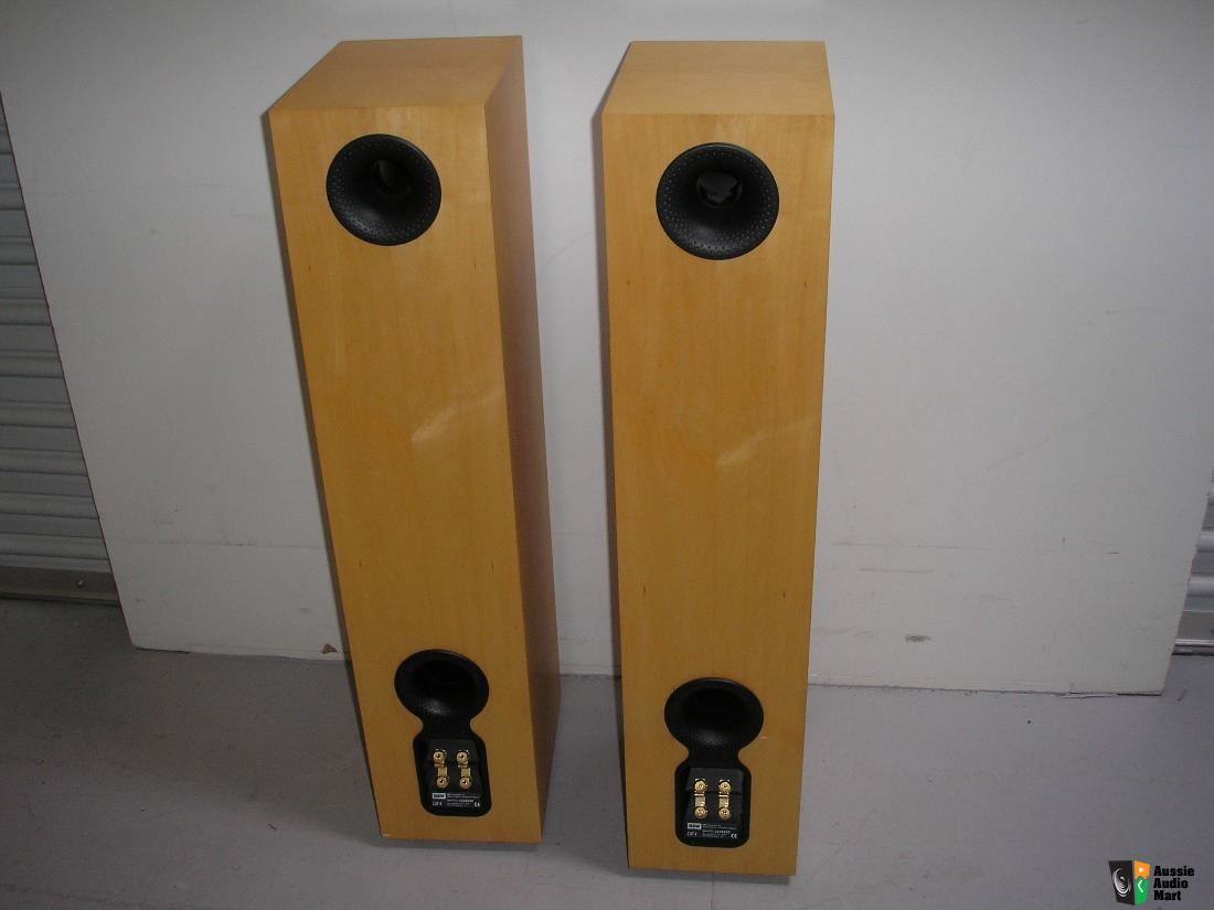

Often, the crossover is mounted on the rear of the speaker input terminal plate seen in the attached photo.
Unscrew the plate and, if the crossover is revealed, take photos of it from all angles. Some photos showing the condition of the driver surrounds would also be welcome.

Sounds like the woofer has been overdriven, the voice coil has overheated and is now stuck in the magnetic gap. The stain on the magnet could be due to melted enamel/adhesive leaking out.

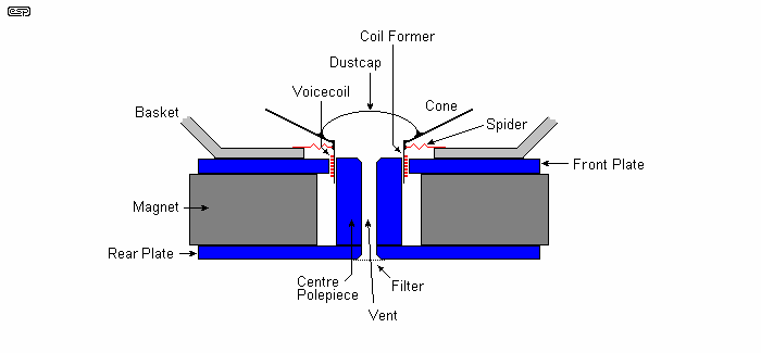

Either the voice coil has overheated and has swollen up, or the rear plate of the magnet assembly has slipped, moving the centre polepiece - either would mean that the voice coil would get stuck in the gap between centre polepiece and front plate.
Check the spider for any signs of burning due to an overheated voice coil. If visible you will almost certainly require re-voice coiling.
If there's no sign of burning, then attempting to move the rear plate with a sideways blow from a rubber mallet might just re-align the assembly.
Beyond that, you can start to pull the front surround and rear spider off the basket just to get a good look at the damage for educational purposes!
