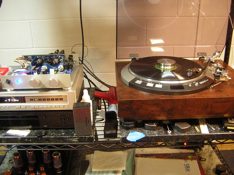

Adding a pic of the TU-8500 with the 'top down' waiting for the week to go by so can roll in the GL tubes.
Nice setup! That TT looks phenomenal! I love how it looks with that tone arm.
I feel the pain of having to slowly add upgrades. It took me about a month of listening as I swapped out the stock components with the 8500 and 8600.
I'll Have to share my set up later today!
