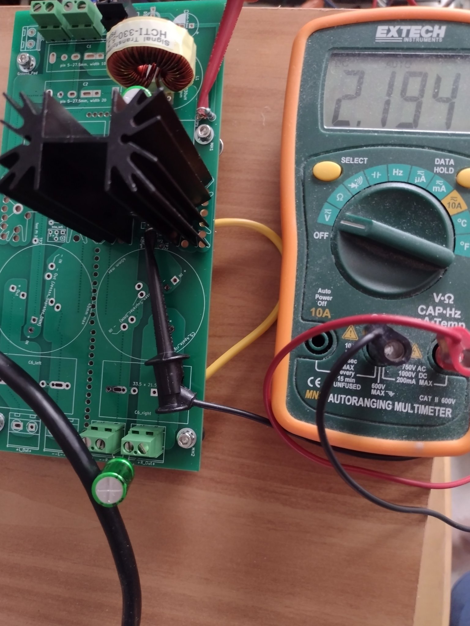

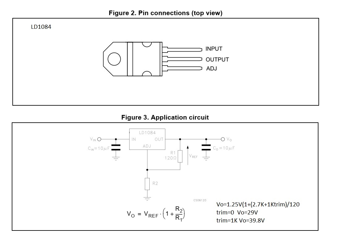

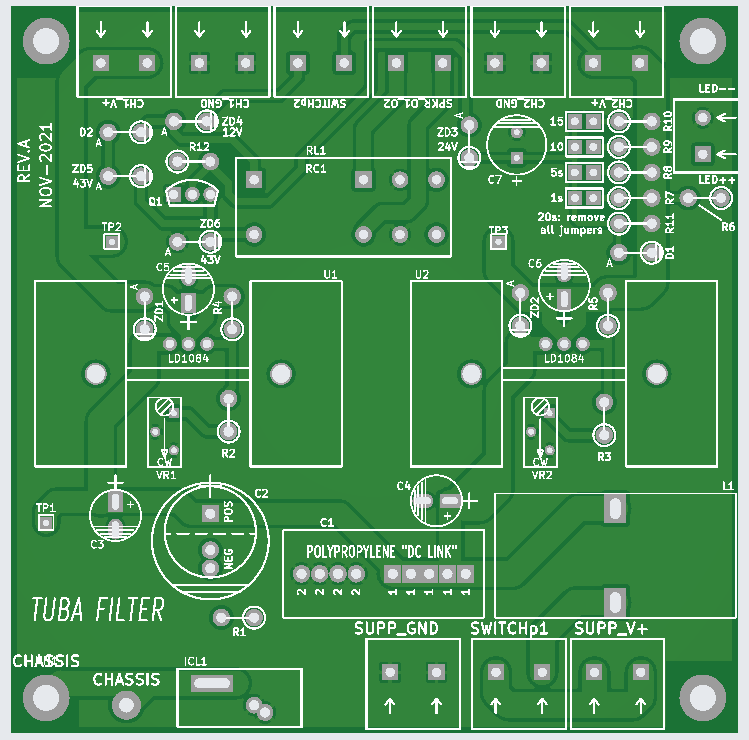

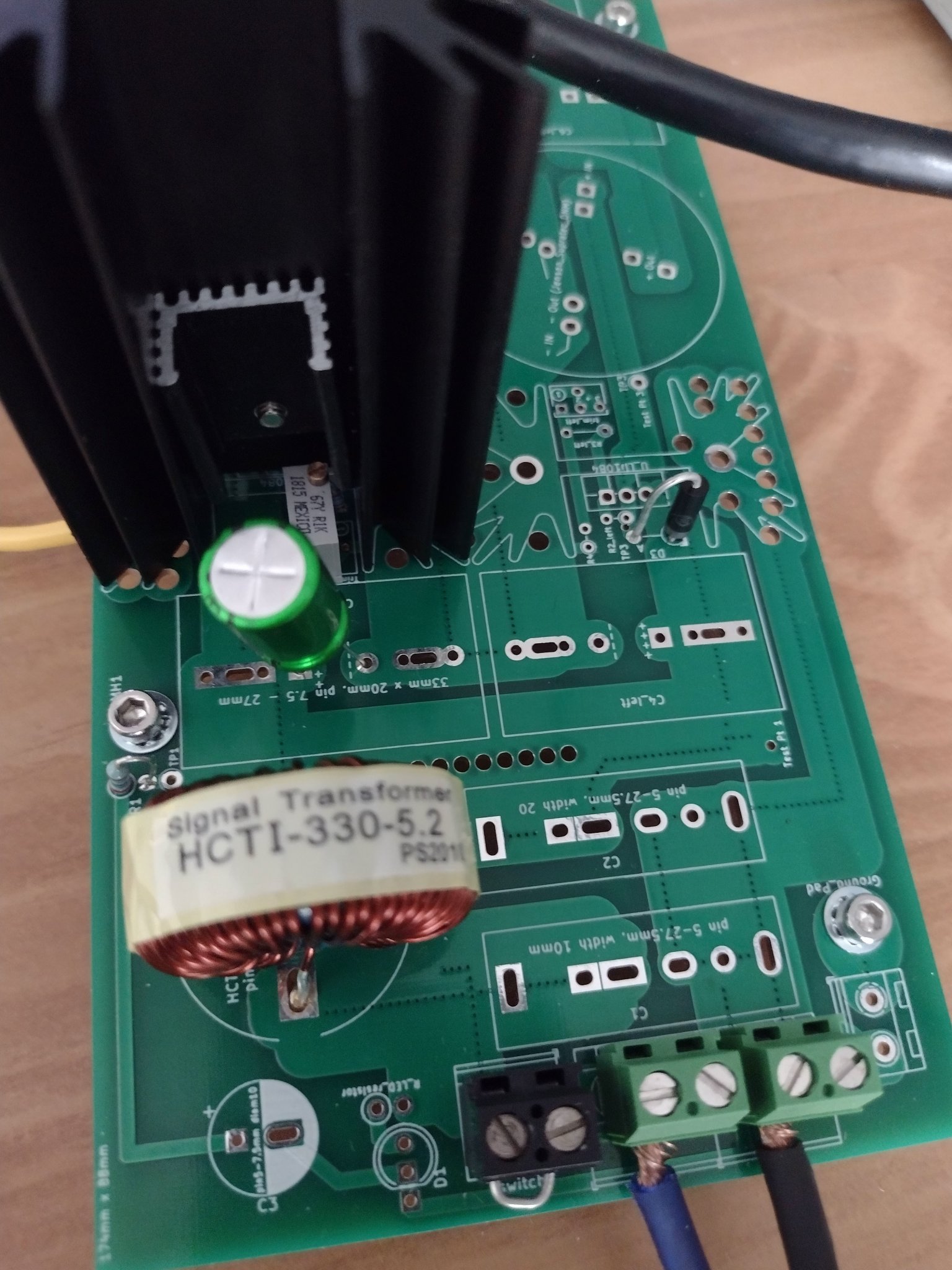

So I'm testing the LD1084 part of the circuit. Using Mark Johnson's instructions - trims at max clockwise - I measure a 2.2V across TP1 - TP2, which was a bit of a surprise. Turning counter clockwise increases the V drop, as expected.
According to the datasheet the Vout = 1.25V*(1+(2.7K+1Ktrim)/120R)
trim=1K, Vout=39.8V
trim=0, Vout=29V
Input voltage is 36V so I expected 36V-min V drop (maybe 1.25V) at trim=1k.
All resistances verified so it's a bit of a head scratcher. Any ideas?

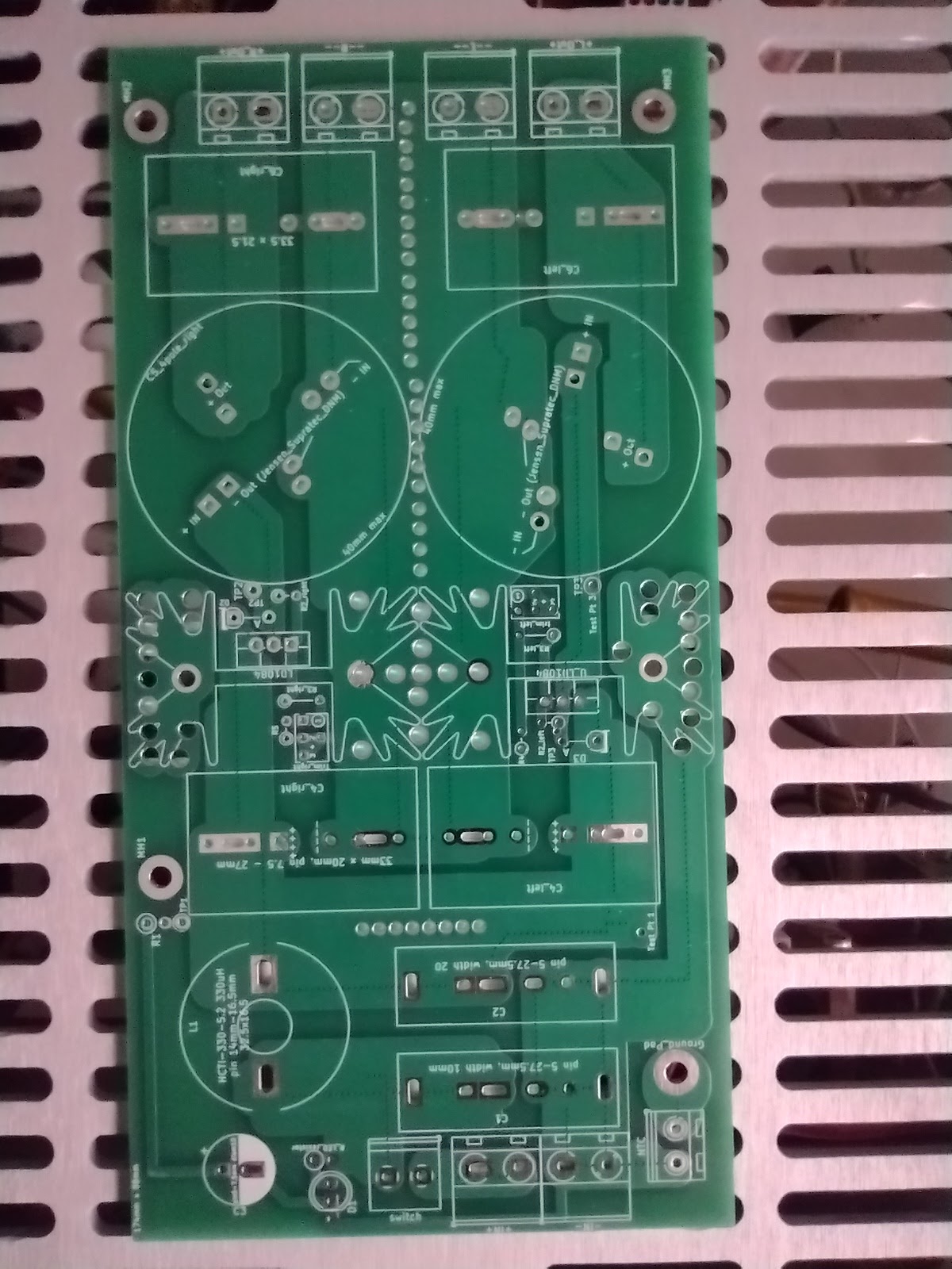

Your PCB is unfamiliar, it's certainly not the one whose Gerbers I attached to post #1 of this thread (image below). First talk to the people who created that board; has anyone else built one and gotten it to work?
Posts #45 and #61 of this thread, exhibit successful builds of the board shown below.
@alazira
I created the board. I'm still learning the in and outs of KiCad so I may have made an error even though the schematic is fairly simple. I changed the 2.75K for 3.3K and the starting V drop was 1.78 and I was able to tune it to 2V. Just wondering why the calculation didn't match.

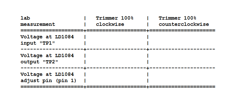

If you run Tuba all by itself, with no external load, nothing bad happens when you turn the trimmer all the way clockwise or all the way counterclockwise. Why not try that and see whether the measurements are reasonable. (Voltage at point X with respect to Ground). Also check your old Mouser and DigiKey orders to find out what resistor values you actually bought. 2.7K? 2.75K? 3.3K? 3.32K? 120R? 110R? etc.

Update: Success!
With no load connected, 36V input

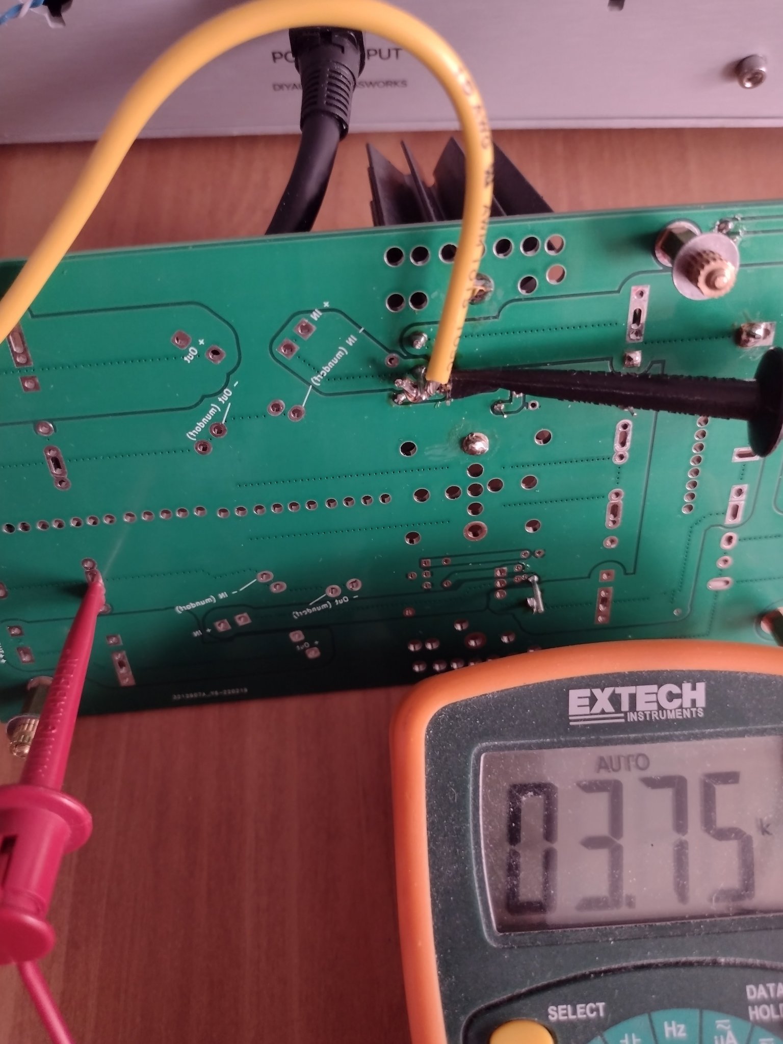

To achieve Vdrop of 2V I had to increase the 2.7K+trim1K to 3.3K+trim1K. I measured 4.1K for 2V drop.
However, once connected to the amp the Vdrop went to 1.1V, which would appear to be the minimum drop. complete counter clockwise (trim=0) did not move this.
Changed the 3.3K back to 2.7K and reset trim to 1K. Vdrop now 1.7V and tuneable to 2V. There is some drift lower as the part heats up. I measured a max of 53deg C on the heat sinks.
Conclusion: The 1084V part calculations worked with load but not unloaded (at least in my case). Also, I see from the datasheet that the part has a rated max of 30V so here we are running it 20% over. Not sure how this will play out for long term durability. Hopefully they were conservative on the rated max.

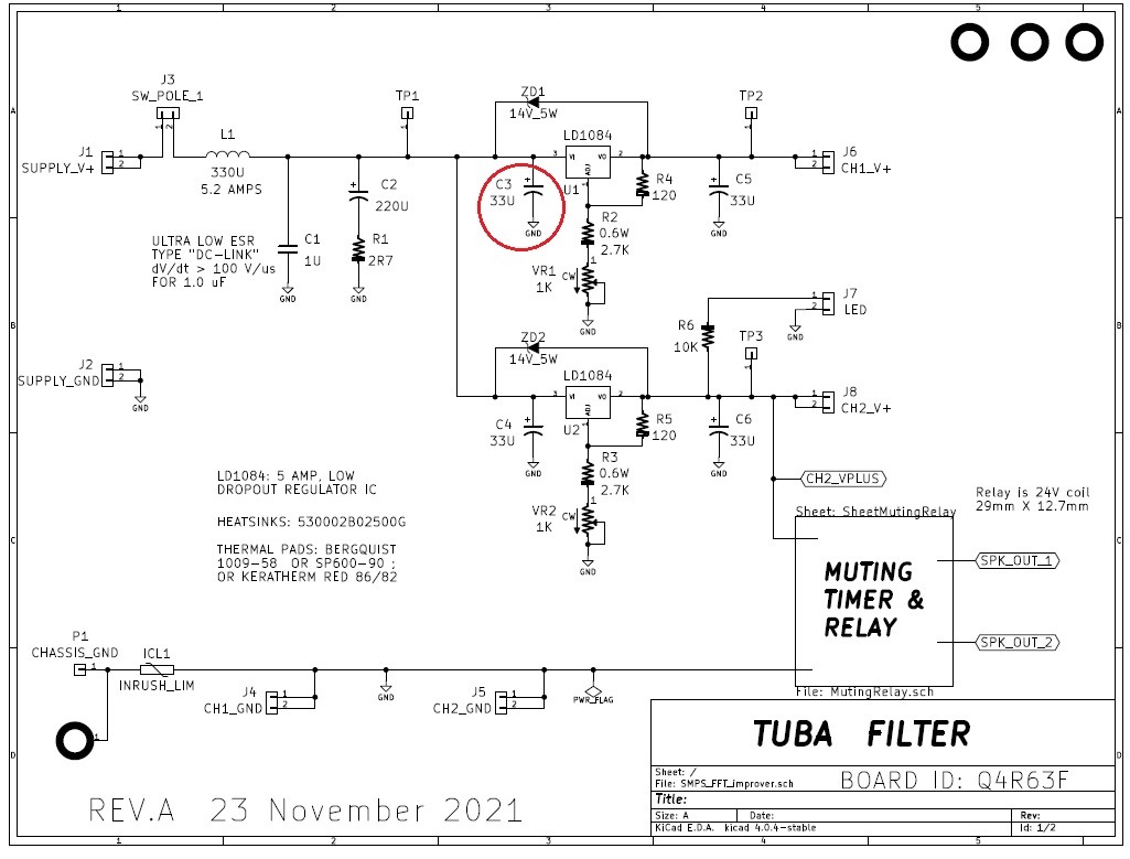

You forgot that the LD1084 (and the LM317) voltage regulator IC treats its output pin as the circuit reference. All voltages are with respect to the output pin -- the IC doesn't know and doesn't care where "ground" is.
So the datasheets give maximum permitted input-to-output voltage. Not input-to-ground voltage, not output-to-ground voltage. Input-to-output voltage. Thanks to the Tuba's zener diode, and its choice of trimming range, input-to-output voltage always remains well within the datasheet specs. T.I.'s LM317 datasheet explains this more thoroughly than S.T. Microelectronics' LD1084 datasheet.
This is what allows vacuum tube folks to use LM317's as 160 volt regulators. They carefully control input-to-output voltage, and let output-to-ground go sky high. Check out the famous Linear Brief attached here.

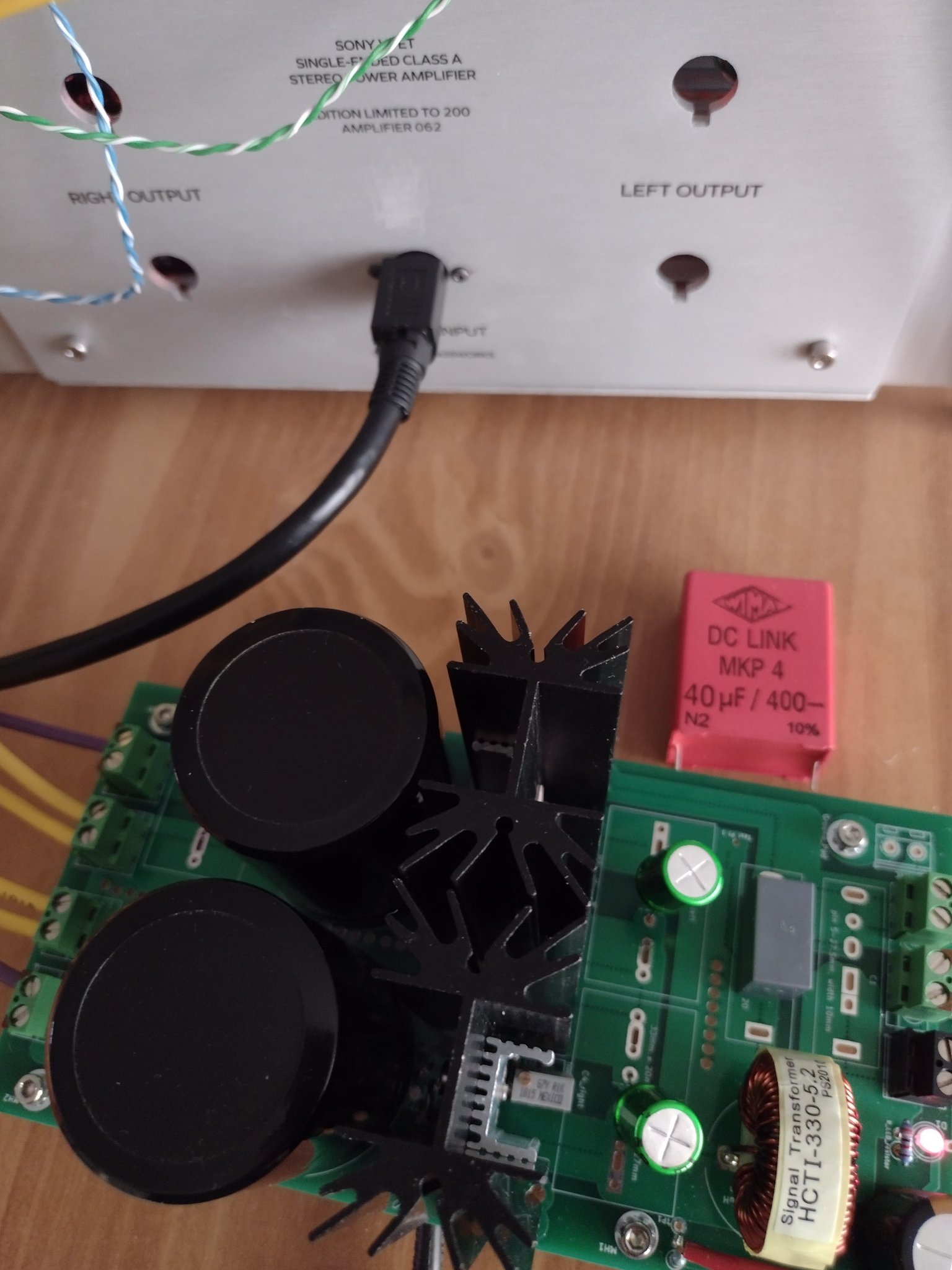

I have added (2) 10,000uF 4-pole DNM caps on the output. The meanwell SMPS did not seem bothered.
I have made a provision for a Wima DC Link 40uF cap at C3 (in Mark's schematic). Would substituting this for the 33uF electolytic alter the filter freq?

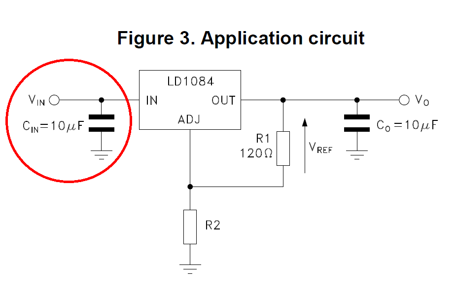

Tuba C3 and C4 help prevent the LD1084 chips from oscillating; the datasheet says "a minimum capacitor of 10uF is needed for stability". As long as you don't increase their lead length or lead inductance or distance from the ICs, increasing the capacitance beyond 33uF would be fine.

Remember that the Tuba PCB contains two voltage regulators: one for the Left amplifier channel, and another for the Right amplifier channel. This is shown on the schematic attached to post #1.
