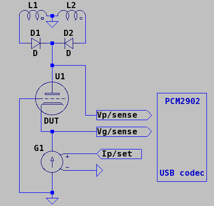

For a while, I have been thinking about building a modern vacuum tube curve tracer - an affordable one, that is. I came up with a conceptual design that looks like it would fit within couple of hundred bucks parts budget. The idea is to simplify hardware and offload most tasks to computer software. Here is the plan:
Hardware:
Dispense with regulated plate supplies - use rectified AC as in tube testers of yore. Control tube current, not grid voltage, with a current source in a grounded grid configuration. This is both safer and easier to interface with DAC, as it could be done on the low-voltage side of the rail. Measure Vg vs Vp curve for a set Ip as plate voltage swings at 120Hz. Interface to host computer via cheap 16bit USB codec chip - PCM2902. Use a high-efficiency step-down switcher for heater supply. Do basic operating parameter settings (heater voltage, idle bias current, max plate voltage, power limiter resistance) with hardware controls, but let software to do a Ip current sweep (within set limits). That leaves one DAC channel unallocated, which could be used to control a screen supply. I have not decided on socket wiring strategy yet - could be simple point-to-point with patch wire.

I know about that one... Interfacing to computer is going to be the cheapest part of the tester, whatever glue chips you use. The main expense (and size) sits in the high-voltage supplies. This is where one can do better, I think. Schematic above will trace triode curves without the usual baggage in high-voltage supplies.
All the computer-interface tracers I've seen so far are brute-force designs. The plate supply is a regulated HT rectifier controlled by some sort of voltage sweep generator (DAC or analog). This is a lot of circuitry (and heat dissipation) for something that is available straight out of the wall - a sine wave voltage sweep. Separate grid bias supply is also not necessary if you run the tube in self-biasing configuration.

just remember that when you use the sweep "from the wall" all of your measurements must be close to synchronous -- not that difficult if you use a decent ADC and USB -- but remember the processing and communications overhead as you cache data, and the inacuracies of the line voltage over time.
you will find that when measuring tubes you have to integrate the measurements -- the resistors you use to drop the voltage to your ADC knock off several bits of useable information from the measurement in a random fashion (remember SQRT (4KTBR) ) -- these bits can be recaptured with multiple measurements and averaging and/or a low pass filter.

jackinnj said:just remember that when you use the sweep "from the wall" all of your measurements must be close to synchronous -- not that difficult if you use a decent ADC and USB -- but remember the processing and communications overhead as you cache data, and the inacuracies of the line voltage over time.
Not an issue if I use a stereo audio codec - two channels are synchronous.
1 MOhm resistance into 40kHz audio band gives 26uV thermal noise. Not an issue even for a 16-bit ADC, and I suspect that PCM2902 is effectively 14-bit or less anyway. Averaging is always a good idea, but statistics is easier to implement in software.
If you aren't regulating, you actually have to measure the grid, plate voltages and currents -- any error in the line voltage is multiplied in the secondary -- and if you look at an FFT of your line voltage you can see the harmonics and birdies which fuzz up your measurements. Put a data-logger on your mains, then have the wife crank up the dishwasher or her hair-blower and you'll see what I mean
and you will probably want to isolate the codec from the high voltage with an analog optocoupler (Siemens Vishay IL300, Avago (the newest iteration of HP's, the Agilent, now Avago semiconductor products, HCNR200, HCPL7840), Fairchild, Vactrol). you don't want to blow the CODEC and your laptop because some HV decided to stray across your PCB.

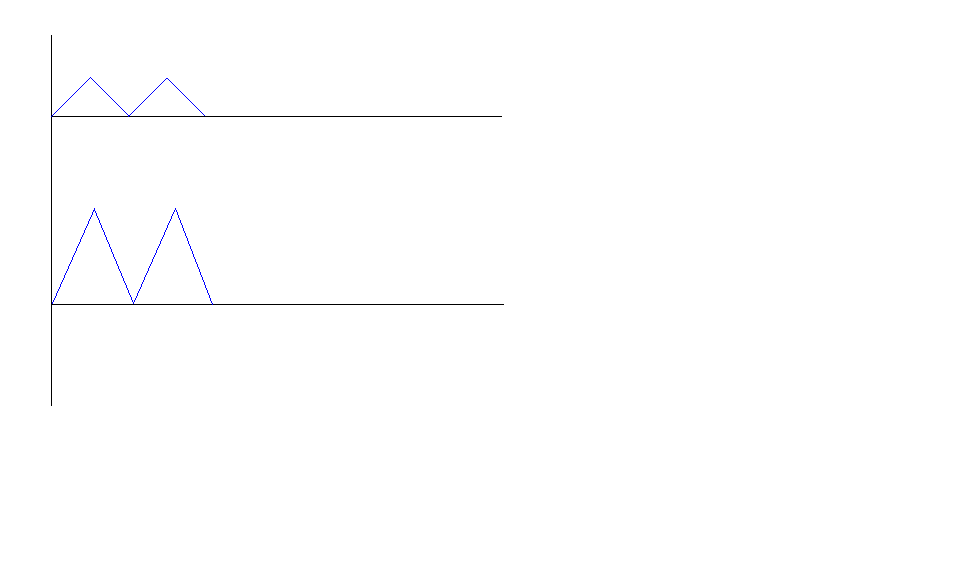

Hi there !
I'm working a bit slow, but I really work !
Here is a screen capture of the current display:
Data where sampled using a very simple (and for from perfect) setup like this one:
The outputs labelled "To O'scope" was used to feed a "standard" PC sound board inputs.
