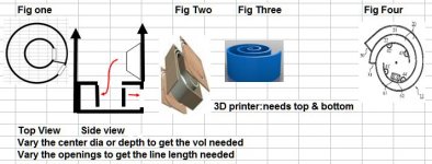

I'm interested in making an insertable disk circular port (not a tube) that sides into a non tall cylinder to get a longer length port where a tube would not fit. See figures 1 to 3. I can also slide in various "Discs" with different volumes easily.
I can vary the air mass by changing the center circle dia and/or the depth of the disc (sandwich plates seal the channel.)
I can vary the port length by changing the entrance and the exit locations.
Couple of questions:
1. In a bass reflex (not a T-line), if you have two ports with the same volume, but one is longer than the other (thereby smaller cross sectional area) , would the performance be the same assuming there is no chuffing in either?
2. In other words: is the weight of the air mass inside the port that determines the box tuning or the length of the port? ie, 2" dia times 6" long port has the same vol as a 3" x 2.67" long port about 18.85 cu in.
Would both ports perform the same?
Separate note: see Fig 4. From what I read, two different length ports do not work but then there is the neat cornu spiral horn that seems to work well. So do two different length ports work or not?

More or less a ratio of length to diameter. Doesn't follow mass, in that a larger diameter port needs to be longer, not shorter to keep the same tuning.
Or stated a different way, as you add air column mass by increasing port length for a fixed diameter, tuning frequency drops. AND, as you decrease air column mass by decreasing port diameter for a fixed length, tuning frequency ALSO drops.
Good, what I have been reading about calculating the air mass inside the port and then using that as the weight to add to a passive radiator is wrong. That is what brought on the question. Anyway, the 2nd part of the post based on fig 4 in the picture: Is it also wrong that you shouldn't have two different length ports? And yet, the popular Cornu has them???

Attached is a formula for determining the length of a (round) vent for a "normal" vented box. It involves:
c = speed of sound in air
R = radius of vent
Vb = box volume
fb = tuning frequency.
Without going into too much detail . . .
The modeling behind this starts with a vent containing a mass of air that vibrates back and forth, and the volume of air behind it acts as a spring. The "1.463R" term is an end correction factor (determined from empirical data), assuming one end free and one end flush mounted.
The tuning frequency is found from a ratio of the spring "constant" of the air in the box, to the mass of air in the port. The mass density term cancels out, and does not appear in the final result.
Think of the air in the box as a compression chamber, with the mass of air in the vent being a piston moving against it. The cross section area of the vent determines the "stiffness" of the air in the box. A larger diameter vent sees a larger force from the air being compressed than a smaller diameter vent would see.
The formula shows you that a larger radius vent requires more length to achieve the same tuning frequency as a smaller radius vent, given the same box volume.
Question: Which is it, port length or port volume (air mass) that tunes a box?
It's the ratio of the air mass in the port and the area that couples that mass to the internal volume of the box (neglecting the details of internal losses / turbulence in the port, and end correction stuff).
