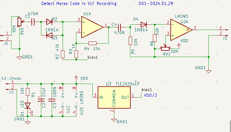

The raw signal level is too low for my circuit but I see you have a successful decode using Gerke even though the noise spikes were getting through. Noise spikes trouble my design they because they look like the start of a dit or dah.
My attached schematic removes some of the noise from a recording. It interrupts an ESP8266 which sends time-stamped signal events to the PC for decimation and decoding. So far, it works only with ideal Morse Code, not VLF.

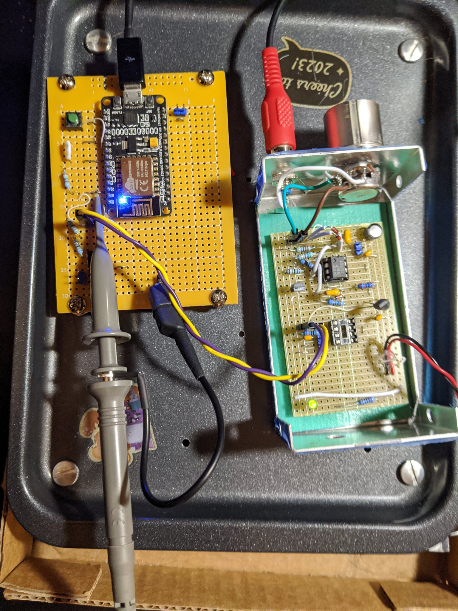

There is great software for decoding CW radio signals but I wanted the DIY experience using less abstract and simple hardware and software. I have an analog PCB and a digital PCB. The analog converts the audio input from the recorded transmission into pulses for the digital. Interrupt routines on the digital produces a 100 microsecond clock for timestamping the analog events which occur at about 750hz. These are output to the PC USB serial port at a high rate. A PC program interprets the timestamps to reveal the Morse Code timing. Ok, it's an elaborate simplicity. 🙂
Morse Code was designed for wires with the signal either on or off. Unfortunately, there is no off state with wireless since the CW transmitters cannot turn completely off. And if they did, noise and interference would take over. There are sharp spikes even under good conditions. They may change the timing when the transmitter is on but they cause fake dit-dahs when the transmitter is off. It is possible to double check a possible spike, throw it away if it is less than a time unit. But that is too fancy for me.

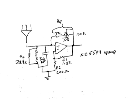

Below is my suggestion for implementing Q multiplication and a brief description. Please excuse my crude drafting.
I assume an antenna connected to a parallel L-C resonator and a low-noise opamp with voltage gain of +10. As a guess, I’m assuming the resonant tank circuit has unloaded Q of about 30 and have modeled the losses as a parallel resistor (Rp = 33.9k) in shunt with the inductor. Resistor Rf applies positive feedback to the the resonator to raise the Q. Threshold of oscillation is reached when loop gain is 1.0. That occurs when Rf = 9 * Rp --- that is, when the attenuation of the Rf and Rp voltage division is 1/10, and the forward gain of the opamp restores the gain to unity.
I’ve arranged Rf as a combination of a fixed R and a pot so that the multiplier Q can be driven from low Q into full oscillation, but of course these are designer options. I’m remembering a Heatkit Q multiplier from my teenage years. 😉
Q multiplication is an interesting idea and is worth looking at further.
