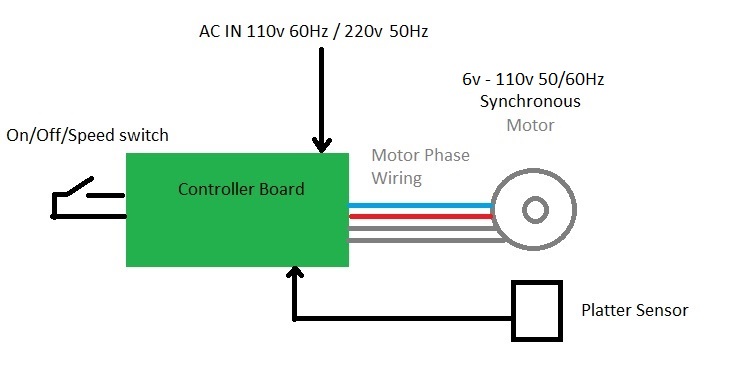

Disregarding AC in 110/220V, can we reasonably assume there'd be:
- 3 wires to the motor
- 3 wires to the sensor
- 2 wires to the on/off switch, possibly 1 of which is common to the sensor

Motor drive is a minimum of 3 wires (you can share the common GREY of each phase) but you may need to cater for Earth depending on your turntable. If housing the controller in an external box you could also alternatively, feed the supply back to the controller if you want to use the main turntable power switch as a master on/off so 2 more conductors could optionally be required.

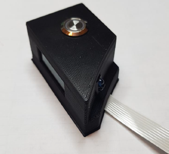

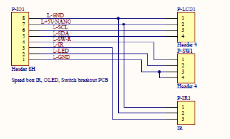

For the final boards I have added an 8 way 1mm FFC connector for the combined OLED/Switch/LED/IR sensor connection as it offers the thinnest, easiest, unobtrusive connection method. (The resistors and transistors are all SMD now rather than a mix of SMD and through hole). Don’t worry if you are building your own kits, I am going to solder that 1mm pitch FFC connector on the board for all of you with my IR reflow oven as they are not easy to hand solder. (I did baulk at the even smaller 0.5mm pitch version). There is still the original 0.1” pin header connection available as well if you prefer to use that in your own external enclosure combinations. I attach a wiring diagram at your request Zung to you can see how many signal lines are required.

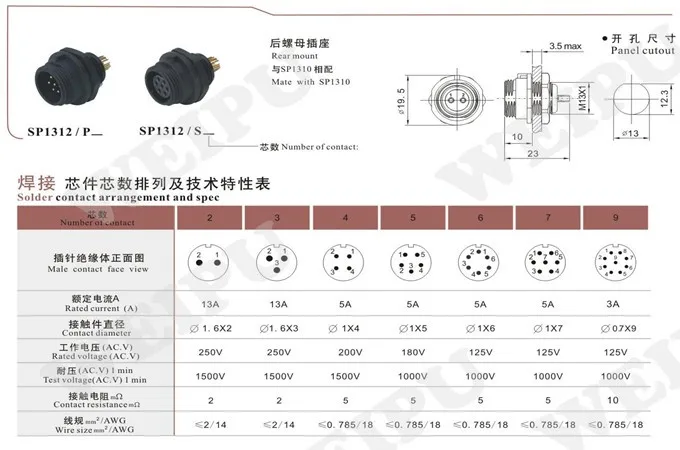

I've found the WS16 series: I think they're nice too, and they're fully specified: 400V, 5A, and up to 10 pins; technical drawing is at the link. Chassis side is female, and cable side is male. The only catch is you need a 16.5mm hole punch/saw.
Edit
Here's the specs for the SP13:
Hi Zung,
Those specifications are helpful. The problem with the Chinese SP13 listings on eBay is that the do no clearly specify which gender of the pieces they are supplying as standard.
I have found these SP13 6 pin connectors from a UK supplier called CPC. As you would expect they are more than double the price of the ebay ones (plus delivery) but they are clearly specified and available.

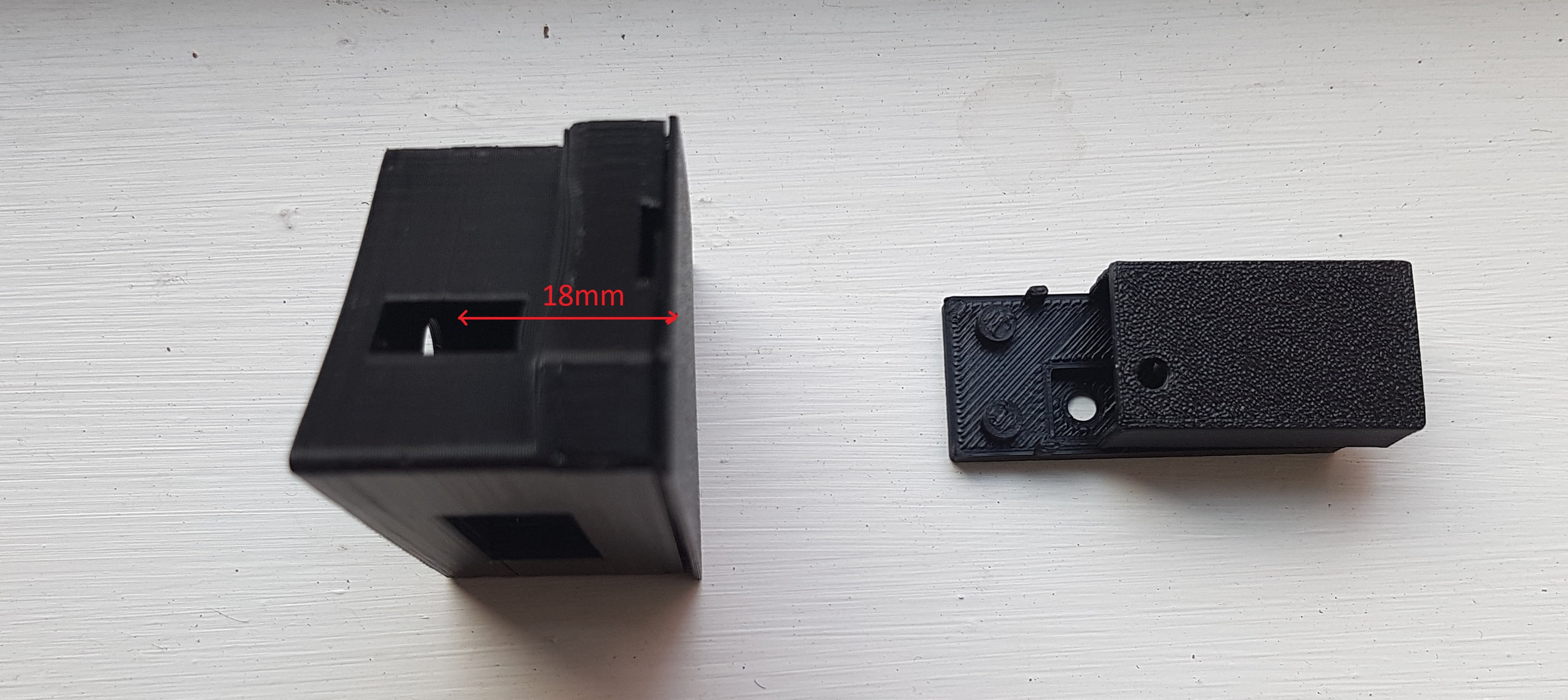

not sure whether this has been discussed before,is there a convenient way to raise the printed speed sensor box if needed?what is the current sensor height from turntable base? thanks
Hi there geoturbo,
currently there are two IR sensor options. 1) in the combined IR sensor/OLED/switch casing. That’s the wedge shaped box and is designed to fit somewhere next to the platter. The IR sensor is a rectangle 10x5mm centred about 18mm from the top of the plinth 2) IR sensor on the inside of the platter. This is only suitable for platters which have sufficient clearance e.g. LP12 and probably TD160 – there could be others though. With option 2) you need to decide somewhere for the OLED and switch (possibly an external enclosure) – see post #110 or some alternatives Zung and others have suggested. (Attached image has the combined speed box standing on end so you can see the IR aperture. Image on the right is the casing when mounting the sensor inside/under the platter).
Inevitably, the IR sensor 3D printed boxes will not fit all turntables. Either radius, positioning or height will be a problem and I cannot make a box for every turntable variation in advance. I will make available the Fusion 360 CAD (Fusion 360 is free for personal use) design for anyone who wants to modify it to fit their turntable. All I would ask is you send me a copy of the modified CAD file with the turntable details. I will even print the box for you for cost of filament (about 0.50 GBP) and postage. Although the design is heavily modified, I must credit Greggan with the original combined speed box concept. Send me a PM if you want the file.
Incidentally, remember you can always use a Hall effect sensor & magnet if the IR sensor is not suitable for your turntable. An example of this might be a highly chromed platter with limited space inside the platter for IR sensor mounting. I am currently investigating reversing the logic on the sensing and using the reflectivity of the polished chrome platters and using a matt black marker label instead of white markers.
