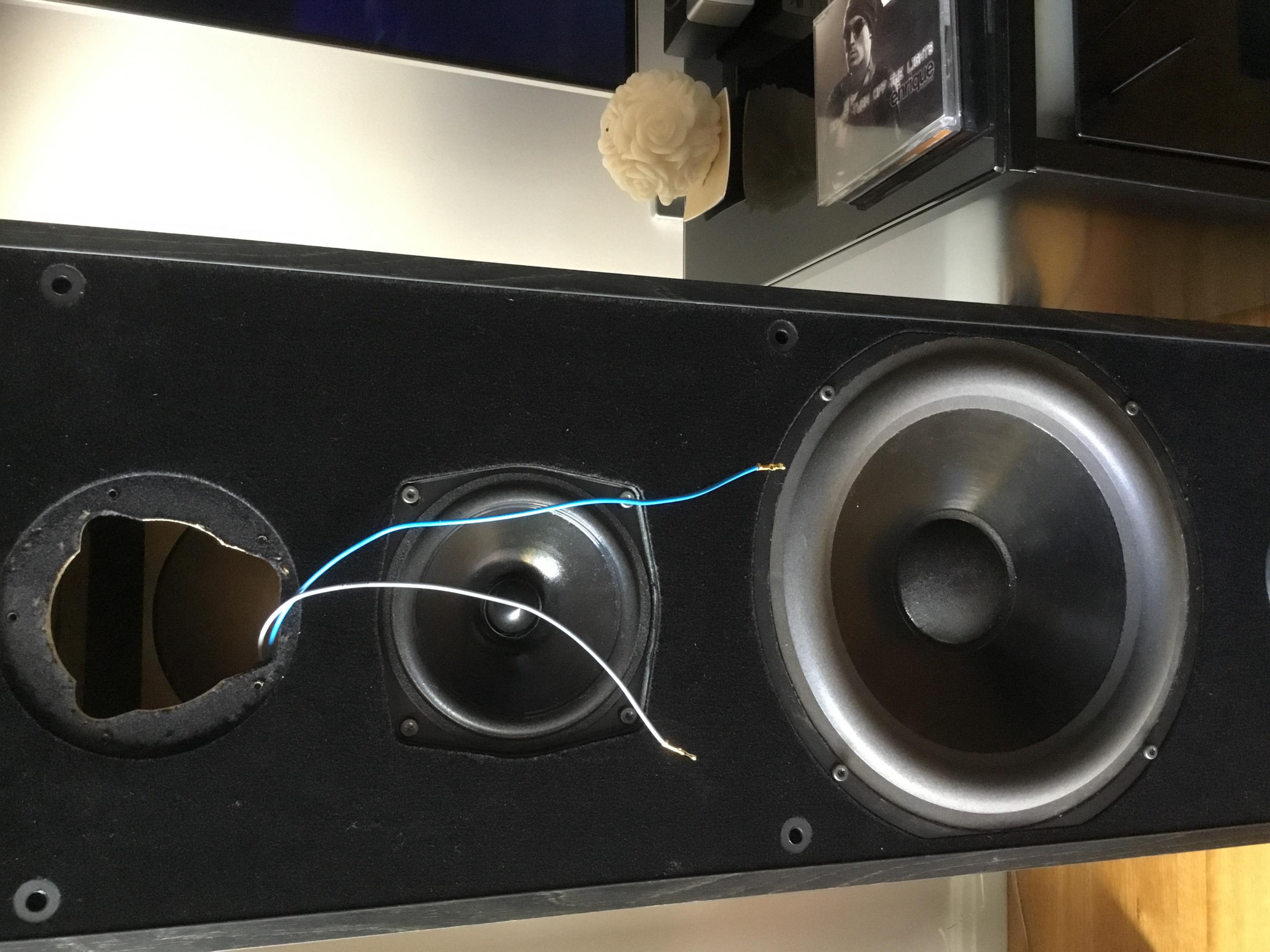

The tweeter on the left speaker column was not re-producing any audio. After many DYI tests , I detached the tweeter and put it on the right side column- it worked. By that, I was able to establish that the issue was not in the tweeter itself. The issue seems to be on the connection to the tweeter on the left speaker column. I see a grey and a blue wire connected to the tweeter terminals. But don’t know where the other end of these wires are. Can the fault be at that other end - wherever it is?

If you look st my post - I had already swapped the tweeter to the other slide and it worked . The issue is on that particular speaker not the tweeter itself.
With the advice given here, I will open the woofer and investigate.

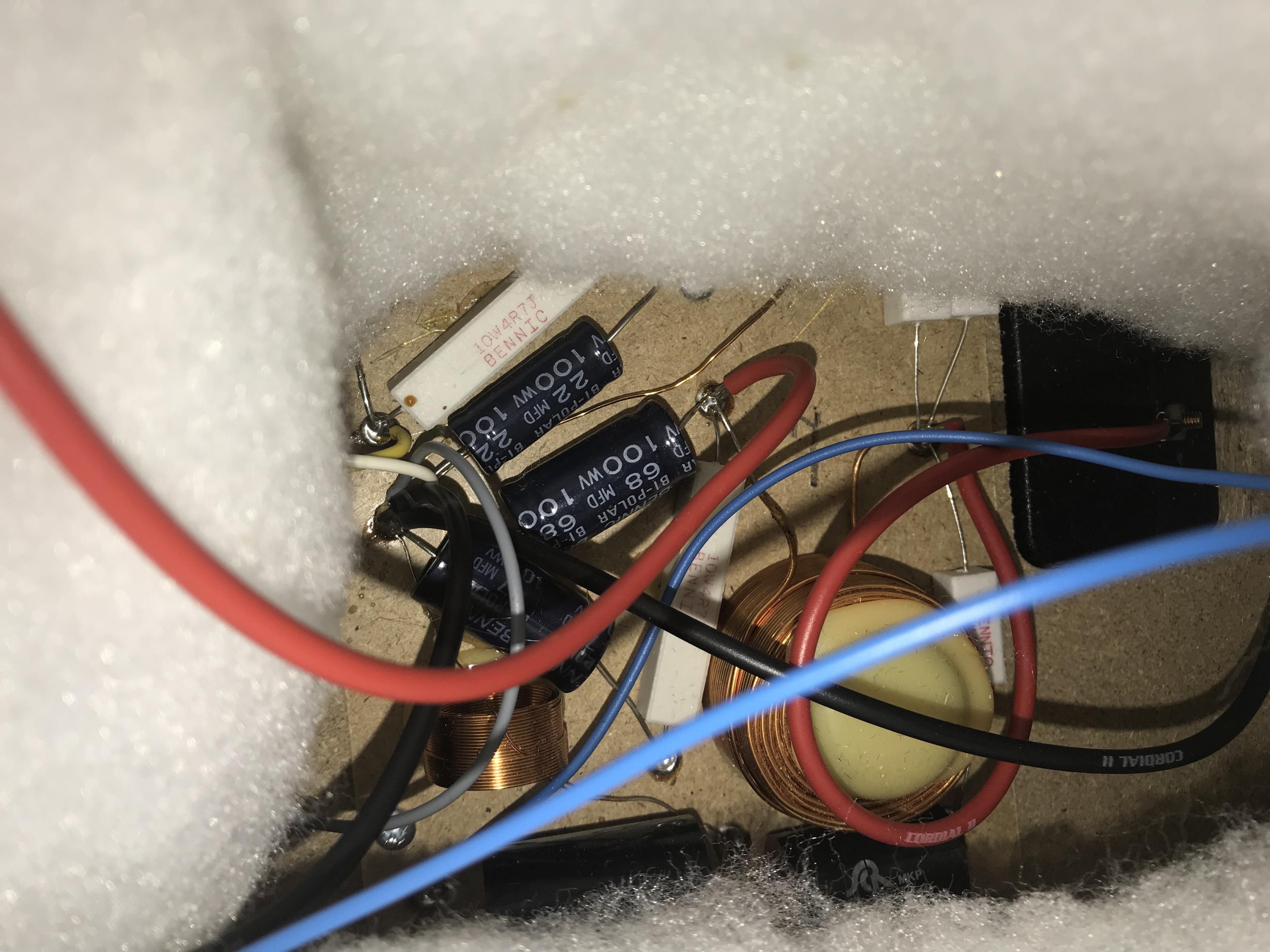

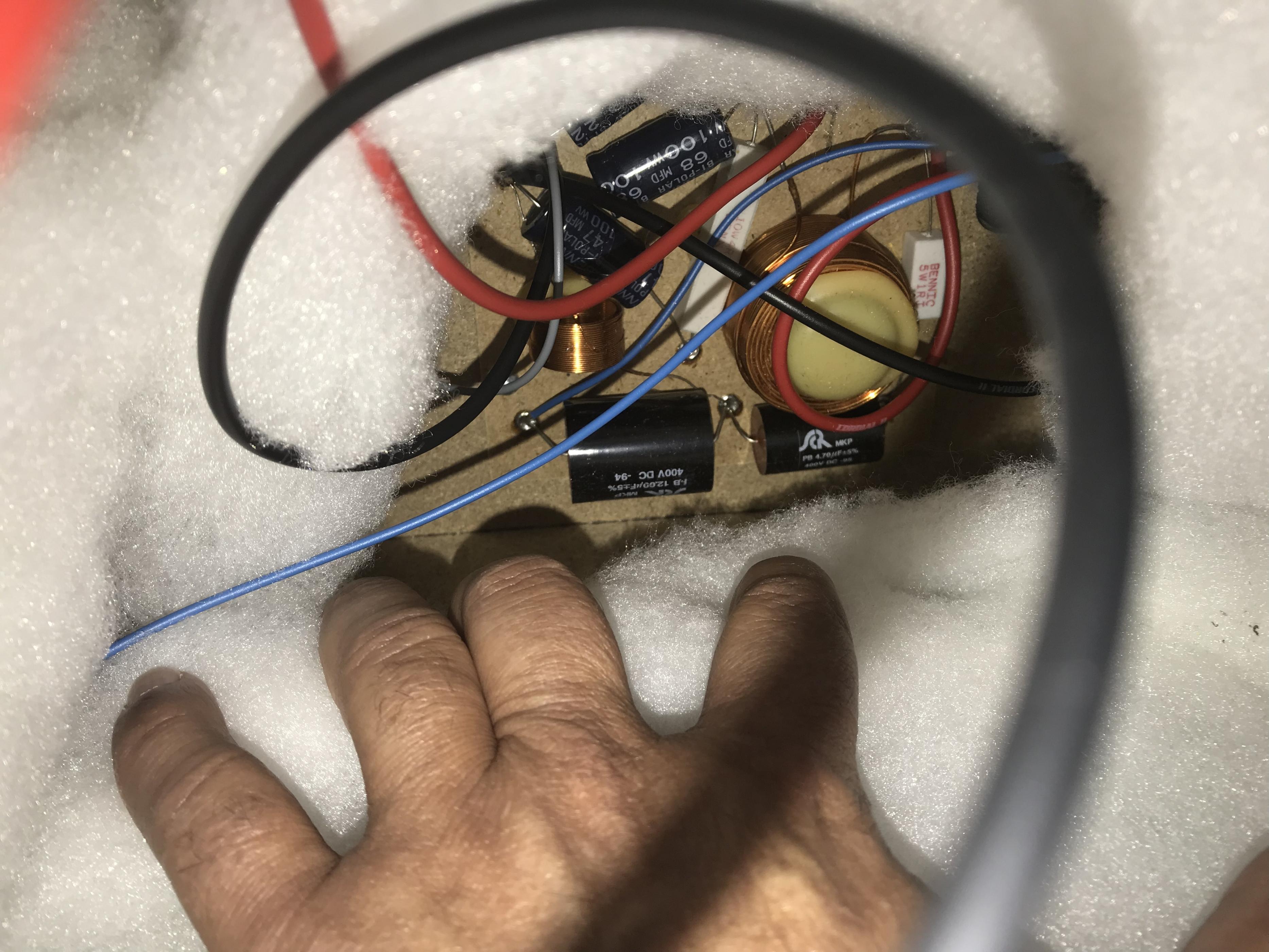

Had some time to open the woofer area and take some pictures through that. The other end of the blue and grey leads are seen ending at the crossover board.
Do these pictures give any clue? Not sure how to get about from here
