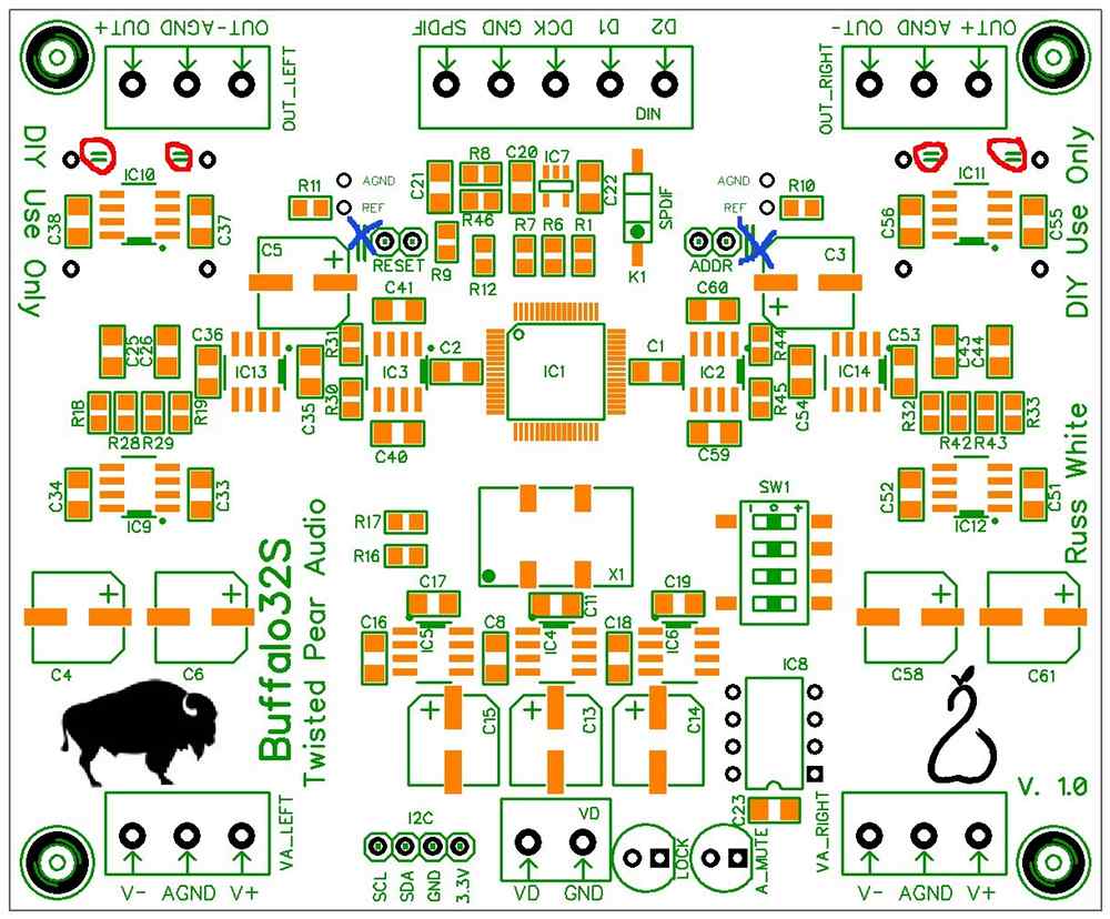

BUF32S output options
One thing you will notice on the BUF32S is that there are some parallel lines at some of the traces on the board.
These lines mark spots where you can cut traces for some optional features.
I have attached an image (this information is in the manual too) that indicates the location of the marks.
The marks circled in red when cut enable 21R output resistors that are normally shorted. Cutting those traces makes the 21R effective. If you are going into an amplifier I would definitely suggest cutting at the locations marked. This is especially true for capacitive cables/loads. You will hear a significant improvement.
If you are going directly out to headphones then you will want to leave the trace uncut. The BUF32S very easily drive almost any headphone. Even 32ohm cans.
The positions marked blue "X" show spots where you can cut traces to allow you to supply your own reference voltage for AVCC. If you cut at the marks specified you can supply your own reference voltage for AVCC. Do not do this unless you absolutely know what you are doing. The standard reference is excellent and heavily filtered.
The reason I included the option was that you can actually slightly improve DNR/THD by supplying a reference higher than 3.3V. 🙂 But you need to be very very careful!!! Do not attempt it unless you have read the DS and understand the risks.
Cheers!
Russ

Re: BUF32S output options
Russ White said:
... So to wrap up, at least for this initial run of boards the best thing to do is the join the GND signals on the board by shorting the pads of L1 and L2...
Just to be absolutely clear, join the two solder points, joined by two white lines (the points are very close together) at L1 and L2?
Russ White said:
...The marks circled in red when cut enable 21R output resistors that are normally shorted. Cutting those traces makes the 21R effective. If you are going into an amplifier I would definitely suggest cutting at the locations marked. This is especially true for capacitive cables/loads. You will hear a significant improvement...
Russ, I'm running directly into some 300B valve monoblock power amps, single ended, from the Buffalo (I just turn the DAC on first at the moment - no thumb-busters set up yet - awaiting manual). Would it be beneficial for me to cut the traces, I presume cut between the lines, at the 4 (red) places you've indicated? Can I do this from the top of the board?
Many thanks, I thought the sound wasn't quite right...
I thought it best to leave it and let you update🙂
Anyway thanks to you lock etc is now spot on!
It certainly sounds better than it did in my set up at least with the grounds now linked

Re: Re: BUF32S output options
rjbaldwin said:
1) Just to be absolutely clear, join the two solder points, joined by two white lines (the points are very close together) at L1 and L2?
2) Russ, I'm running directly into some 300B valve monoblock power amps, single ended, from the Buffalo (I just turn the DAC on first at the moment - no thumb-busters set up yet - awaiting manual). Would it be beneficial for me to cut the traces, I presume cut between the lines, at the 4 (red) places you've indicated? Can I do this from the top of the board?
1) Yes. The pads are close enough that its fairly easy to to create a solder bridge if you like.
2) Yes I would cut those 4 traces. Those only place to cut them is at the top of the board were the parallel white lines are on the silk. The OPA1632 does not like a capacitive load in the least. The 21R effectively isolates it from the capacitive load (cables).
