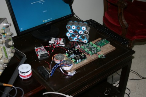

slartibartfasst said:A Buffalo32 running off of batteries.
Oneplustwo: When you have a chance, I'm interested in your opinion of driving headphones directly from the Buffalo32 compared to a dedicated headphone amp. Are you using a balanced B22?

I have seen you are interested in batteries, probably you are interested in my report.
Go to pg.67 nr. 1668 of the Sabre Buffalo DAC thread. There are also posts in the Art of Sound Forum.
Now I have removed all the regulators, even those on the receiver. For the 1.2 Volt supply I had to switch to a NiMh. I have chosen a Sanyo Eneloop, because normal NiMh have a high self discharging rate and the Eneloops have a nice flat curve.
I have asked ESS about the safe limit of the 1.2V supplies, no answer yet, until now I have charged it to not more than 1.32 Volt.
I was certain that there would be no difference between the 1.2V reg and the battery. Unfortunately I was wrong. Now with the new dac there will be 9 batteries.
At the same time the biggest surprise came with the naked Texas TX2575 resistors, which had replaced the Vishay bulk metal I/V resistors (also made by Texas Components). Somebody in the net said they were 10 times better than the older ones. Blabla?, NO! He is right! Now I think about using these for volume control (instead of TVC or LDR) or in amplifiers.
regards Andre
