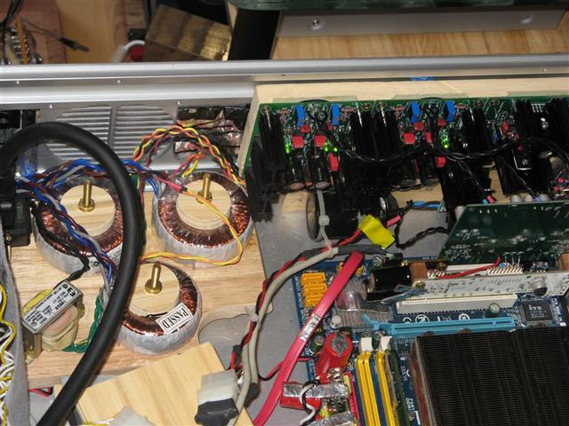

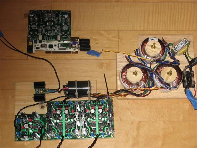

Buff32 in computer audio setup...
I was one of the order-placers.
Hearing a Buffalo32 is great motivation to decide to get one. I've been setting up one of the original Buff32's for a friend. It's for his cMP2 computer music setup. I've posted more here:
http://www.diyaudio.com/forums/digital-source/141451-cmp2-diy-mods.html
But here's a picture of the whole kit in my computer audio setup while I've been proofing it out for him.
Greg in Mississippi
P.S. one question I haven't found an answer for... the Placid instructions say to set it for 6v for a Buffalo DAC, but the DAC instructions say 5v. Which is right?
