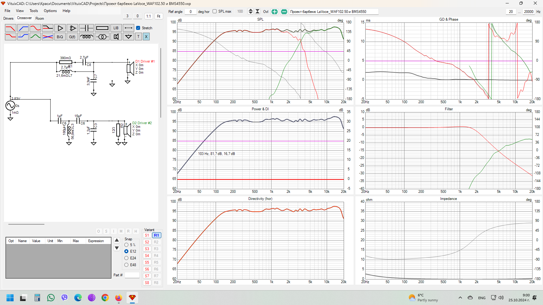

Looks to be missing impedance data, full space data, and no XYZ positions.
So unfortunately wont be valid impedance curve, response or phase information.
Great tool, but up to user to produce correct model.
You have to include full space models from diffraction tool, use driver impedance not generic values.
And assign positions. Correct phase is important or nothing will sum as shown.

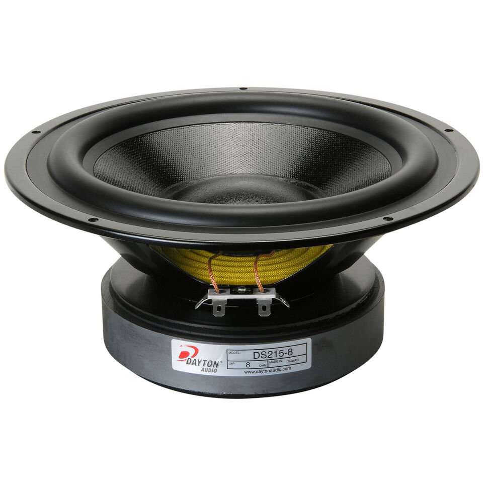

Ran this setup as my test speakers (forum 120W amps) and as party speaker for 15 years. I am amazed they survived the 120W amps (party/drunk).I want excellent sound, but with low cost speakers
https://www.parts-express.com/Dayton-Audio-DS215-8-8-Designer-Series-Woofer-295-430?quantity=1
I just use a pair of generic soft domes from MCM as the tweeters. Looks like the same taiwan driver factory as the dayton DC28F tweeter.
Soundwise they totally blow away either of my Polk's in both image and loudness. REAL good bass @ .7cu/ft with a small port.
Wolverine and Badger proof (120 and 150W ! ).
Only my 8" peerless 3-ways sound a little bit more detailed. Speakers are too expensive these days , just 160 for a pair is
alright for "party speakers" ???
Oh , nearly 90db efficiency , my little 60W Sonance amp rocks the room.

I just found the program and tried with these two drivers how it works. I don't know how and what I should do at all, but I really hope to learn how to make a good crossover. If you don't mind, I'll send you a private message when I decide which speakers I'll get, so you can give me instructions on how to work with the program properly. I have MiniDSP UMIK-1, but i used till now only for measurement and setting of the DSP.Looks to be missing impedance data, full space data, and no XYZ positions.

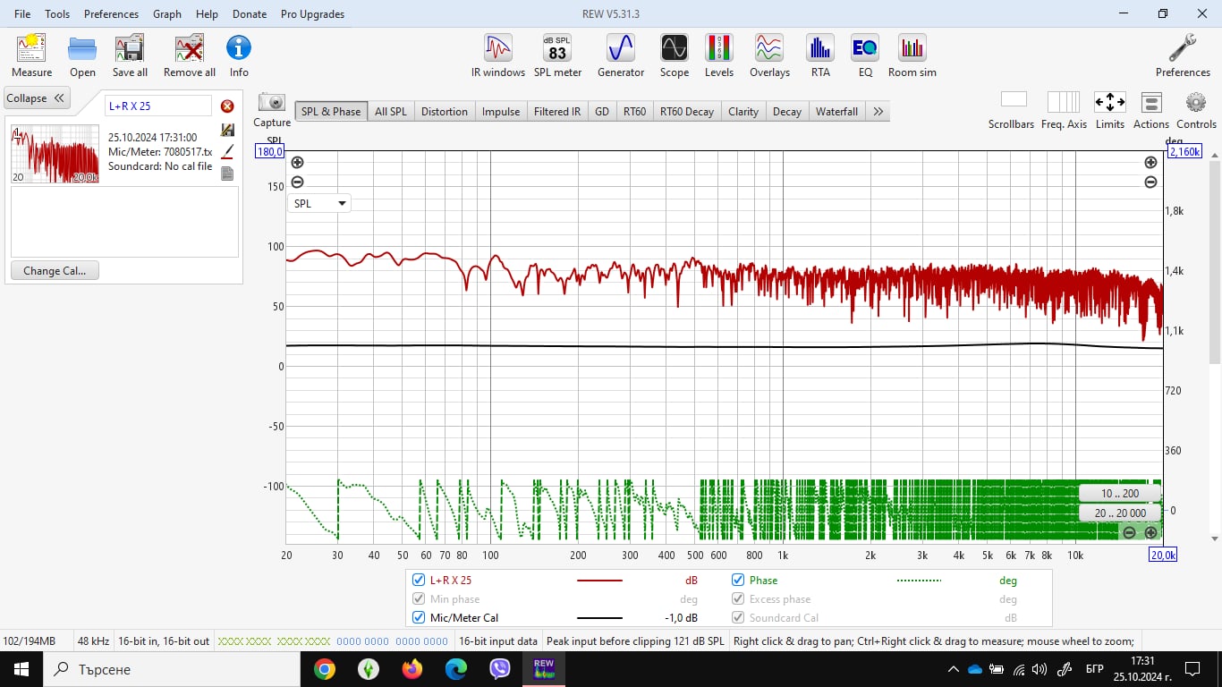

I think your dB measuring system don't work like it should. You probally use a phone and an app, that is not precise at all. If you would measure in that club with a calibrated dB meter you woudl probally get similar results, maube to 105dB if it goes very loud, but certainly not 130dB. You can't handle that, and your ears certainly not.
Can you please explain to me and I believe there has many people like me, which whant to know for what to searching when they see specs of the driver, how to know that this driver is good or not only when see the specs and curves? Or you already listen this tweeter? I truly don't know and i want to know more about this how to choose a driver.Those Lavoces you mentioned won't do it neighter in reality. Certainly that tweeter is trash, the woofer is ok, but not better than the Beyma's i mentioned.
I chek my system now with pink noise and Rew and Umik 1 and its 98db, you are right about this.Sorry, that is ********, 130dB makes you deaf, it's beyond the painborder, and a little under a lethal dosis of sound. It's as loud as standing next to a jetengine of a plane. EU rules are very similar to Belgian noise rules, and won't be much higher than what i said. Even underground raves who don't follow the rules won't go beyond 110dB(A), as nobody wants that.
Btw, i'm also 30 years a dj, and did do festivals and clubs also. Next to that i was also a former sound engineer specialised in high power dj setups. So...

It's a little bit more complicated:And assign positions. Correct phase is important or nothing will sum as shown.
For letting VituixCAD predict the vertical directivity of a loudspeaker it can be useful to enter X- and Y-coordinates. But for working correctly you have to measure each driver on its own axis.
But if your measurements include valid phase informations by having used a timing reference while measuring (like recommended i.e. for VituixCAD), entering values for the Z-coordinate could be even harmful.

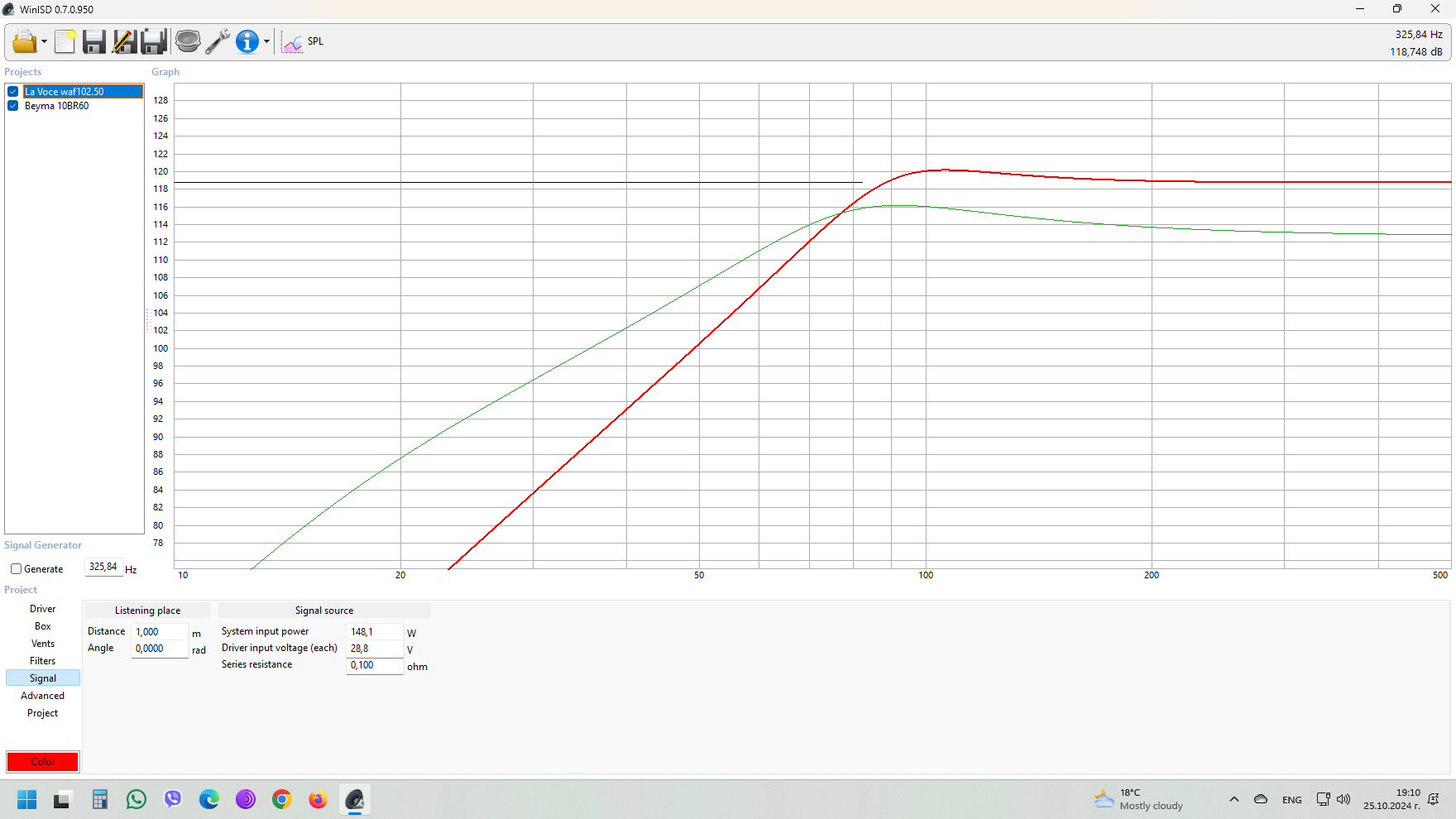

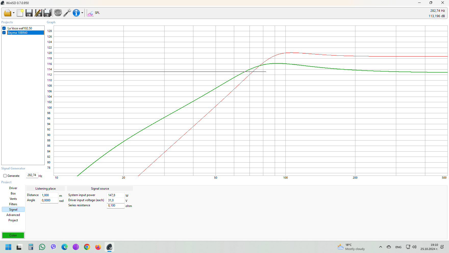

I have space only for 10 inch not more!
I check the Beyma and the Lavoce and this is what i look for.

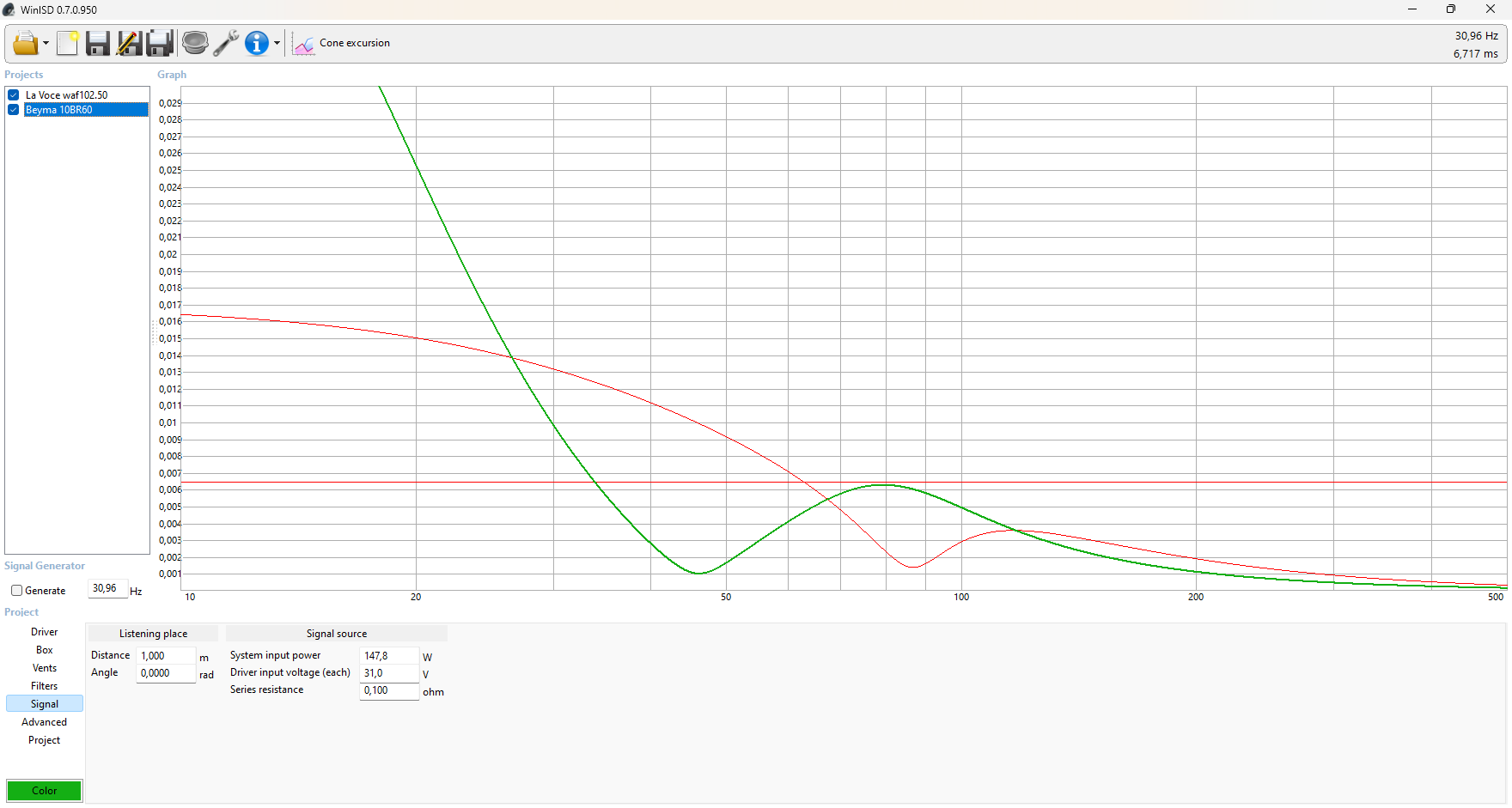

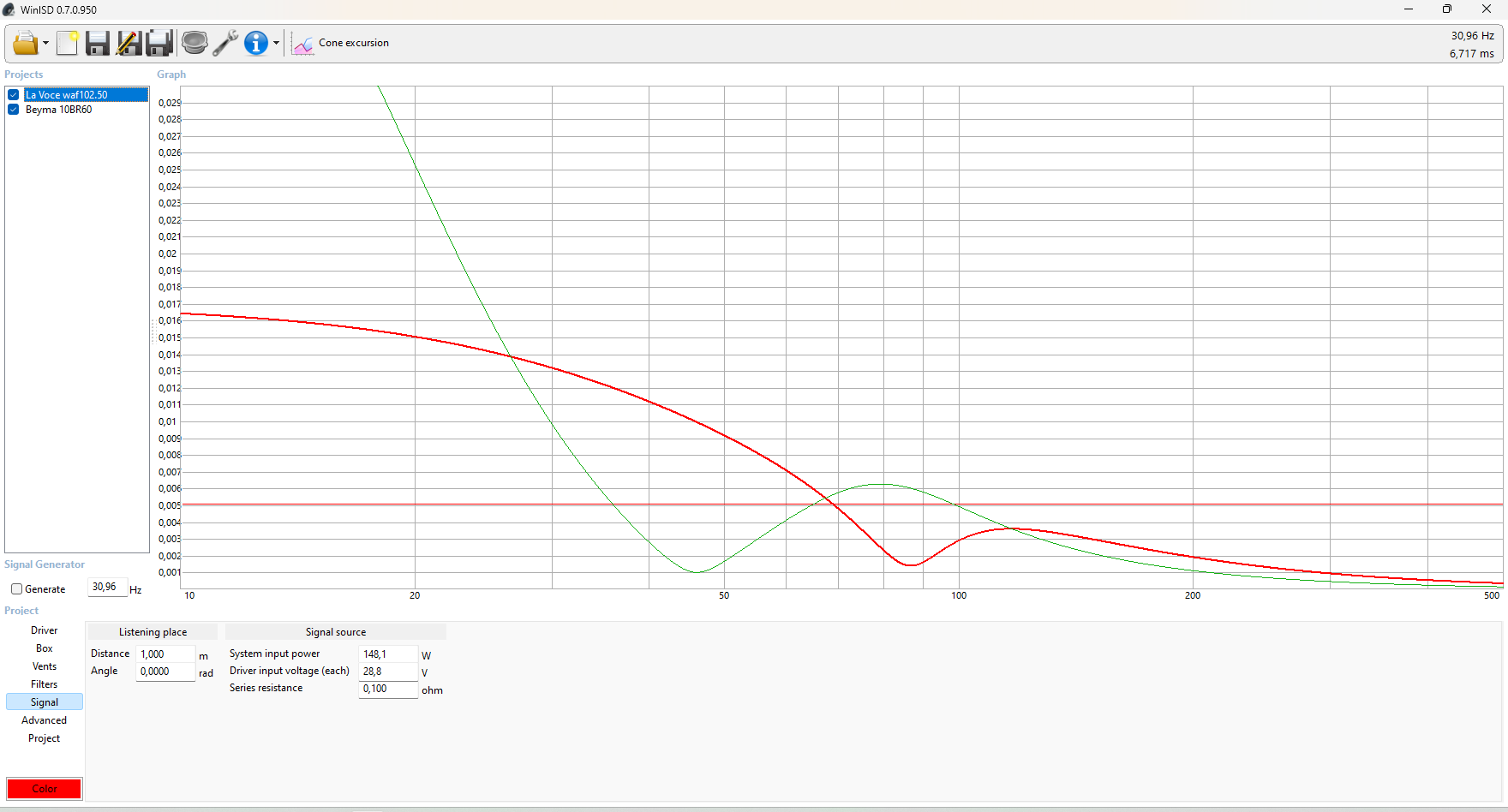

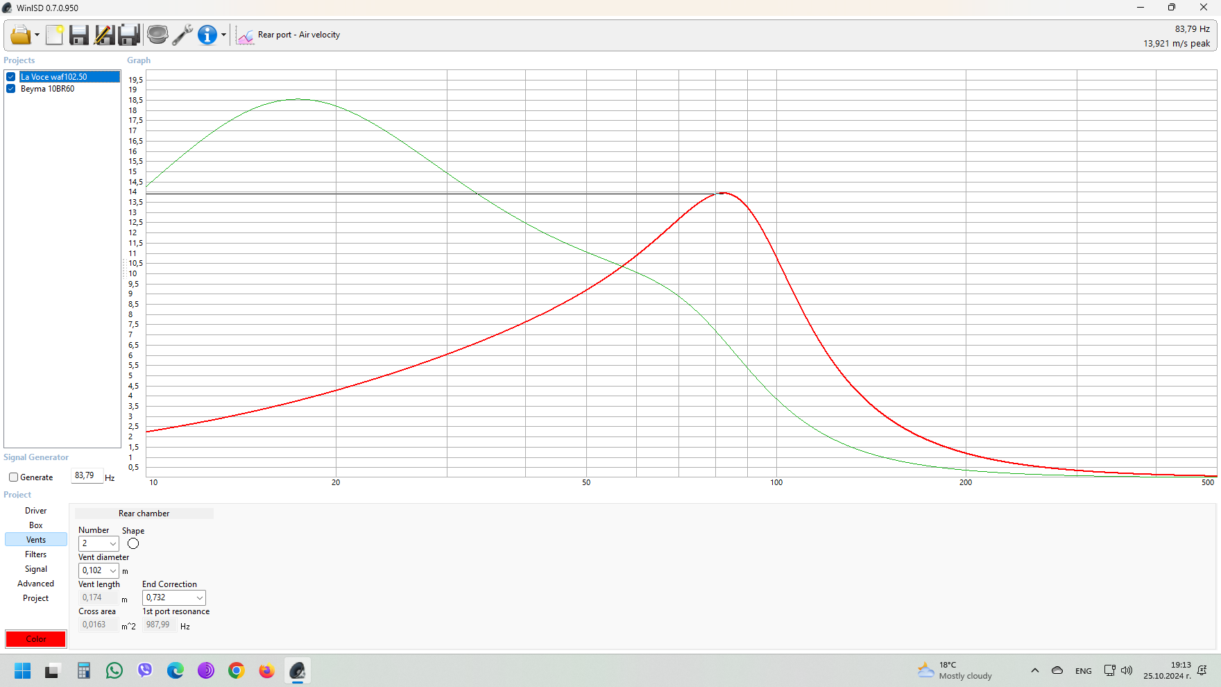

Cone excursion to be low than this red line, SPL to be more high and Rear port air velocity in same box but in different tuning frequency and same system input power.
