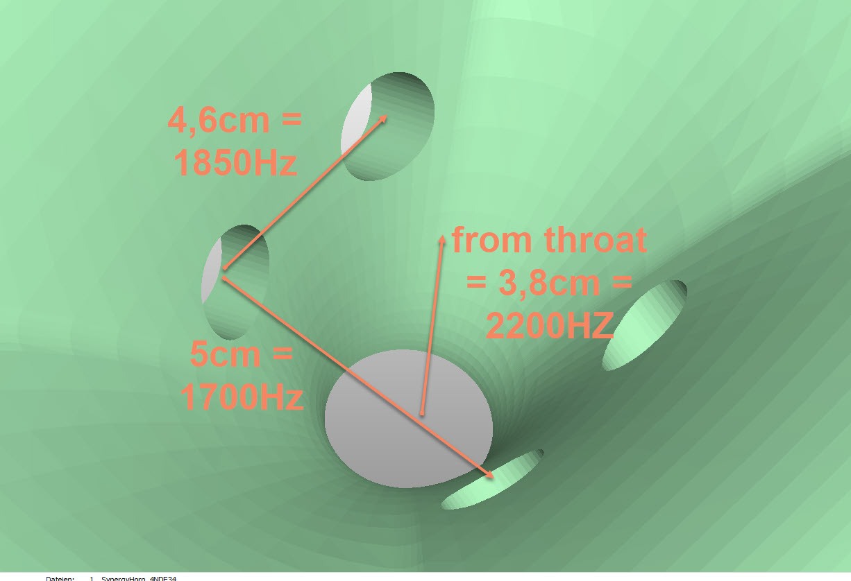

Earlier, in post #5, you asked if 1/4WL between mids to CD, the distance to the throat or to the diaphragm. Great question, often discussed.
Dang if i know, and this is even after the chance to ask TomD this exact question in person. Loosely quoting, he said 'to the throat, and to think about it, all the sound is going out'.
I said ok, thinking it would get clear after mulling it, but it hasn't become clear at all for this old dummy 😕😛
If fact, I'm more confused than ever, because careful measurements always place the apparent acoustic center of the CD in front of the mid low drivers apparent acoustic center. Go figure....
This timing phenomenon has been on 6 different horn patterns and port placement schemes, corners vs centers. With No filters in place for timings.
All used a coax CD crossing at 500-650Hz, straight to mids designed to reach down to 100Hz. Pairs of mids varied from 12" to 8".
I continue to get near perfect, flat mag and flat zero phase response, using pure time delays applied to the CD as per the above timing measurements.....
(FIR tuning with linear phase xovers that don't introduce any relative delay between driver sections.)
As far as the frequency of the notch being the best way to determine, I guess that's it. Because timing's sure don't seem to match up with either distance.
Anyway,.... to the throat?, or to diaphragm?..... i plain dunno !!!!

FWIW, Altec told me in '68 that the acoustic center sets on the face of the phase plug [narrow gap between it and the diaphragm], but published it as the center of the VC like a point source driver at rest since it was well within the 1/4 WL rule.
Fast forward to the late '90s? and Tom Danley said he'd measured the same when somebody told me I was clueless, so not sure if he was phrasing it a bit different or if some newer CD designs are different than the typical 'classic': http://www.lansingheritage.org/images/altec/specs/components/802d-804a/page1.jpg

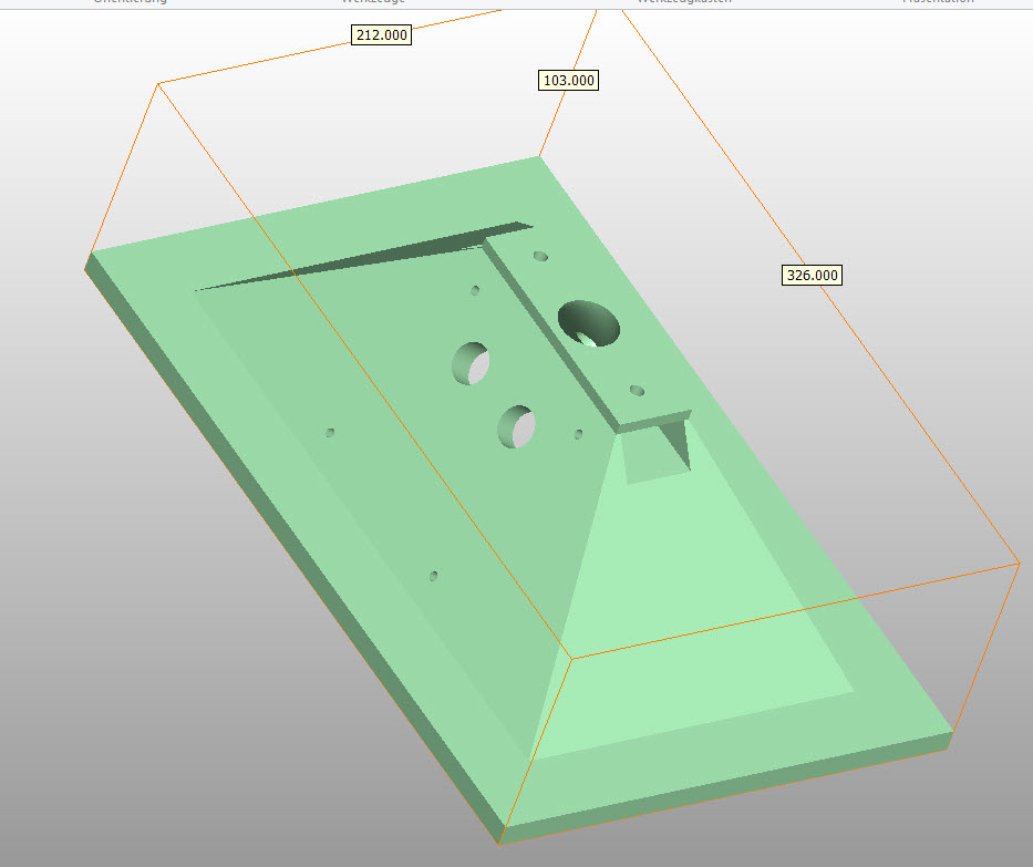

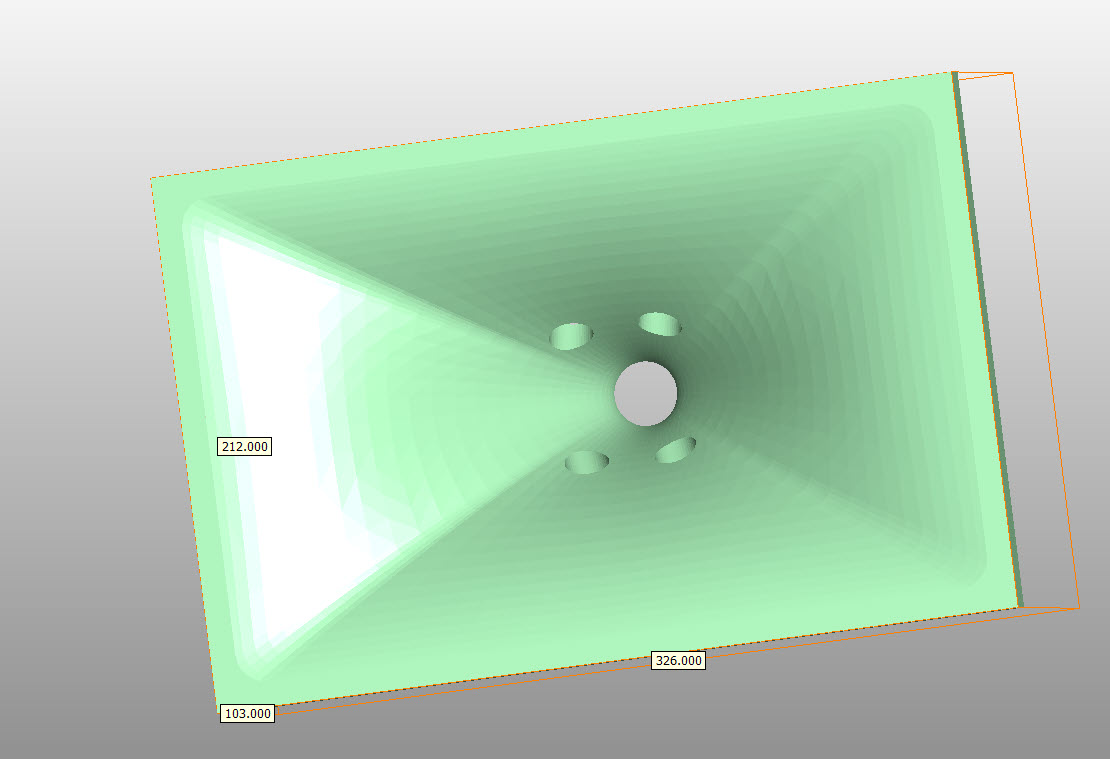

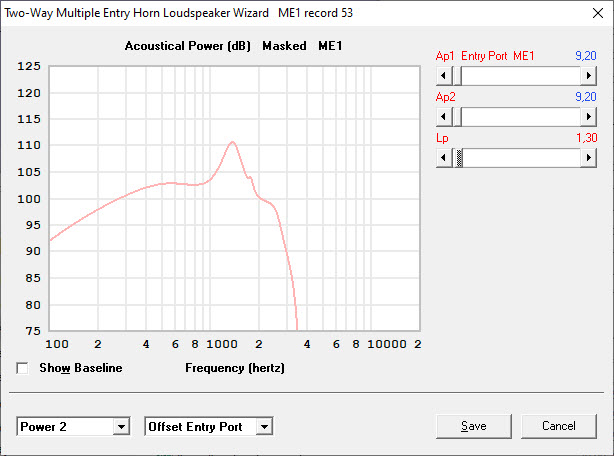

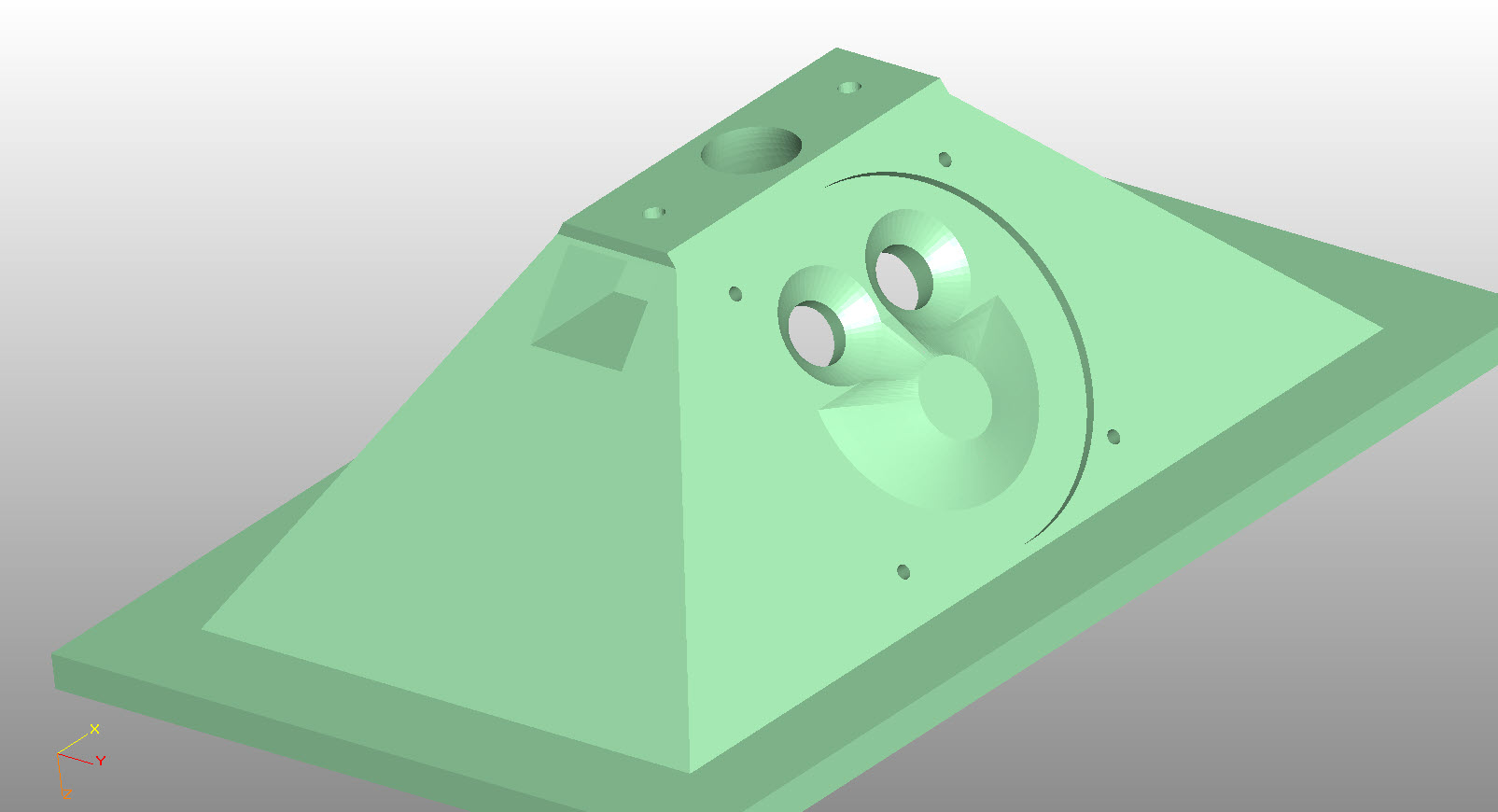

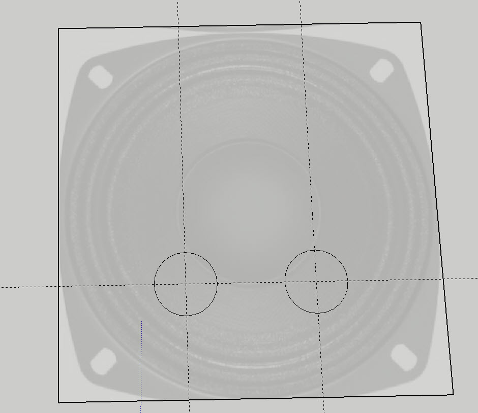

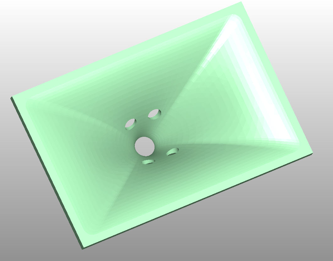

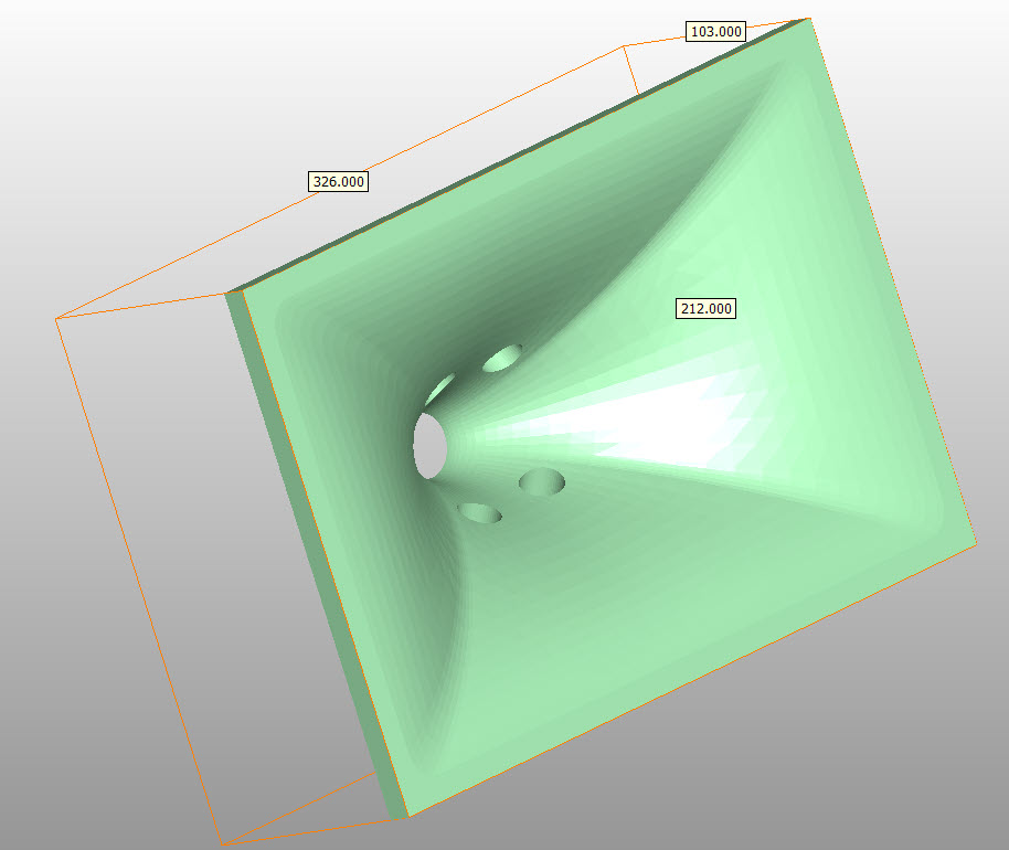

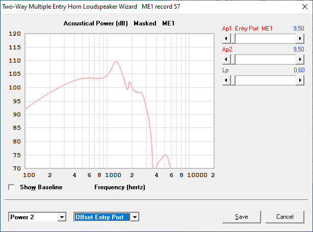

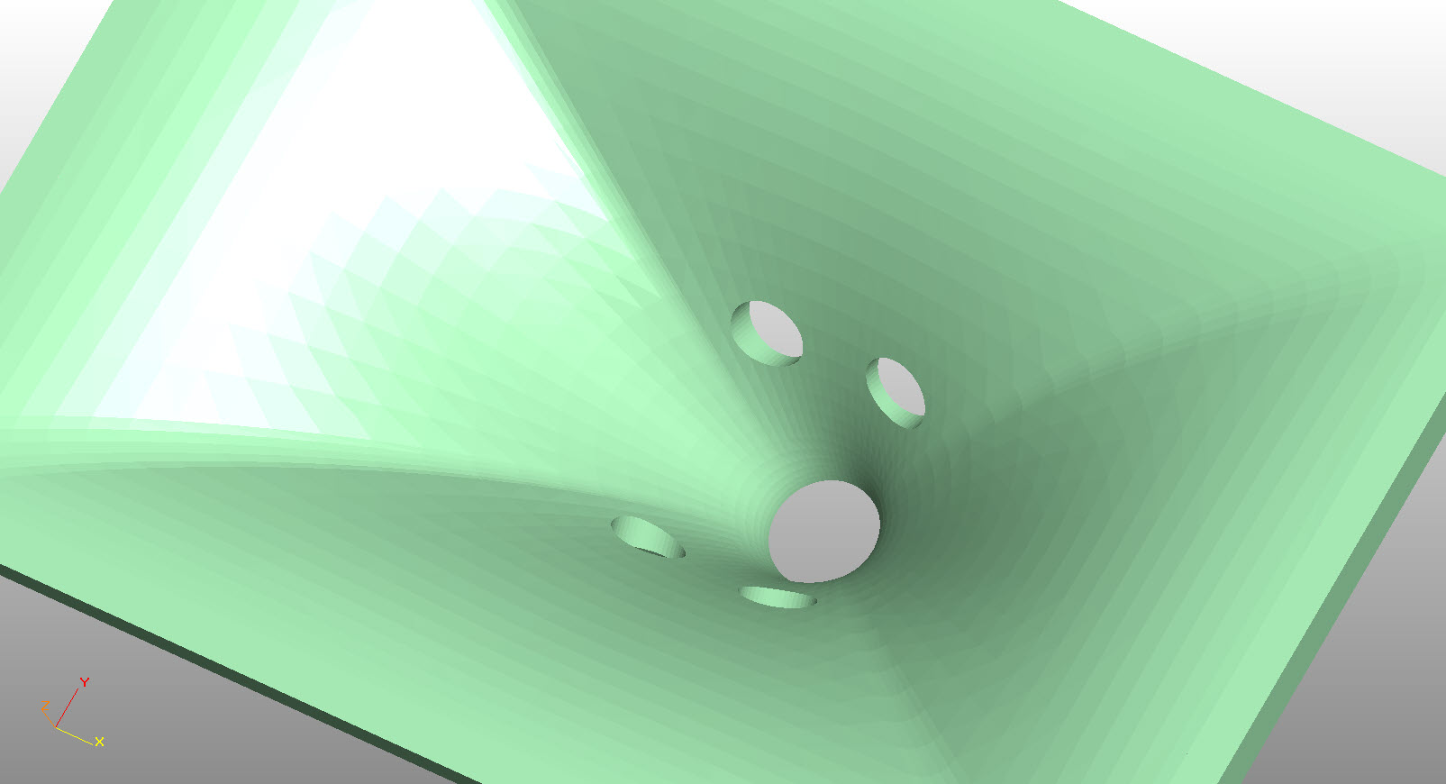

I modelled a bit more and it turned out that the B&C 4NDF34 seems to be a very good idea. I modelled my horn with two of them (2x 8 Ohm parallel = 4Ohm) and they are louder than four of the 3fe22 (4x 4Ohm; 2P2S = 4 Ohm) (104db instead of 99db) and the maximum spl of them is also louder than four of the 3fe22 (124db vs. 117db). Also they are just big enough to put them on my up- and downside. I tried to manage to put them as near as possible to the throat which results in that the distances of the input slots (middle to middle) are very good and should work for 1,5khz crossover. Also using the 4NDF34 allows me to put the input slots not over the surround. Looks promising so far. Maybe I will make an test-print. Volume-Fillers in Chamber are currently missing because I do not have the driver to measrue exactly the cone. Any recommondations?

A good ROT for driver selection is Fh = 4*pi*Fs tuned to Fc = [Fl*Fh]^0.5, so is Fs a bit lower than published?

Another question. When building the version I just posted with two 4NDF34 I would pick a wooden case completely around the horn for the two 4NDF34 which means that the two 4NDF34 will play in around 7 litres closed box. This will result in a realtive high Q about 0,317. I don´t want to build custom "coffee mugs" for the drivers because it´s lot of effort doing this. Is there a disadvantage in midrange quality when runing them in "too much" litres?
I'm not the best to ask about modeling or how T/S parameters work.
But i just add foamboard blocks cut to fit to take up excess volume, when model says to, and then compare before and after measurements for overall shape of response.
No clue if it really effects quality that much, other than shape of response curve.

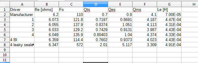

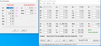

Ok so I had a look in my data for the 3FE25 and I don't have the original impedance sweeps just a table of some results. It looks like the big difference between the manufacturers specs is the inductance?
*not sure what 4Bl is
**leaky sealed is when I taped over the back of the basket

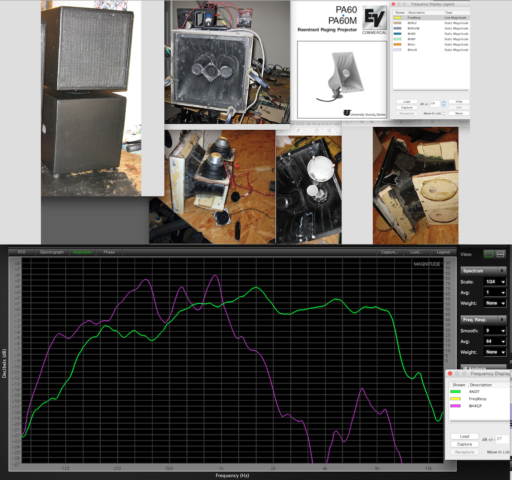

I used four of the 4NDF34 in a one cubic foot gross volume MEH, they have around 3.5 liters apiece. Also tested them in a "coffee mug" box about 4" x 4" x 4" interior, about 1.3 liter. I'm using one 4NDF34 in a 4.5 liter box for my home theater center speaker run full range, no HP filter.
The smaller box rolls off at a higher frequency, and limits excursion, but even in the larger cabinet volume, the 4NDF34 does not sound distressed when pushed beyond Xvar (5.7mm).
On the MEH, used a 1/4" standoff (about 5mm) which seems to be enough to keep the surround from hitting no matter how much voltage the driver sees.
With no cone filler, probably could cross as high as 1600Hz, 1500Hz should be good with the cone contour filled to within 5mm.

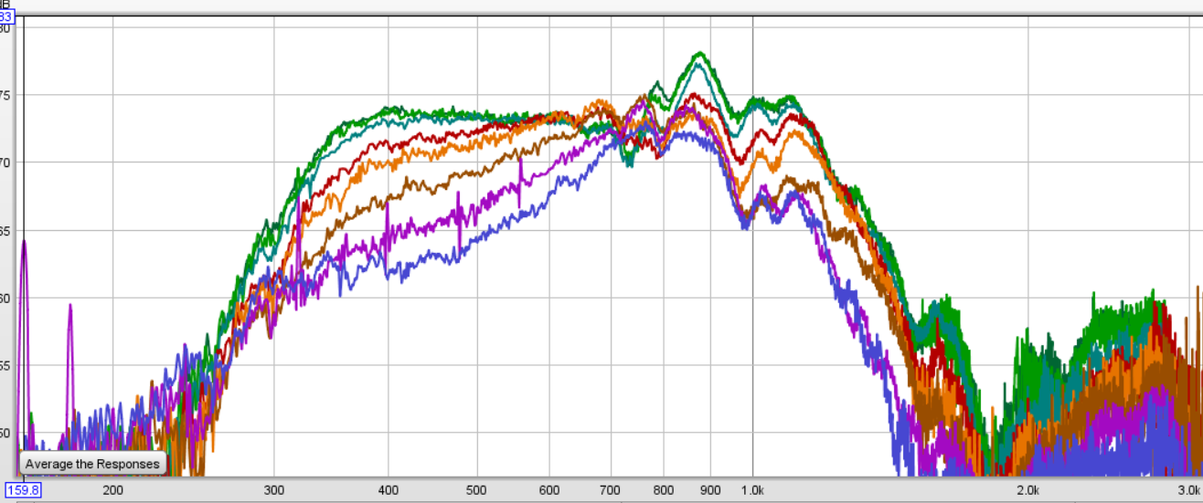

The green trace below is the 4" cube box, the purple is the four drivers on the dual PA60 "Boat Horn", raw response. The 4NDF34 ports enter about 2/3 the distance from the folded horn throat to the mouth, resulting in little horn gain and response dips. I had originally planned to cross around 450 Hz to the PA60, but the 4NDF34 sounded so much cleaner at high volume I raised the passive crossover to 900 Hz.
Covering 300Hz-1500 on a MEH, two 4NDF34 will probably outrun any 1" exit HF driver.

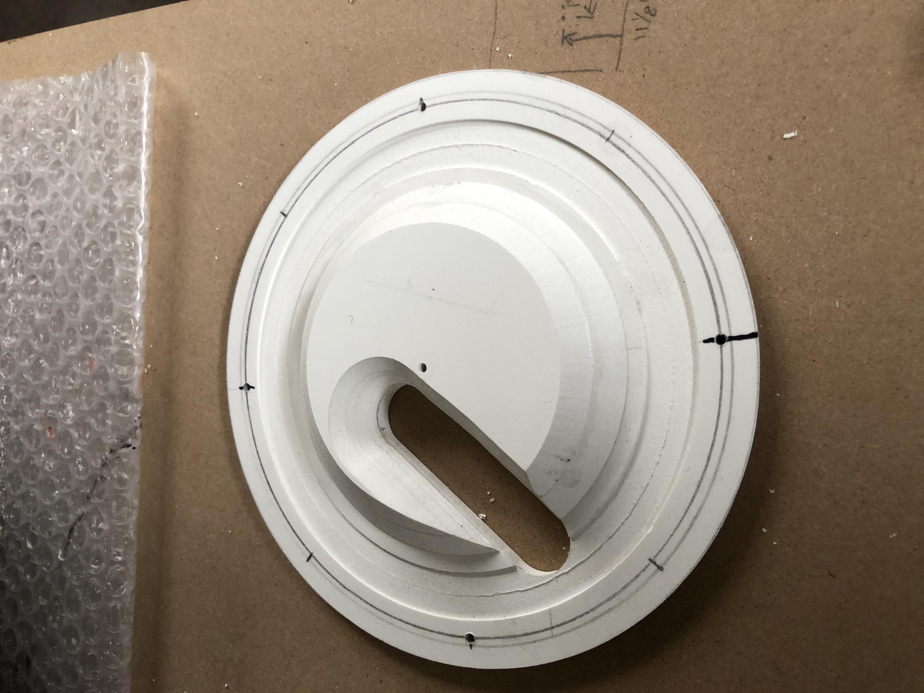

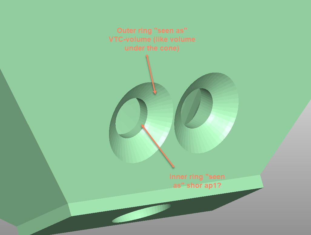

I now have the contour of the cone and surround for the 4NDF34 and now could model with correct VTC values in hornresp. And now simulation does not look so good anymore because VTC is more then expected and also need to offset the driver a bit for excursion. It´s really a mess. If I move the driver nearer to the horn to get shorter Ap1 the horn walls gets to thin for 3d printing. If moving back and horn walls are ok, Ap1 gets to long and frequency response is falling down rapidly at 1khz (regarding hornresp). Sure I can imporve with space fillser in chamber to reduce VTC but really difficult to get all these values together to get a nice simulation and also a solid horn surface for 3d printing.
To minimise this issue is it maybe an solution to flatly reduce the input slots with a second ring around them like in the picture attached?
Hoping that the reduced ring around the offset "is seen" by the driver just as space belonging to VTC volume and just the small inner ring "is seen" by the driver as Ap1. That would make it possible to make thick horn walls but shorter ap1 Offset ports. Does this work as I expect?

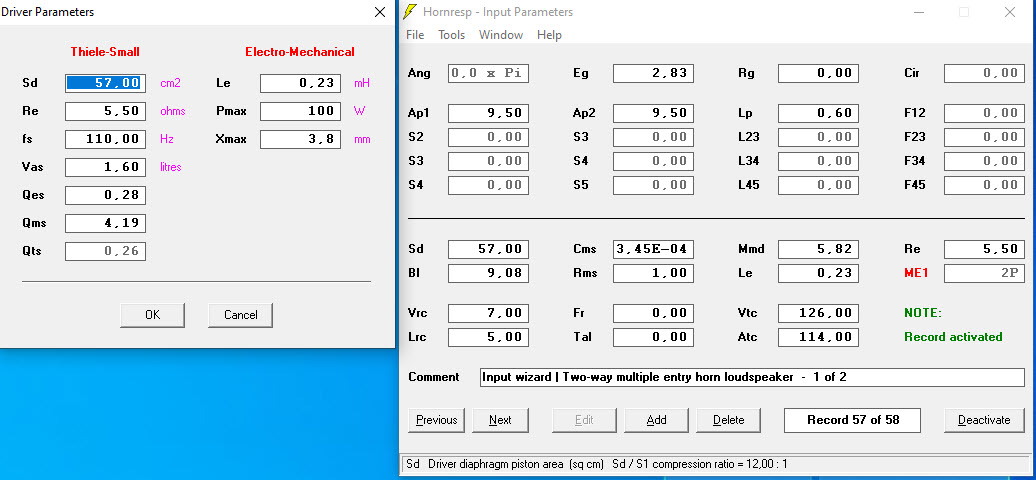

ok next try. Simulates very well in hornresp, if assumtion, two posts ago, that first circle belongs to VTC volume and only second ring assumed as ap1 length is true. Solit horn walls with at least 5mm (on weakest point). Maybe this will be my first prototype print.

I have simulated the excursion in hornresp. When crossing at 250Hz/2nd Order at 200Watt (100 Watt each driver) the horn is already at 124db/1m. The excursion is then at 1,7mm each driver. I plan to cross a little higher (maybe 300-350Hz) and I do not know if I will ever put 200Watt into this horn because using this in home cinema environment and not PA. I have now build the VTC-fillers that everywhere is 3mm excursion capable before hitting the chamber. I think that should be enough for my needs, or does anybody see any issues there?
3mm before contact should be plenty for your application, the compromise between HF extension and LF excursion fits your plan.
That said, you could also use the same drivers for a "full range" center speaker (and surround speakers) which would not require using additional 12", so could fit below the cinema screen. In which case having the capability to hit Xlim without cone contact would be useful, as the excursion at 100 Hz would be much higher than the L/R speakers.
What does the simulation look like when the throat chamber distance is increased from 3 to 5mm?
