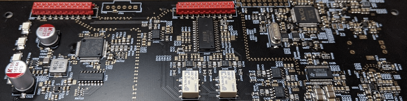

Hello,
I told about freertos because I've already a stm32 on my design runing under freertos, I use it to make simple tasks like led management, control volume IC, rotary encoder reading and some GPIOs to drive my analog parts. The certainly possible but not easy for me would be to have a single MCU on my design who run my freertos with my taks and also a UAC1.0 and also a SPDIF to I2S (UAC and SPDIF don't run same time it's UAC or SPDIF). The design I speak about is a digital board for a hifi amplifier.
Here is the board I speak about:
Today a STM32 for the basics tasks and a XMOS for digital audio.
I would like to move only on STM32 :)
So I know a little about C and STM32 lib, I write the fw myself with Keil IDE (there is a free license for STM32 with M0 core only) and I'm afraid about the IDE from ST based on Eclipse (I don't like it) necessary for dev on more powerfull core like M4/M7.
I think redesign the board with a single STM32F446 but before I will test on a nucleo board, first task will be to try the implement of UAC1.0 but with external clock (certainly a PL611 who generate clock for 44.1 and 48/96) to be frequency accurate. After I will try to do the SPDIF to I2C also with external clock also.
Maybe it's more reasonable to pay a skilled a developer if I want unrisk my project.

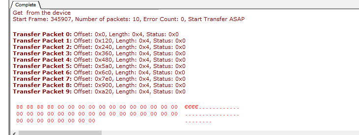

Somebody have experience with stm32 usb audio in mic mode(IN)? My device is detects, requests come from host. I send data, but on computer side i get only clicks. I have checked with usb sniffer and see that packet have only 4 bytes size. I am sending fixed data so can definitely saw. Instead of 288 bytes come only 4 bytes. Somebody had this issue?
Thx
My boards have both UAC2 OUT & IN. Here is the source code for UAC2 IN for STM32F723E_DISCO board:
https://www.diyaudio.com/community/threads/uac2-i2s-input-on-stm32f723e-disco.393702/
Thank you! It's look very close to my realization.
I am new on this forum so can't write PM. Uploaded files here.
My problem that is in even device in IDLE and send the dummy buffer - it length only 4 byte.
I am filled the dummy array with 0x88 for debugging. DataIn callback working stable.
If i send real data it also send only 4 byte length.
