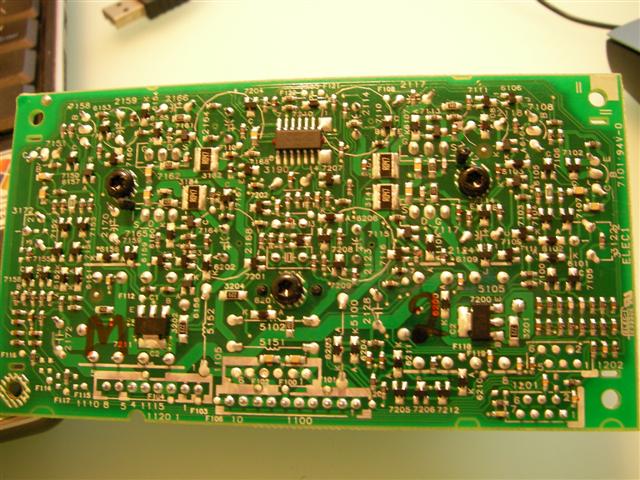

nFORCE said:Hi,
I have this board on hand, only one 74HC14 SMD on board, all are transistor, many pieces, all SMD.
Output is TWO of Mosfet.
Will post the picture at tonight.
nFORCE.
Nice pics!
As far as I can quickly see in the schematic the gates in the 74HC14 control SMPS and UcD-clock in case of overload. The gates are not in the signal path!
The two small pots on the board control output bias.
May be handy when you want to connect ESL's. The factory not always adjust these very well. The outputs of my DFR9000 are around 20 mV.
