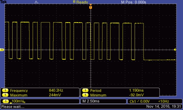

The resistor is 100 ohms... I take another waveform that should looks more clean
I tried other remotes and also to reprogram the remote.
The wave form is the same for all what I tried.
The +V is 3.18V. The output is normally high at 3.16V and drop at 1.8V when I send the signal.
I also rechecked the ARM but everything seems ok...I can't figure out where is the problem

Ok then no problem this is the right version, V1.1 has a different pinout but nobody has some except me.
They work perfectly fine as well just the MCU pinout is a bit different so for a minute I had a doubt.
But I never shipped any so no worries.
Still I don't understand why the level is 1.8V or a logical 0...
If you remove the IR sensor do you have a 0? No short with a bad soldering to the neighborhood pin on the MCU? (89, 90, 91)

I dismounted the IR and I have more or less 0,8V of the out pad.
I rechecked carefully the pins but everything looks fine. The board with the exception of the remote control is working perfectly so I would be very surprised if the problem is in the ARM.

Example TSOP2436 IR receiver response to my RC unit (from testbench so not necessarily a valid RC5 or NEC IR commands):
Signal commutes from 0 to 3.3V - yours seems definitely faulty.

So, looking in the waveform my IR doesn't work properly. I don't have a new one, today I will order...
Alex, the 0.8V are measured in the pad of the pcb where is connected the IR output.
What should be the expected value there? I hope to do not touch the MCU
