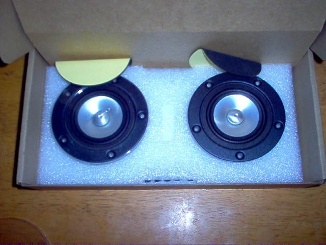

Well, he's cerainly added a number of enclosure links, as new ones are developed. The data sheet has always had the spec. on it & the data was on the site also -albeit admittedly you have to scroll down the screen a bit.I have no beef with Stefan at KJFAudio. Consider him a friend.
But, TBH, he has furiously updated his website lately.
https://kjfaudio.com/product/chn-50/
Shouldn't be any lower than it would be in a 2-way, if you select your crossover points & design the filter well. They're both going to be a nominal 4ohm through a portion of the BW, and as noted, that shouldn't trouble almost any amplifier these days. If it does, it's probably worth replacing. Certainly nothing in my inventory would so much as bat an eye at it, including a 25 year old entry level Rotel integrated (first version of the RA931) which would cost peanuts to buy second hand.Thing is, an 86dB 4 ohm driver will cause me problems in a three way. Low impedance.
That said, I'm not sure I'd bother making a 3 way with a CHN-50. Since it makes a good mid-tweeter, I'd just use a low-filter 2-way like the pioneers did. That's actually more or less what I would have liked to do with the MA-Sota commercial gear (the CHN50 is closely related to the Sota 5 mid-tweeter), but I wasn't able to due to cost & space considerations over the components.
