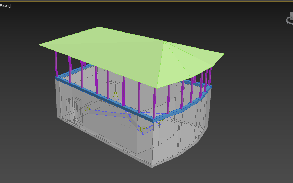

This is the current design - coffin shaped and with roof and floor tapering as well. Room will be totally deadened (with 1.6m of rockwool behind the main speakers 1m on the rear wall and 20cm floor / ceiling / side walls) and then strategically brought back to life. Total footprint is 13m long x 8mwide at the widest point and 3.5m high tapering to 3.2m at the rear. In the middle of nowhere so no issue with sound spillage - only needing to get it right internally so no need for floating floor etc.. This could be scaled / adjusted though.While there's a lot of information available online....there are a lot of pitfalls that take experience to avoid.
You'll need to define listening distance, output requirements, coverage pattern, room treatment, etc.
I'm sure there are budget constraints as well.
So the primary goal is to have a full range mastering monitor setup, so optimising for that from the point of view of listening distance output requirements, coverage pattern, room treatment, etc. but I would also like to have to have the ability to turn it up to an enjoyable level.
In regards to budget dont really want to go into extreme esoteric territory but happy to spend whatever it takes to produce something that meets a premium standard in regards to the mastering objectives.

Seems some kind of LEDE setup, isn't it? I think studio design has evolved since then.I'd start into 4" rockwool (fabric-covered) about 70% of the way into the room and covering the wall's and ceiling (with a very thick carpet and multiple carpet pads in that same portion of the room) all the way to (and including) the "rear wall".
At the loudspeakers and behind them I'd have a "live" symmetrical space without diffusion or absorption (like hardwood floors and double/triple walled sheet-rock with a skim-coat of Weicon 310 M in-between the sheet-rock) for good specular reflections at the front line of the loudspeakers and behind them.
