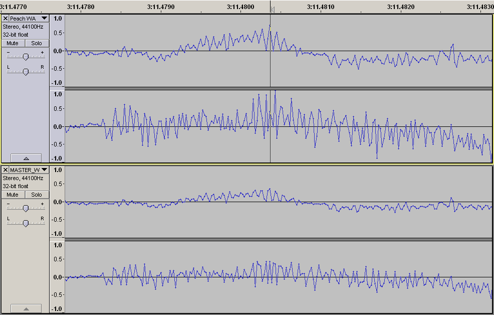

Is there any music content in that "extra" signal? Or, is it all well above audibility?
I think the laptop A/D process would stop anything over 22.05kHz
I wondered too whether its just an artifact of the way its observed in Audacity.

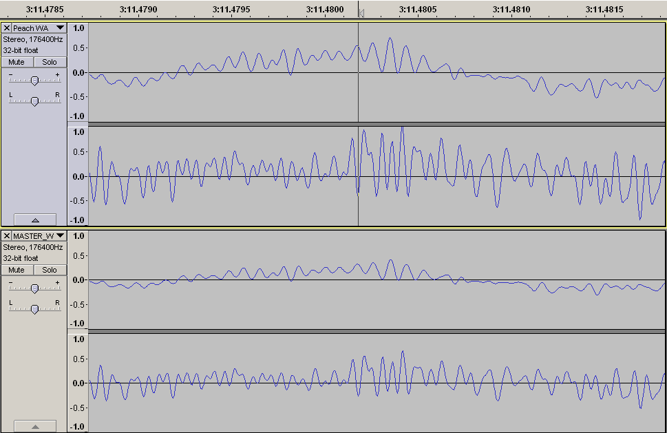

OK, looks like a false alarm - so easy to get fooled by the reconstruction 'magic' at the output of the DAC. Resampled to 176.4kHz, so the waveform starts to look a lot more 'analogue', and the seeming artifact disappears ...
The problem "appeared" to be there because of the precise timing of very high frequency audio peaks:

That's it! And that's also the reason why I like 24bit files at high sampling rate, but they are soooo long .....
And, if you look at sample values only, without reconstruction low pass filter, it is really hard to tell ...

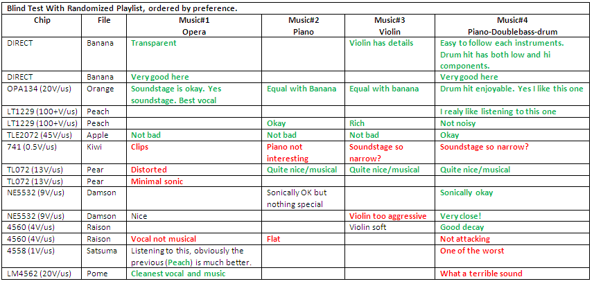

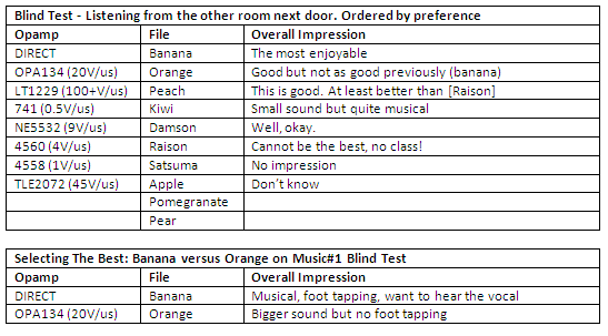

When I looked again at my blind test notes, I feel it might be useful for future reference. Accuracy aside, it was a very honest perception because it is a blind test. There are other impressions that I didn't documented, such as when I found the music was so enjoyable or so terrible in the background, I checked my iPod and it was always associated with banana (direct) and satsuma (4558). Pomegranate is unique as it has special quality to the sound but perform terrible.
In the second picture you will find my final blind test regarding banana (direct) and orange (OPA134) to decide which one is best, because from the early blind test (picture one) Orange "outperformed" banana due to the soundstage, vocal and its ability to round the sharp ends (violin). After the final blind test between the two it was clear to me the superiority of the banana.

From my blind test notes, the chip performed very well with complex passage or high speed (and it's just a trio). Coz the other high slew rate opamps have similar tendency, I must state here that my notes regarding lm4562 ("what a terrible sound") was not addressed at music#4 (the trio). I just don't have the column for general impression there.
This might be used in the "marketing" of such opamp???
This is as good an example as any of the fact that putting high performance parts in a situation guarantees absolutely ... nothing - quite often it will make things worse! The word is balance, balance, balance ...Coz the other high slew rate opamps have similar tendency, I must state here that my notes regarding lm4562 ("what a terrible sound") was not addressed at music#4 (the trio).
