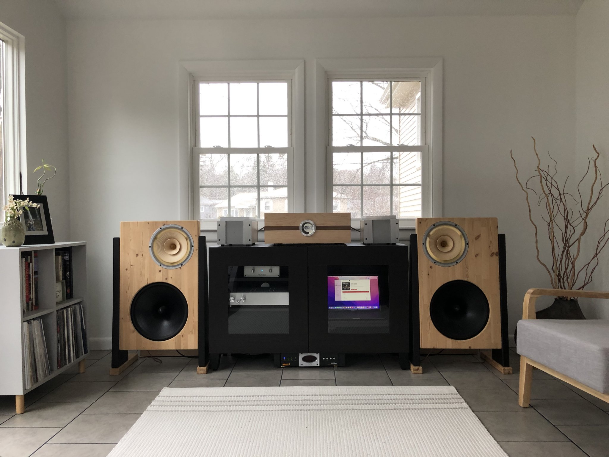

B5 is currently set for a second order 12dB slope at 200Hz for the Sonidos
No baffle step set…haven’t felt compelled to add a shelf filter
Low pass for woofers is set at 160Hz…second order for the low pass
There is a woofer high pass to filter out subsonics with a 6dB bump at 20Hz. A pot appears to allow how much of the bump you want…I have it maxed out.

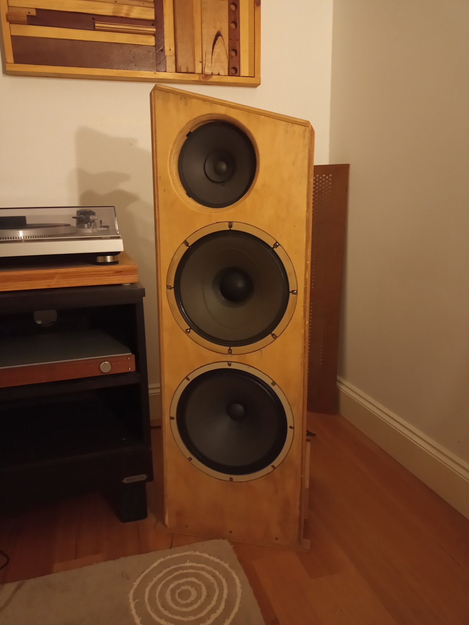

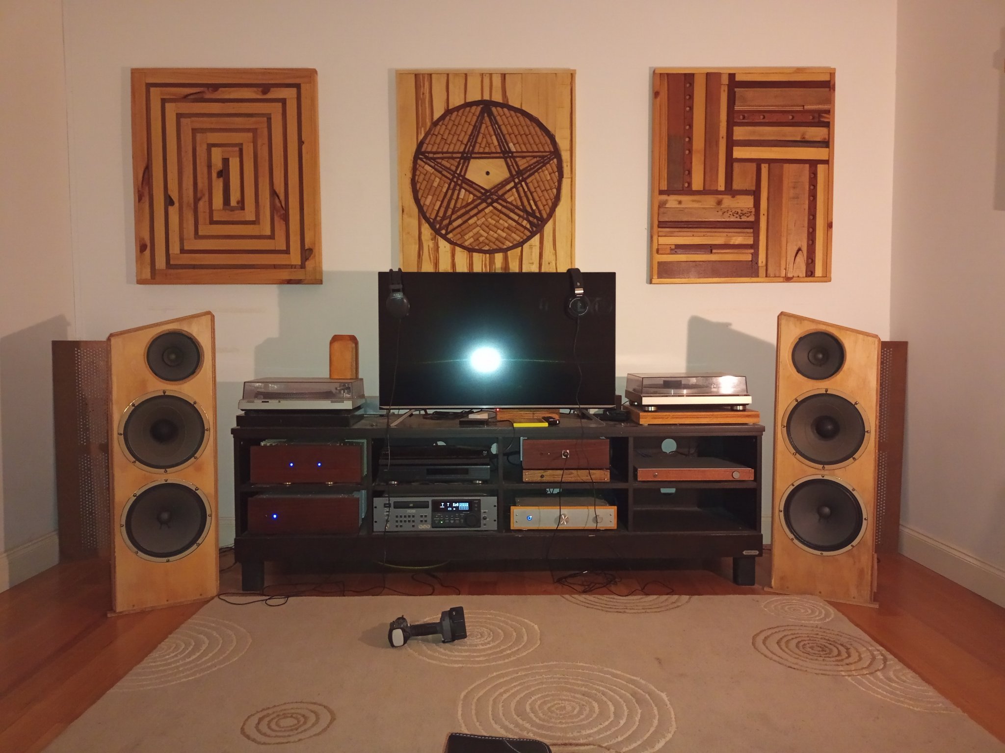

My latest OB speakers, just finished, tweaked a bit and now running...
It's a very frugal project, all drivers are from old Yamaha and Kawai organs, carefully selected and matched for the project.
All the wood is also recycled, reclaimed stuff, even the screws are reclaimed from the old organs.
The wall panels follow the same approach, recycled wood pieces and wine corks.

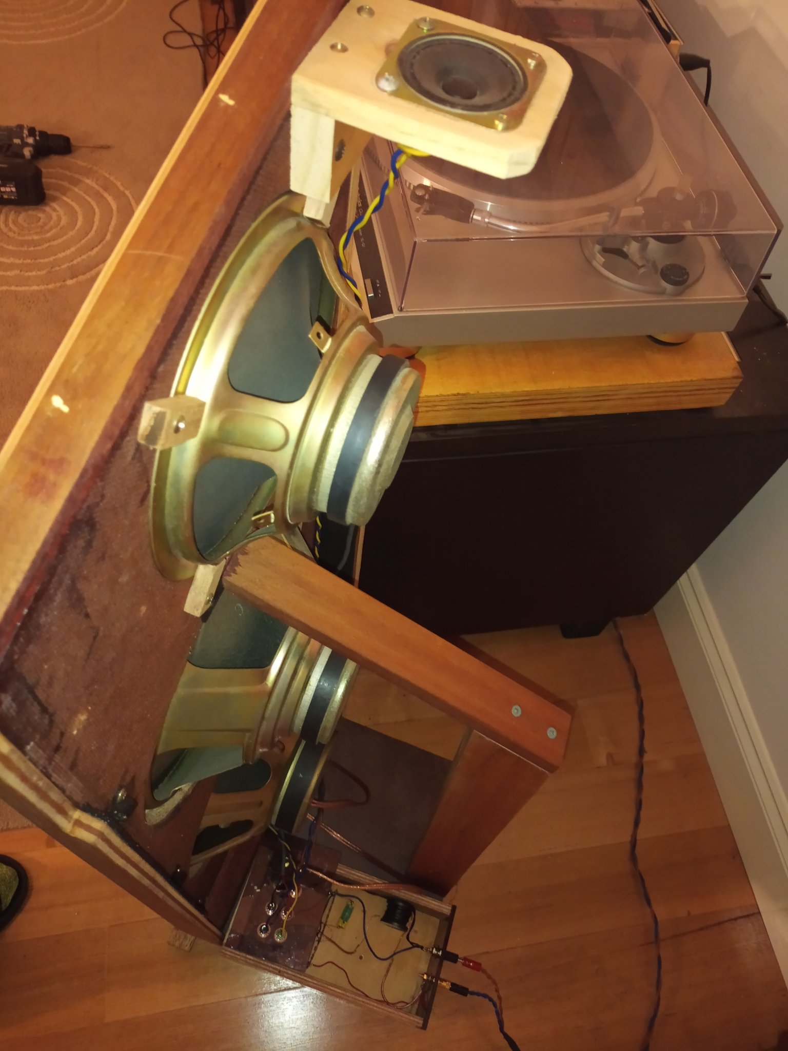

Started as a 2-way with Kawai 30p09, Kawai 20spfn and a Yamaha JA0560 helper tweeter but now added Yamaha JA3063 as a 0.5 woofer.
XO for upper woof and fullrange is a Series one @1kHz, lower woof is fed through a 5mH coil (for roughly 200Hz cut) and the tweet through 1uF cap (for approx. 12kHz cut). All 1st order, no Zobels, no resistors.
Speakers are driven by a 5W ACA amp, thank you Mr. Pass. Driven with aplomb, very effortless open and detailed sound.
Sensitivity is 95 dB.
These are my 5th OB speakers and probably the best so far.
Have plans for at least 2 other OB projects, also have the drivers.

For now, I’ve been playing with positioning in the room. Here is a pic of them shifted out.
I mimic Leon’s positioning map in my room. They’re 8 feet apart, a little over 2 feet off the end wall, minimum of 1 foot off the side walls (spacing slightly asymmetric from left to right due to room dimensions) and toed in so that I am slightly off axis with overlap behind me.
I think this has added some more width and depth to the imaging.
Today I played one of my most familiar childhood albums to see what it was like to ask the system to rock and throw images back and forth in the room…Floyd’s Dark Side of the Moon.
I was impressed. Have I heard more spatial presentations? I think so.
Part of the reason I say that is that this is a wideband Sonido driver. Some of the sparkle and air that defines things is not quite there. I wouldn’t call them deficient by any means…they have an enormously enjoyable balance to them. The flip side to that is no shout apparent at all.
The Sonido’s sound rich and lush in their presentation without being completely dull…which is a welcome experience in this type of driver.
I can probably try playing them a bit more on axis and pic up a little more air in the high frequencies.
My other option…and it is something I want to try either way…is to integrate my Fostex T90A.
For now I want to play them, enjoy listening, tweak the crossover and see if there is any apparent “break in”.
If you have any other specific questions about the Sonido or Lii please ask and I will try and answer.

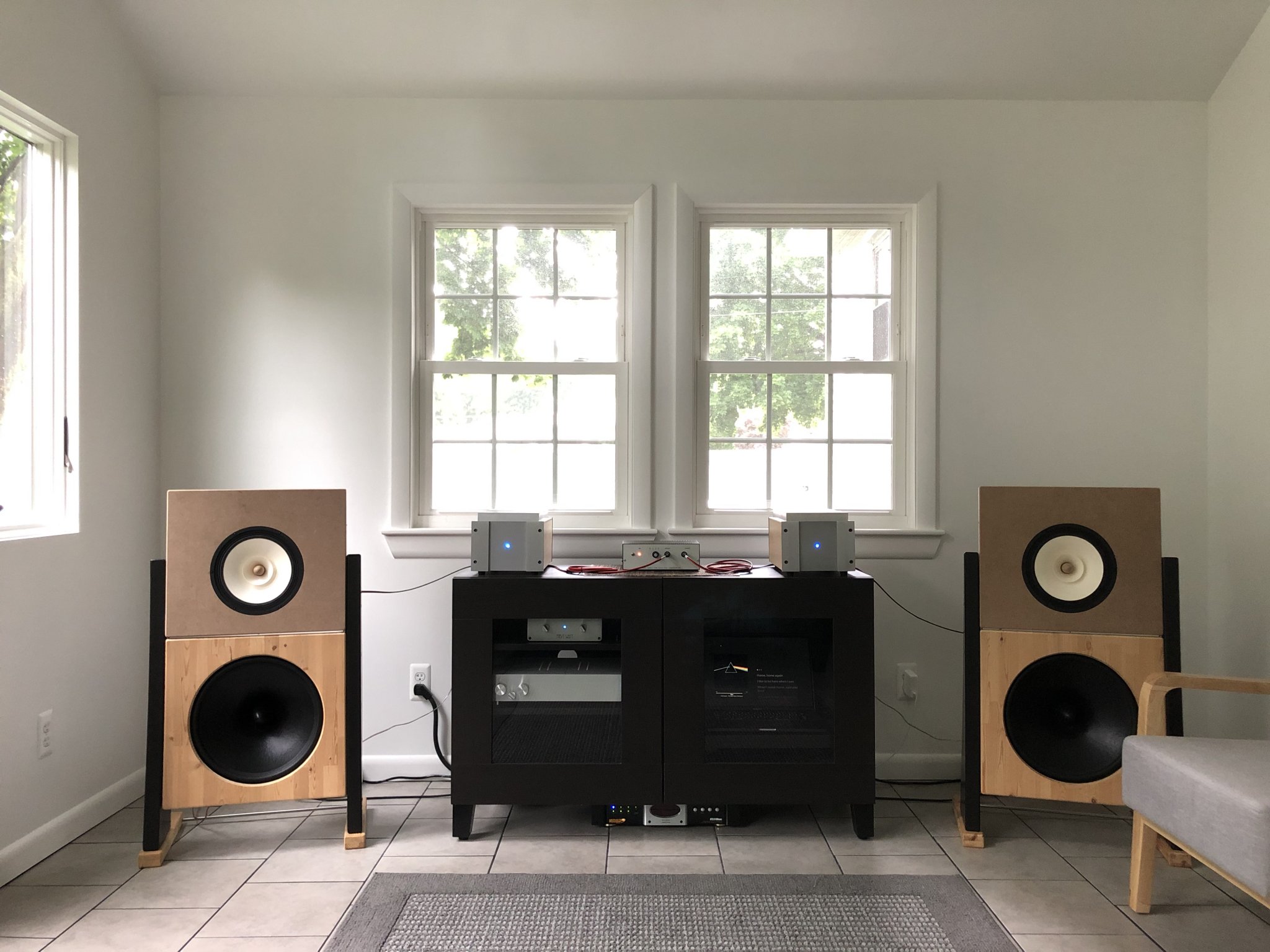

“Dimensions are almost identical. Only difference I maintained was leaving a gap at the bottom of the bass panel as I wanted the option of adding a second pair of slot loaded woofers (like Papa Pass’s 2nd gen SLOB) for use with a variety of other high frequency solutions that will have an even higher sensitivity than the current set up.”
It’s a bit of a long story. These panels were built almost 8 years ago.
To elaborate…the panels were originally made from reclaimed laminated IKEA shelves and old lumber I found put out to the curb…so the dimensions were dictated by that a bit.
Originally the gap was there because I wanted to elevate the full range drivers a bit.
The angle of the panels was shallow and I was trying to get the speakers in line with a 38” listening position height.
As time progressed and I wanted to try different things they changed a bit based on the drivers mounted.
When I mounted the Lii drivers and was looking at Leon’s design I thought about extending the bottom of the baffle to the floor.
Based on my listening, I didn’t feel like I needed it for the design to sound good as far as bass response was concerned.
I had in the back of my mind the desire to eventually try two woofers with a more efficient wideband solution or even coaxial (driver or horn).
Having seen Nelson Pass’ second take on his slot loaded open baffle, I decided to just leave the gap because its dimensions matched a 1/3 Sd slot opening for the AE dipole 18 drivers I had.
My idea for a more compact OB with two woofers was to slot load the lower one.
